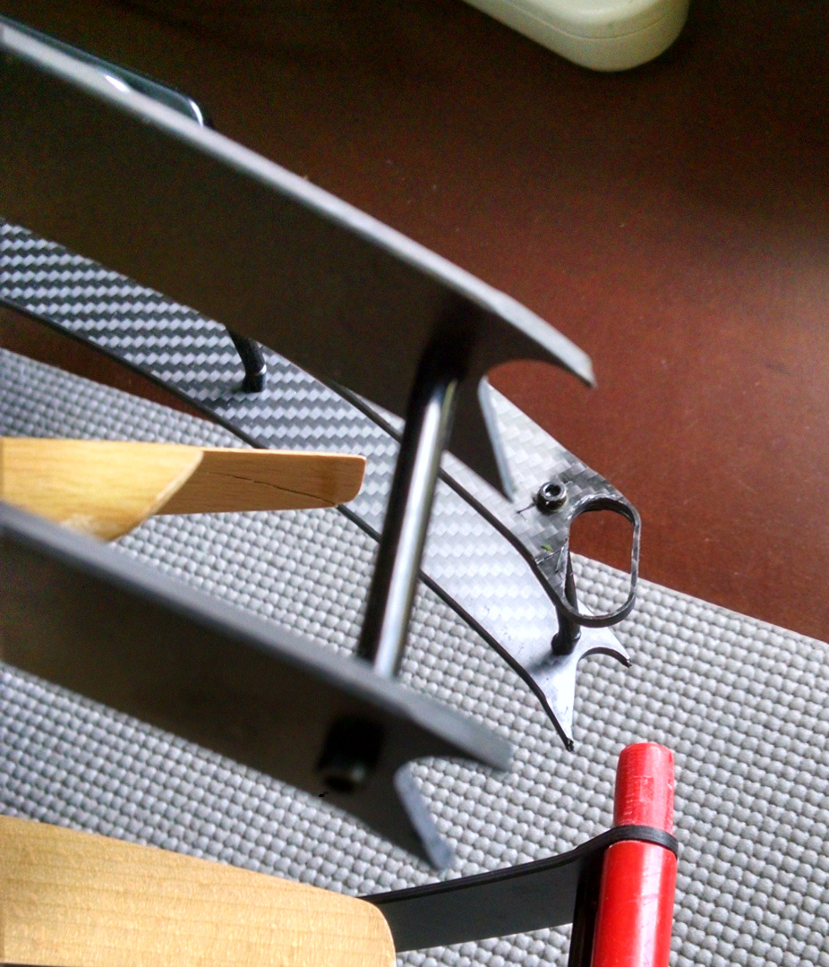

I did have two issues: upon attempting a few bunny hop launch/landings, the hand controller stopped working (blank display, motors beeping in disarmed state, no response to any buttons). And when I took the frame off I noticed one of the props had gotten loose, which is frightening. Wish we could wire on those nuts.

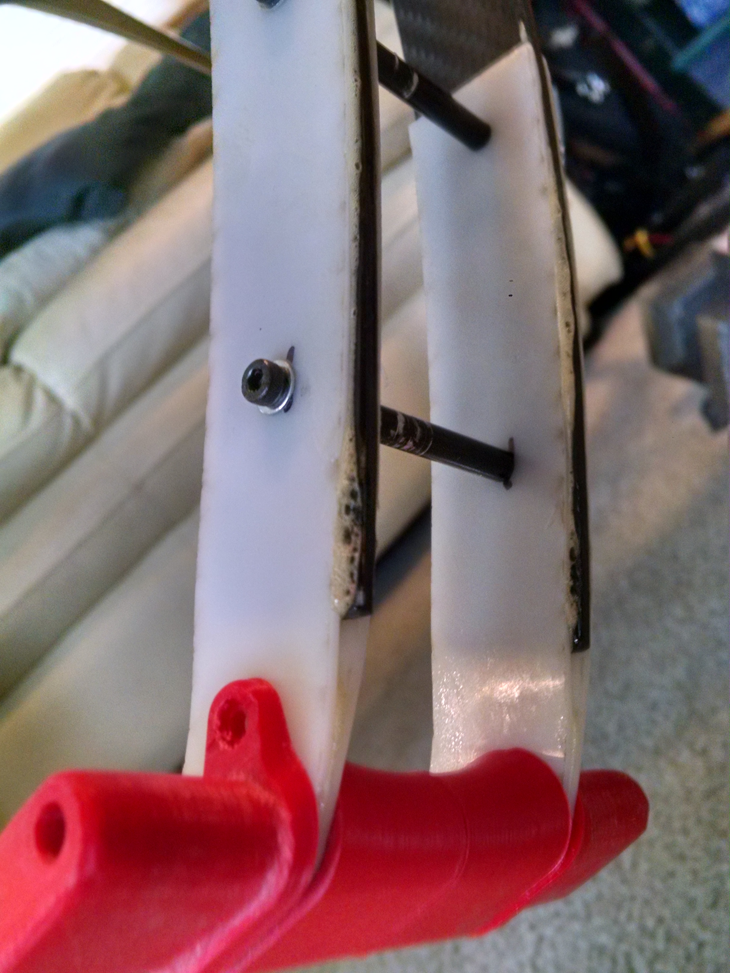

Pics of the repairs to the motor arms. I used 0.062" delrin laser cut in a glowforge, two pieces on each side.

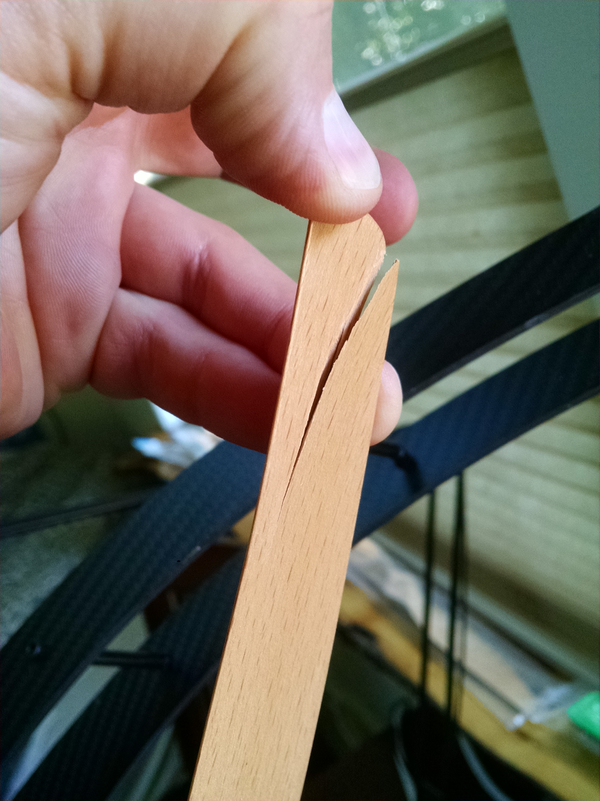

Learning that aviation and frugality dont mix. Old me would have tried to glue this split in the prop. New me invests in buying a new prop.

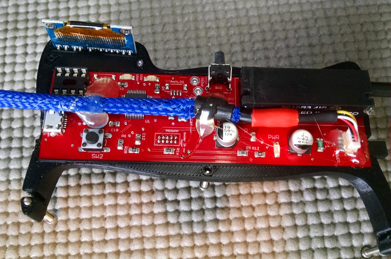

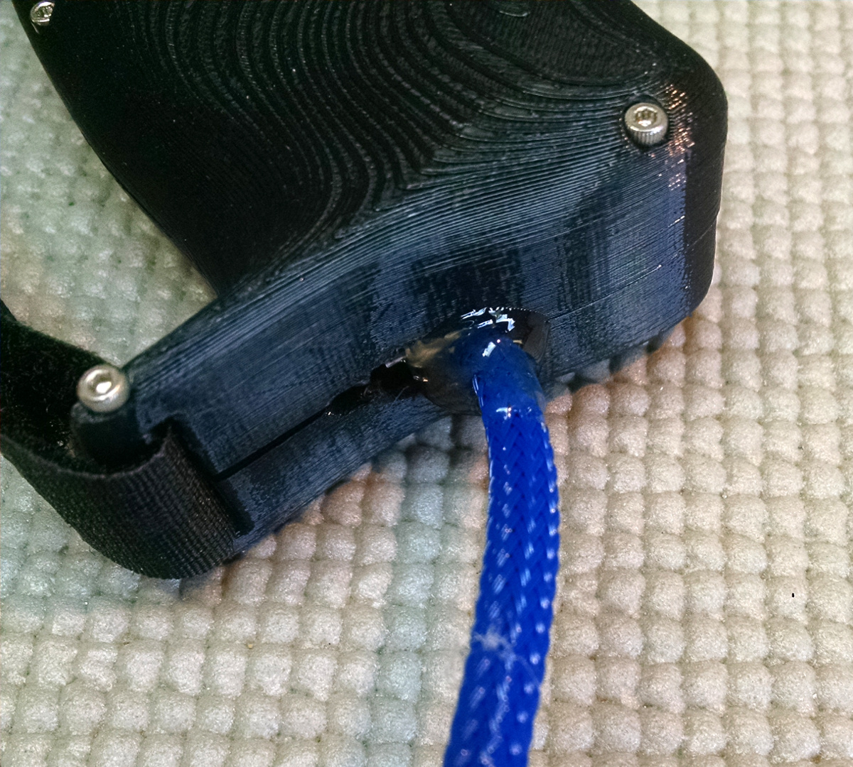

Seeking advice. I added some loom over the throttle cable, but still need a better way of securing the cable to the throttle hand unit. After the first flight, tried to do a subsequent flight but found that the throttle was not responding/had no 5V power/blank display. Upon disassembly it is apparent that a yank on the cable bent and damaged the PCB mount connector, and then fully disconnected.
Is there a better way to secure the cable where it enters the throttle body? Or inline a cable disconnect?
Hot glue for strain relief. Not sure its the best idea, but rolling with it…
