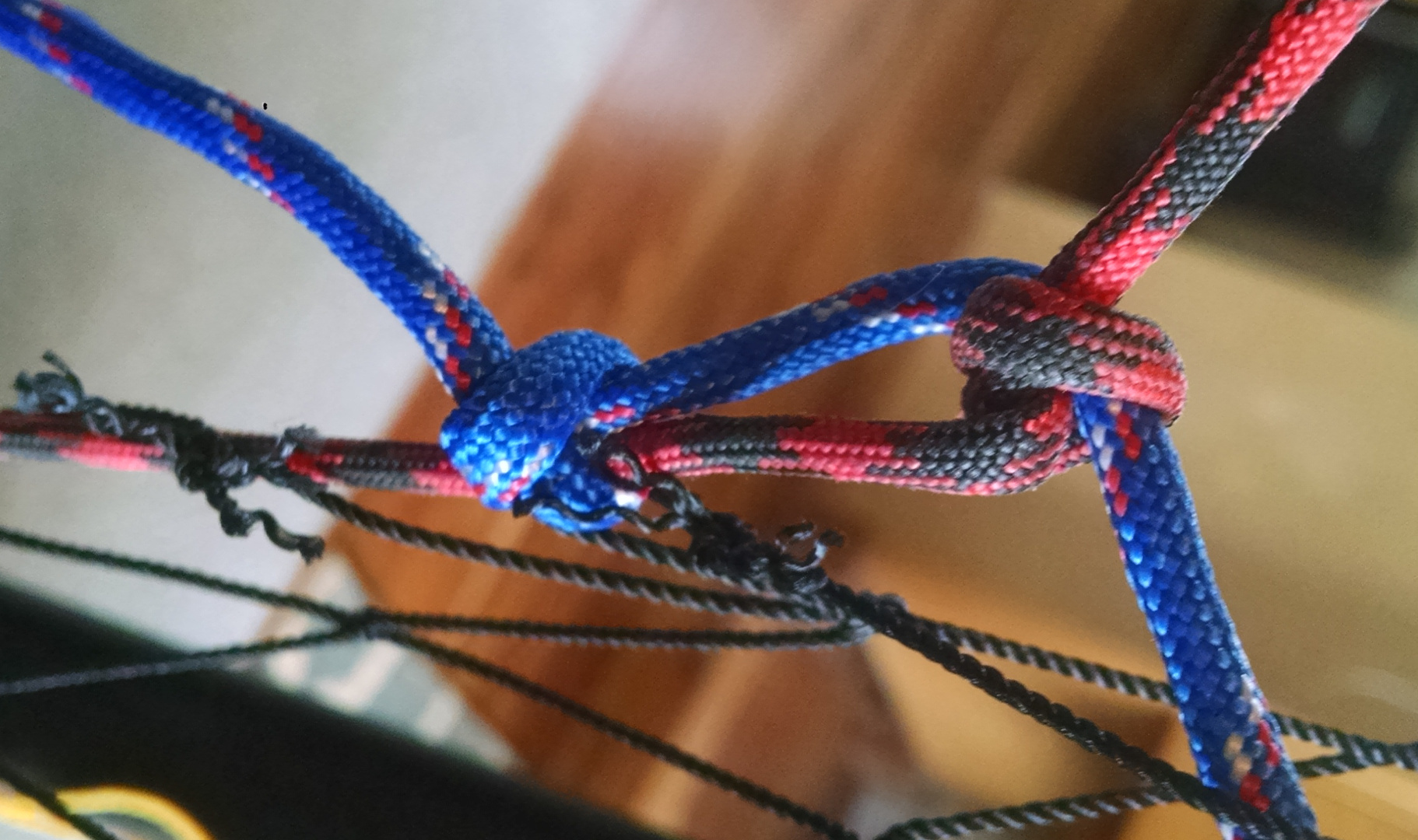

I think you should just re-route the parachord to match mine. Notice how the chord overlaps the bottom arms:
Had to replace the circumferential paracord, since it was too short. Used the eyelets for the hooks. Shortened the two radial lines from 21"to 14". Looks much better and makes sense. Still waiting for replacement props. Amazon.com

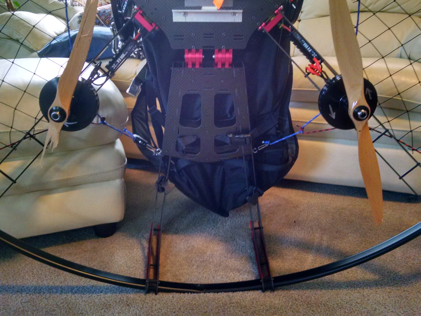

One thought about color. The red anodized parts look really snazzy and the consistent color scheme is stylish. But post impact on the ground, as people were approaching to help, and not knowing the extent of my injuries, it was difficult for me to ask them to turn off the power. I could disarm the system from the throttle, but then its beeping and props are twitching menacingly (good perhaps). But trying to explain where the “red switches” are when all the hinges are red nearby was a challenge on the ground.
I absolutely love that the hinges are not black, the default color for just about everything. But perhaps red should be reserved for safety related items: power disconnects, reserve handles, battery straps…? Maybe the anodized parts could be blue? Just a thought.
What a great thought
Or green, to emphasis the electric eco friendly nature of our endeavor. Or is that just too cliche…

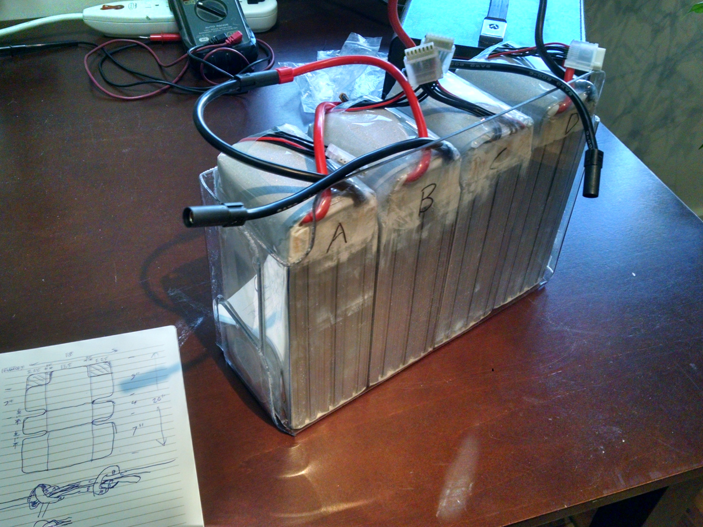

My batteries were undamaged. I did not like the default way of just strapping the batteries to the plate with velcro straps, fearing the corners of the batteries may be damaged and the batteries themselves would get banged up during handling. So I made a lexan box to hold the batteries and protect them, and then strap the box to the backplate. I put an aluminum angle on the backplate to serve as a ledge to support the battery box, and there is adhesive velcro between the box and backplate to help prevent it sliding around. I still want to add some vent holse to the polycarbonate box, but the bottom corners are open and allow some flow now.
Very nice! That box may have saved your life or at least serious burns. I’ve seen lipos punctured from drones crashing only few feet from the ground, they burst into flame.
I built a rubber lined alloy detachable box on mine …works well

The bungee ball cord works for me as it still gives some play while making the net really tight.
Also, the net has a tendency to unravel at the paracord connections but I have been repairing it all along - pretty simple - props stand clear from the blades VOLTAIR UPGRADE BEFORE THE SNOW ARRIVES - YouTube
