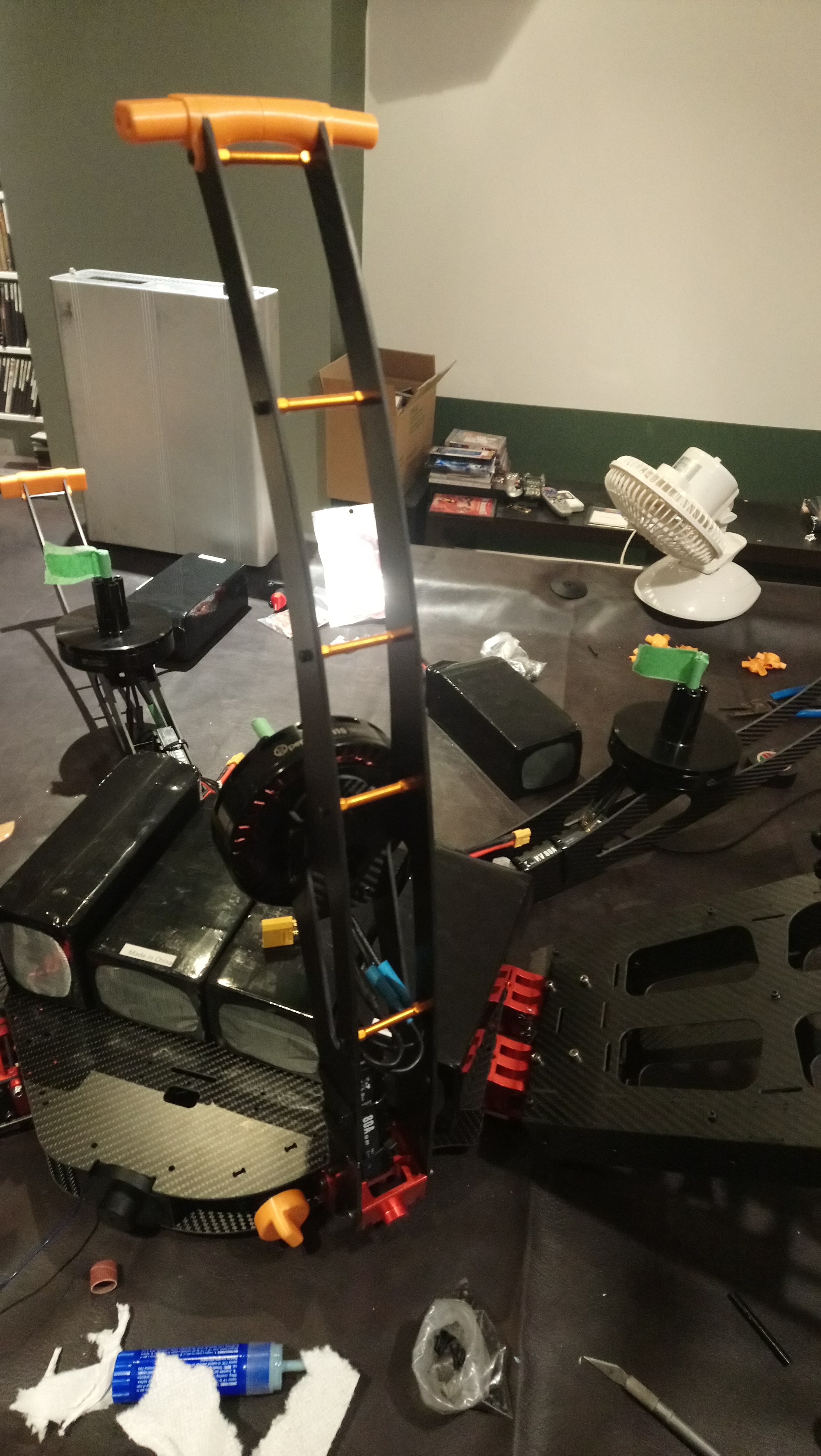

Got my Orange spacers today - got to have some bling, right!
it bugged me too much – had to do it!
Thx for all the safety advice – but I believe the risk was minimal if any at all when all together for flying
How does it feel if you push on the arms? Still just as stiff as before?
What is that clear plastic piece? My props go through both the front and back plate.
I did not do a test where I was stressing arms all that much, just a little while the unit was standing up – felt the same to me.
cheers
Glad you pointed that out – I will redo the layout to accommodate folding - thx
Will copy your design somewhat but using these fuse holders I found as my lug points.
Also trying to figure out a way to have both switches on one side
Are those lug points touching carbon? My understanding is that carbon conducts electricity.
Isolated by rubber pads but I am going to add an extra layer of something.

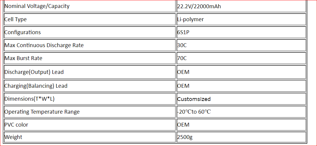

E pusher I bought the same batteries you did at 75% power running on 2 batteries one cell will become damaged. 4 batteries gets you max throttle for about 4 sec, before a cell in each set of parallel batteries gets damaged. Better to only test it with the 6 otherwise I’m expecting the same failure for you.
Are the cells getting damaged or the joints unsoldering? Or both? What is the C rating “supposed to be” on those batteries?
Supposed to be 25c I don’t know I’ll have to open one of the packs to find out. My smart charger says 0v then 5v on each damaged cell and some of the cells next to them.

E-Pusher, do these batteries work better than the Bonkas? Thoughts?
No – dont order them – I have had problems Cells not being seen on 3 of them.
If you open the pack like I did you will se that the cells became detached. The metal strip that connects them was melted like a fuse.
