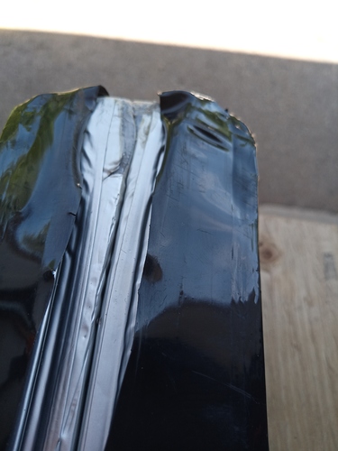

I don’t think I can see that, just poor soldering. And I have not put them through any real load that would have built up enough heat.
Not even sure they were trying with this one, must be working, on a per solder joint qnty per day and if it tested ok they get their money☹️
Two bats re-soldered and now no errors from the charger. Waiting on some Kapton tape to close them back up I think I will only run these batteries at 80% load.
thats what they look like under the wrapping?
