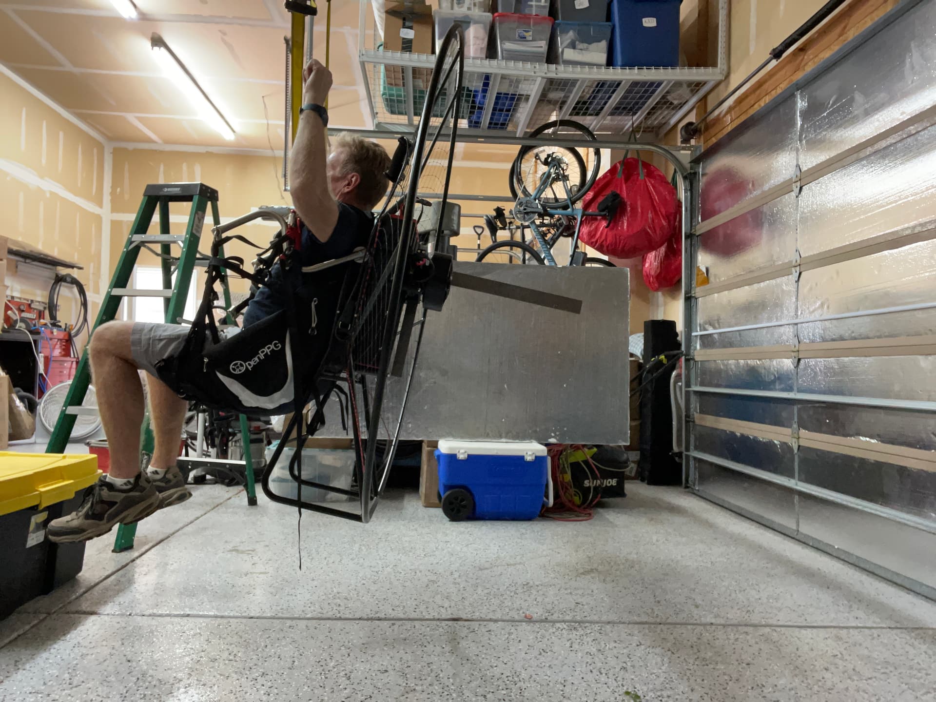

Hey. Here is a photo of my e-motor hung using the factory default hang points. The prop is not attached and the reserve is wedged in between some of the harness straps (didn’t get my container with my shipments). I temporarily attached a framing square to the motor mounting plate so I could get a good visual of the thrust angle. The bottom edge of the square is lined up with the motor axis. Then I positioned a horizontal pole and leveled it. The hard part was getting it positioned such that the two reference lines converged at the end of the motor output shaft. Now I need to import this photo into my CAD software and find out what the angle is. You seasoned pilots (I’m not saying “old”!) can probably guess pretty accurately just by looking! I’ll be reviewing this thread in an effort to pickup on useful info.

From a picture like this if you have an iPhone there is a straighten photo option which will tell you how far the photo is being rotated and it has a grid to line things up. I rotated your photo 24 degrees to make the square level:
You need to move the collars back as far as possible and test again. When my static hang angle is 15 degrees my angle with level flight is about 10 degrees. Also realize the time where this matters the most is during takeoff and at that time you should be hanging by your leg straps which makes the recline even less.
Jeez! I had no idea that feature was part of Camera! I measured 26.5 degrees with my CAD program and 24 degrees with my phone, so pretty close but 2.5 degrees (if CAD results are truer) can’t be ignored. But I too am a newbie so maybe that delta isn’t something to get too anxious about?

2.5 degrees is insignificant when you aren’t even in the ballpark to begin with. You need to target less than 15 degrees. 24 degrees is too much recline and so is 26.5 degrees. The camera angle alone could throw this off so just measure the angle directly with the level app if you can.

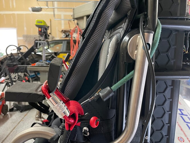

Thanks guys, makes total sense. I moved the collars and tried both soft link positions; straddled and behind. Neither produced any significant differences, and I too experienced the soft link spin to the outside. I did some experimenting and came up with the arrangement pictured below. Basically I created a force vector that pulls the soft link towards the back. The setup is: moved the collars, straddled the soft links around the collars, added links from the soft links to the frame near the arm pivot point. This arrangement took the angle from 24 to 11 degrees. When I stretch my legs out the angle is 7 degrees. There’s an obvious gotcha, in that the links run across the space where my arms are. Not ideal, but it’s an effective solution. The links don’t restrict the movement of the arms. Another negative aspect is that the links are forces that want to buckle the arms at the bends. This is extremely stated and probably wouldn’t be an issue. I’d love everyone’s $0.02.

I had my wife use the level app parallel to the motor as I sat in the harness. Is there a way to do it alone?

Well, I was able to achieve 13 degrees but the collars are waaaay back. I assume others had to go to this extreme and that it’s safe to fly this way. I’m a bit concerned about the collars being on the bend and not tightening down the way they were designed to.
I’ve seen a few posts about static vs powered hang angle and I think those are worth considering. This was my attachment on flight #4 after much tinkering using some of the suggestions on this forum (for reference, I’m 150 lb with the 4kWh battery). On the ground the hang angle was about the same as yours. However, at climb power my cage tilted so far forward that my right brake lines were touching the cage – spooky to say the least. Upon review, I suspect that in my effort to move the hang points further back, I actually just moved them lower resulting in a wing attachment point below the thrust line. All this to say, from your picture it looks like your hang points are even lower than mine and a powered hang test might be worth trying. Another thing that I noticed was that the torque steer effect was very strong and I suspect that by not having the hang points near the bend in the bar where the offset is most pronounced, you lose a lot of the torque compensation. Unfortunately, I don’t have an answer to your problem (which I share) quite yet, but these are just some things I’ve been thinking about in my tinkering. Hopefully we figure out something soon; I’d really love to get out of the tinkering phase and on to the flying phase before summer is over!
