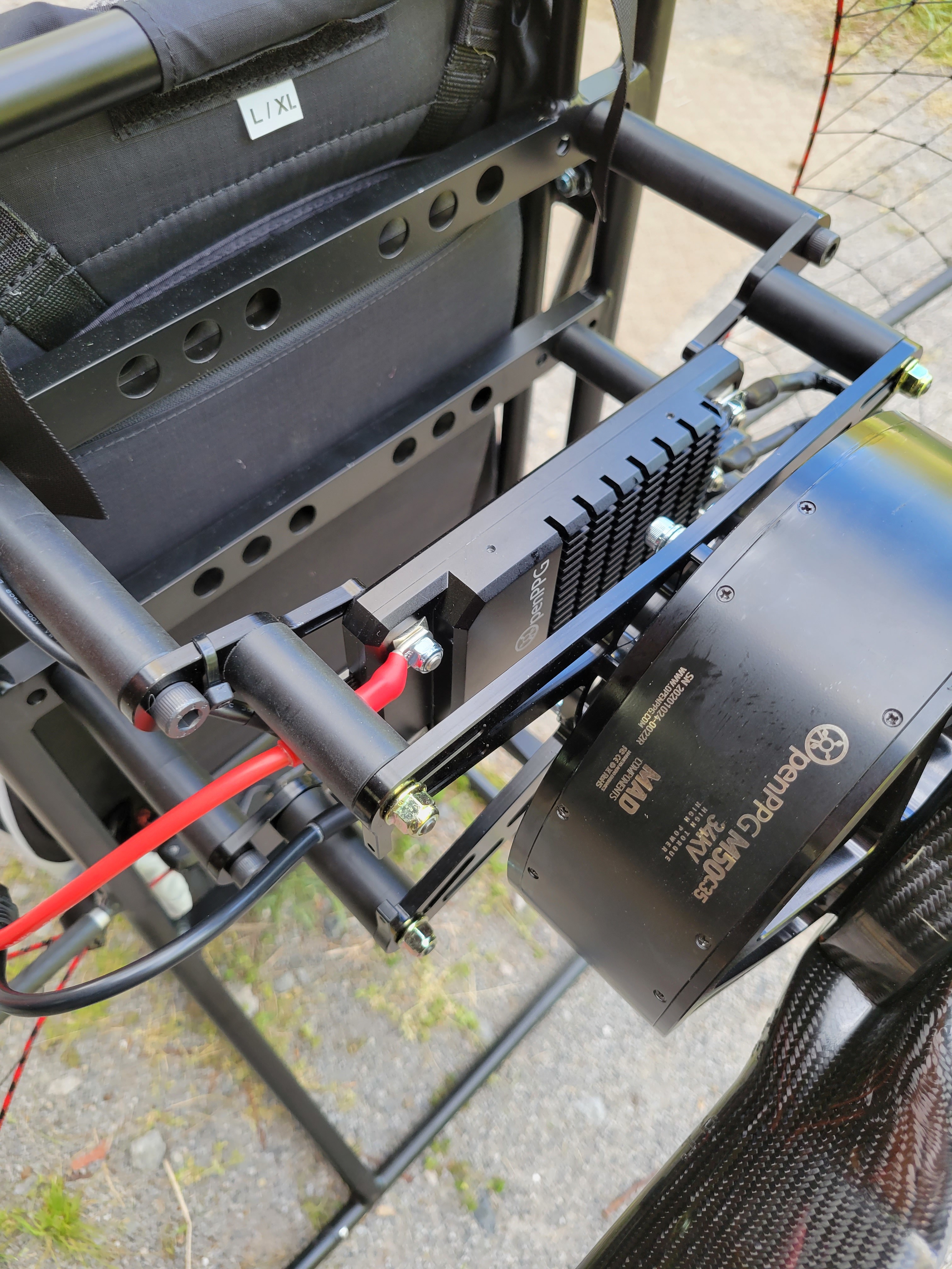

Also let me know what specific things you guys want to see up close and when we take a break I can try to add some more pics and info to a new thread.
Obviously we’ll be working on some marketing videos etc too but not till later.
Maybe how the motor mounts to the ESC bracket and how the ESC bracket mounts to the frame…but really, anything y’all want to post. Thanks!

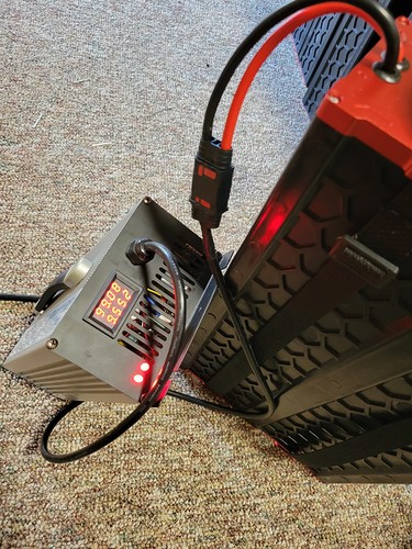

Here’s a close up of the charger
You can see it’s outputting close to 10amps and is currently at 99v. Its smart enough to control the amperage and voltage simultaneously to make sure to supply a healthy charge.
For those in regions that use 240v outlets we have a version for you too!
