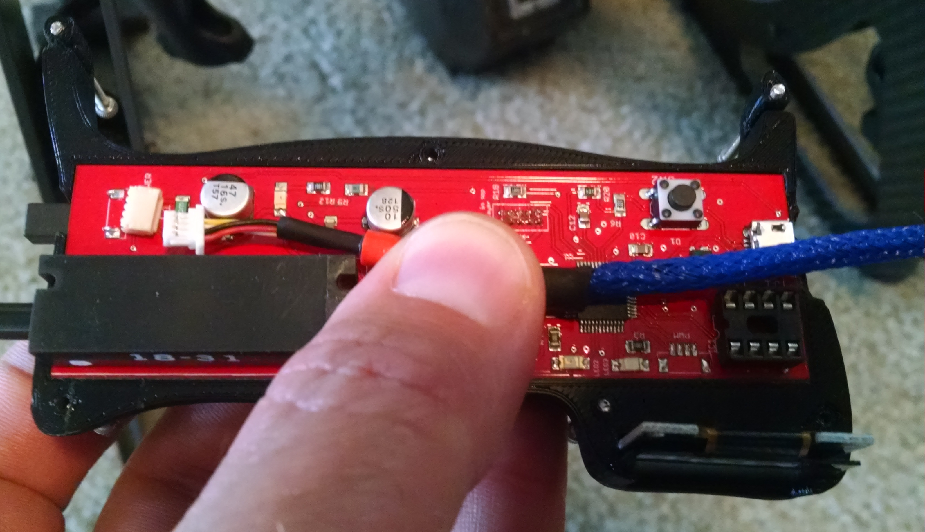

Seeking advice. I added some loom over the throttle cable, but still need a better way of securing the cable to the throttle hand unit. After the first flight, tried to do a subsequent flight but found that the throttle was not responding/had no 5V power/blank display. Upon disassembly it is apparent that a yank on the cable bent and damaged the PCB mount connector, and then fully disconnected.
Is there a better way to secure the cable where it enters the throttle body? Or inline a cable disconnect?
I tried hot glue on my also, but I ended up just reprinting the handle and making the hole smaller so it pinches tighter on the cable.
I think You could use zip ties to the backplate. Either through some of the holes or to a stand off. And then make a loop and zip tie again that way if you do yank and it pulls through the zip tie it just shortens the loop. I think that’s what I saw glider pilot use in his.
Yeah, I zip tied to the carbon plate. But as for the controller side I have batch 2 and the wires fit tight through the hole.
I tied a know right before where the cable exits the case:
