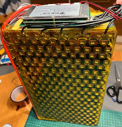

Here is my swap to ant bms 300A
There is a Tiny gap due to thickness of new bms. I believe we had a guy here doing the same and he 3d printed out a standoff for this, cannot find it now…would be nice to get the model and print out the same.

Modified the bms by shortening spacers 2.5mm, thus making the whole ANT slimmer. Now the lid closes without any gaps and looks like stock.

All works great after a few flights. Although I have one group(nr5) drifting a lot so it does not let me make longer flights. Have to fix this with new cells. I also want to change to bigger wires as 8AWG is too wimpy even for 160A currents in chill mode. But dont see a way now as it is really cramped in the case.
My settings are that BMS will cut out when a cell reach 2,5V or 60V on pack level.
If want a warning, the ESC have these settings in software. So you can set that it lowers the power after a given voltage.
