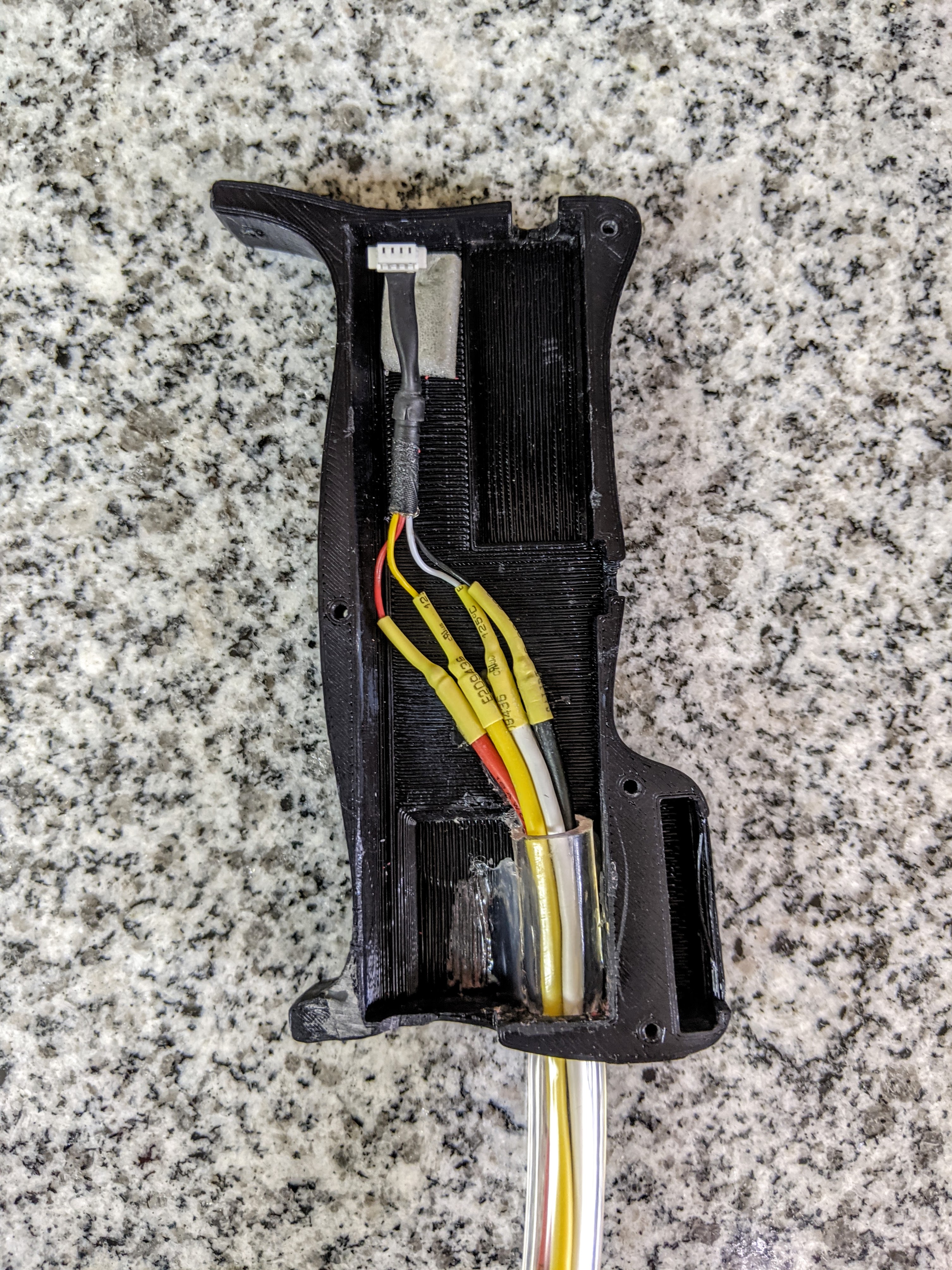

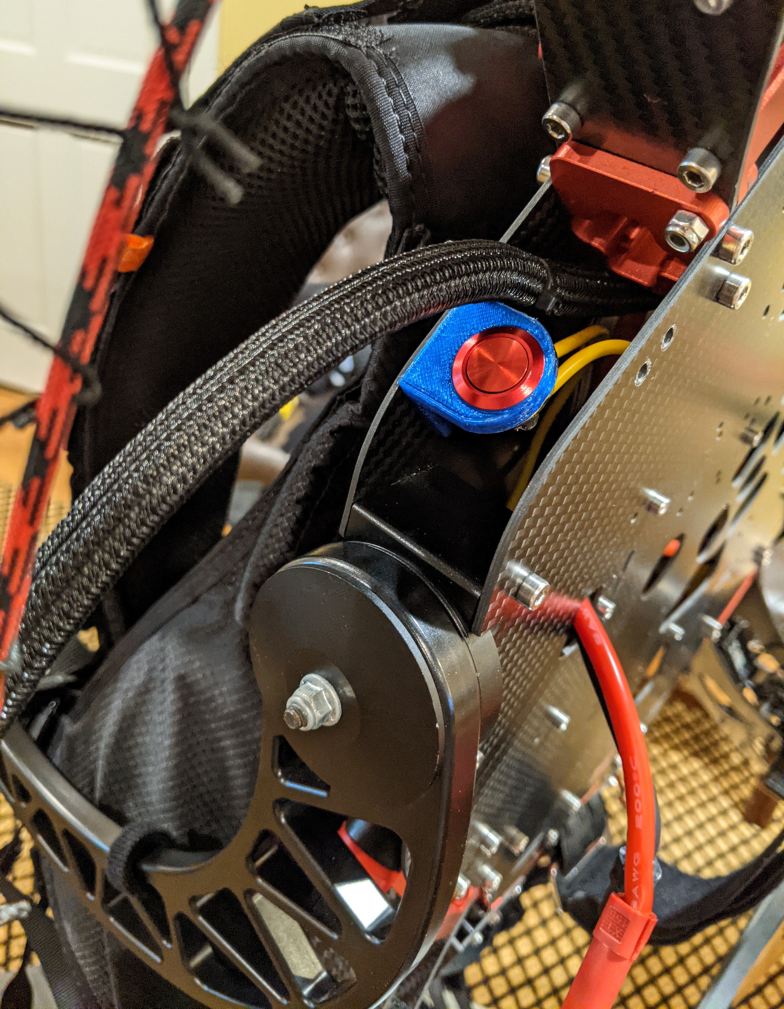

The new throttle cable cable that I built in October for my batch 3 failed again a few weeks ago. :slightly_frowning_face: The #24 silicone wire was separating inside the silicone insulation. For the new cable I used #18 silicone wire which has about 150 strands instead of 40 in the #24. Also, I ran the wire through the inside of some 1/4" I.D. vinyl tubing that doesn’t tend to kink. Metal shielding fabric tape went around the tubing and wire loom over that. Since the assembly is much stiffer than the previous one (it is similar to the one on my Tornado 280 now), I had to re-route it and move my pre-charge switch over a bit. It all tested fine, and I’ve got my fingers crossed that the wire will last longer than the previous batch. It is not cool when all/some or none of your motors work when it is armed or when it disarms on its own!! :open_mouth: Here are a few pictures of the new assemble:
I will let you know how this new arrangement holds up.
