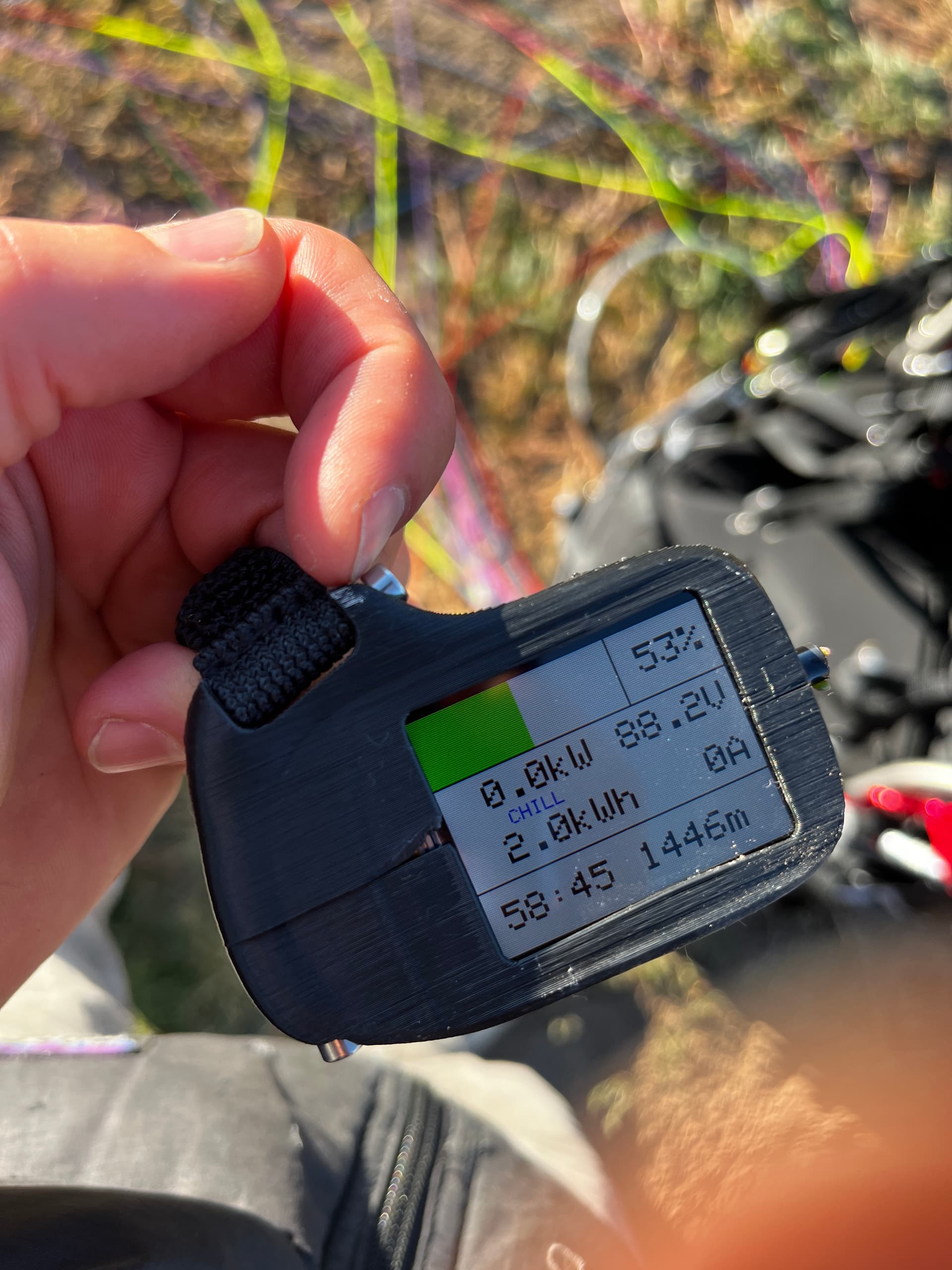

Second flight with SP140:
1 Hour 45 minute flight ended with 53% battery with the help of ridge soaring, thermals, and lift lines. Flying a Sirrocco 3 24, with reserve, 4kW battery charged to 98%, and I weigh 145 lbs. The potential for some interesting cross country with this thing has me thinking.

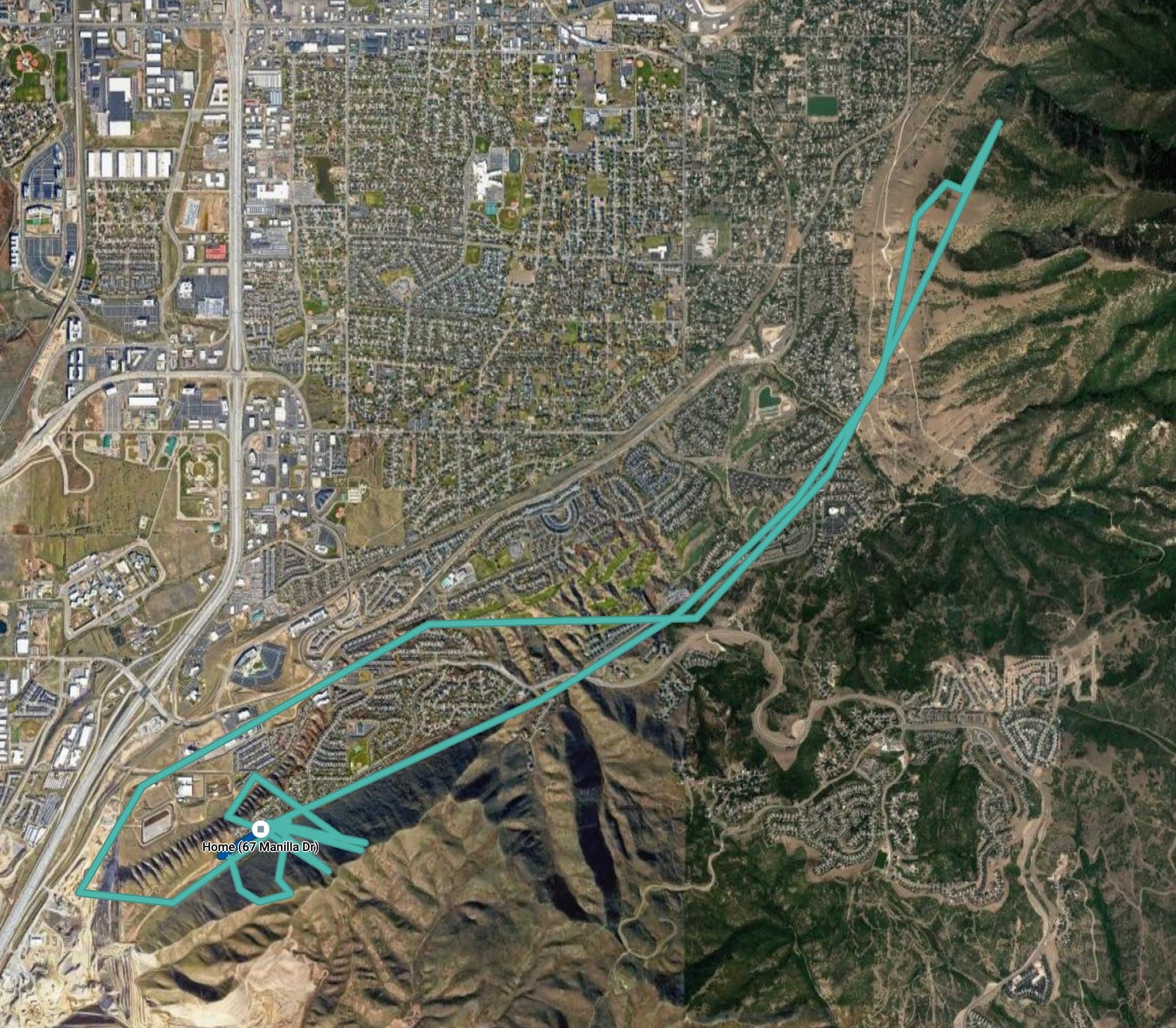

The time is wrong on the controller, I disarmed mid flight to mess with the toggle/throttle positioning, so it reset. My Gaggle track failed to start on launch for some reason, so I had to fall back on the ever-tracking Google Timeline for proof of where I went. It doesn’t show all the thermaling and soaring but the overall track is there. (duplicated from Facebook post)
Nice flight.
So for cross country, would your strategy be to catch thermals to gain some elevation, use that to glide for a long time without the motor, and then find another thermal and repeat?
Thanks! I could have pushed it way farther but I was being super conservative since I’m new to this setup. I easily could have gone to the mountain peak… maybe today…
Dunno! That’s why it has me thinking … what would be the optimal way to do it. Would it be better to motor up without thermals and stay high on thermals, or get high using thermals and use motor to extend glides between thermals, or only use motor for preventing land outs, or use very low throttle and just aid in both climb and glide. Interesting new dimension to XC I hadn’t thought about!

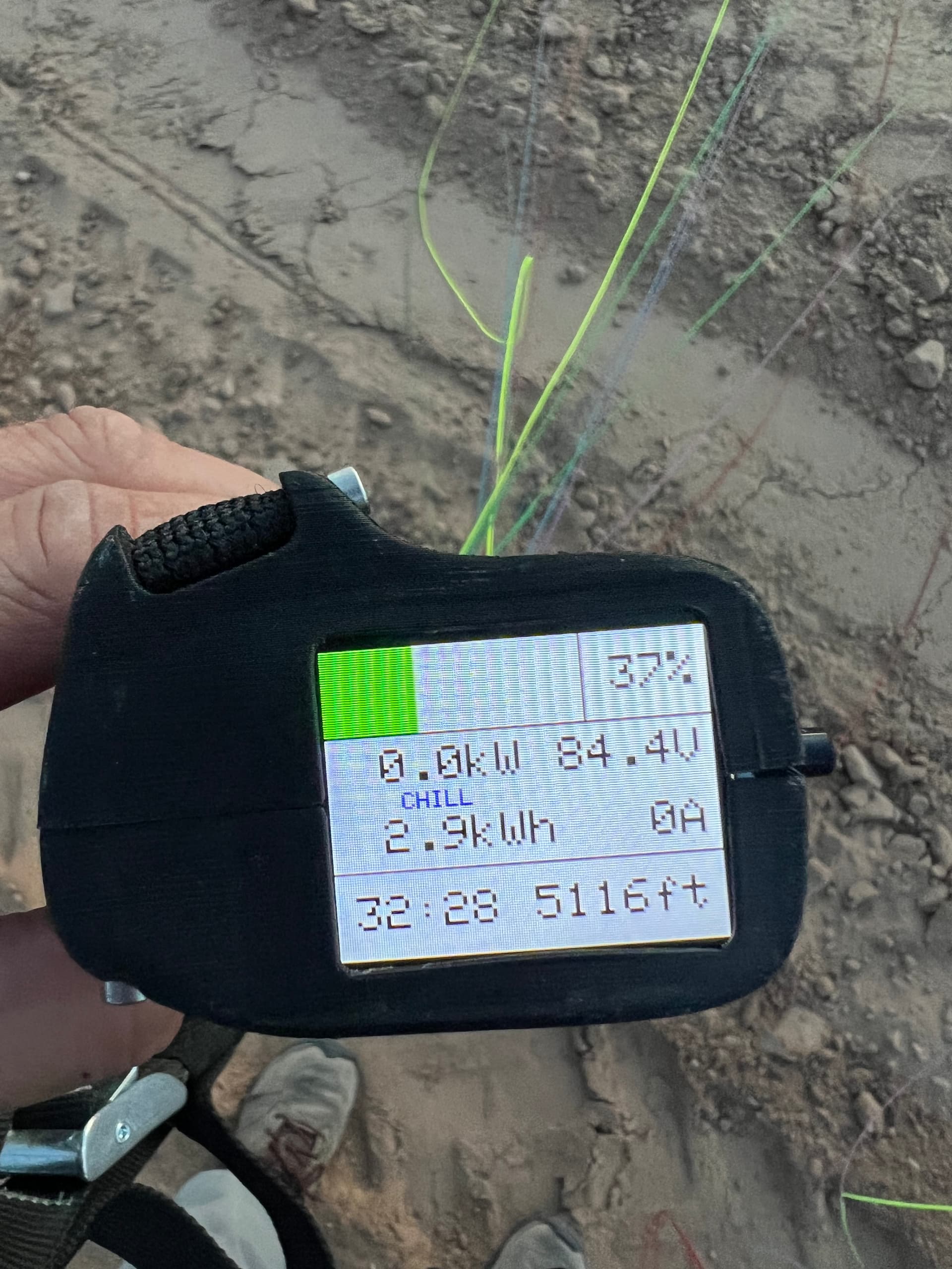

last flight was ~42minutes. Voltage sag down to 37% with 6-7kw for my go around.
I would say 50minute is easily achievable with newer battery.
As the battery ages, you’ll get less flight time, so probably looking at voltage would be best. I’m figuring out when a good time to land would be with good reserve for go arounds? cut off is 72v, so breaking 80v seems reasonable to account for voltage sag under go around.
