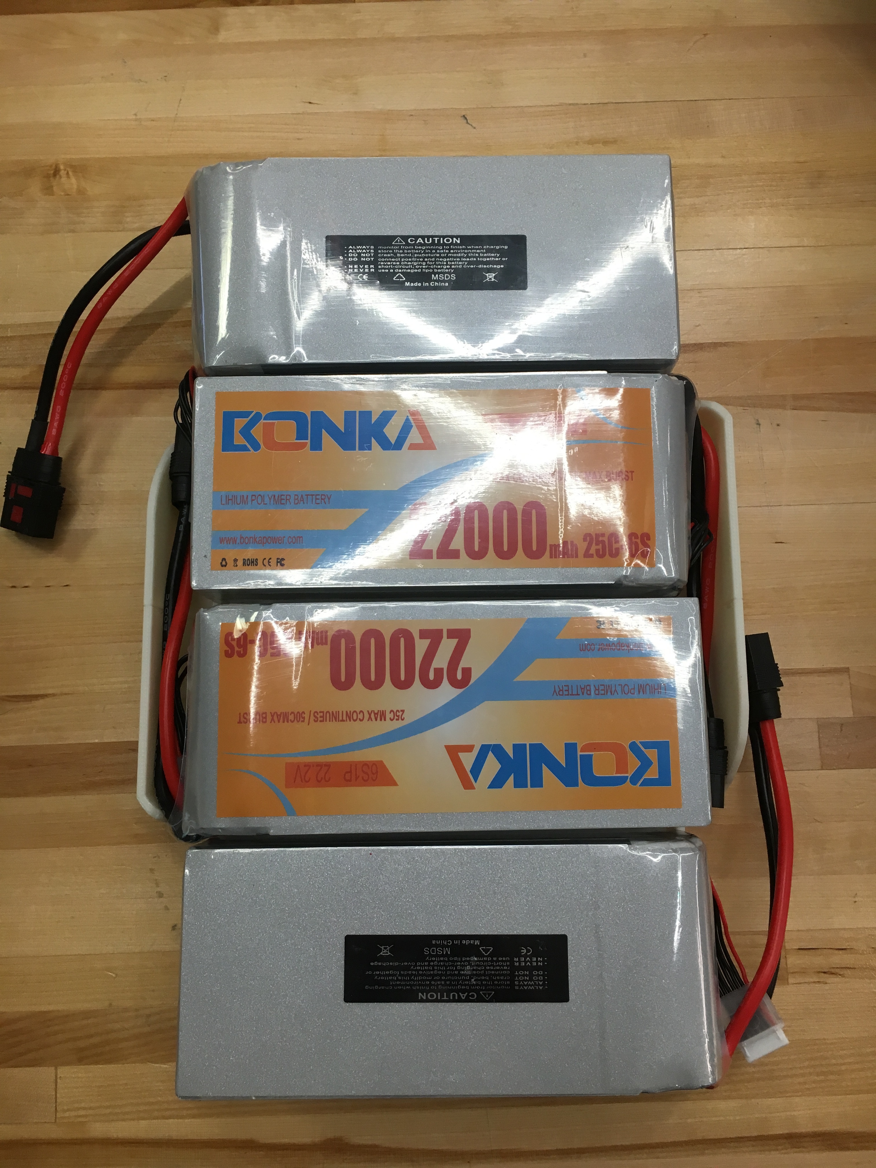

Here you go…
Very nice, i’m also getting 3d printer envy. E-Pusher you could easily build your own carbon fibre or fibreglass case, just make a block of foam same size as batteries for the plug.
This is true - but I have back log of projects that will keep me going this winter - this is why I went with buying the kit instead of making my own - just too many things started, get stalled and they build up.
Too big ones, dump trailer and small camper. Also want to build a small tractor wheelbarrow, trailer mover like the Parkit 360 – this winter is being deemed Mission “Project Catch Up”. Hopefully I will have time to put my motor together.
Cheers, Patrick
Any emergency quick release system in this battery case?
Think you can build a case that can hold 8 bonkas?
No quick release. The connectors (OSE 8.0mm Anti Spark connector) I used wouldn’t accommodate such.
How are you looking to hold them? I had to do two prints for this and glue it together.
Any reason you chose to use different connectors than what came with the Bonkas?
I want to make an 8 battery setup… just haven’t figured out the best configuration yet. I’m still waiting on my unit from batch 3, so I don’t have it yet.
They were anti-spark connectors and were big enough to accommodate 8awg wire. I used 8awd as much as I could. It meant I had to replac the connectors on my charger.

@grassyellow do you have insulation between your bus bars and the carbon? Carbon conducts electricity.
Yes the bus bars are mounted on a block of polycarbonate
