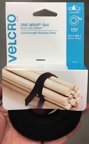

Hi Gliderpilot, where did you get those Velcro straps you used for attaching the batteries? I can’t seem to find any in that width. Thanks!
They have them at Walmart, Ace Hard, Home Depot, and others.
