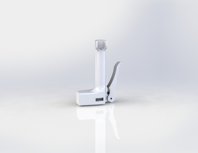

After two flights I’ve come to the conclusion that I like the old school throttle that I’m used to using. So, after making a wood prototype, then modeling it in SolidWorks this is my prototype 3D print. Waiting on electronic parts to complete the prototype and produce a finished product.

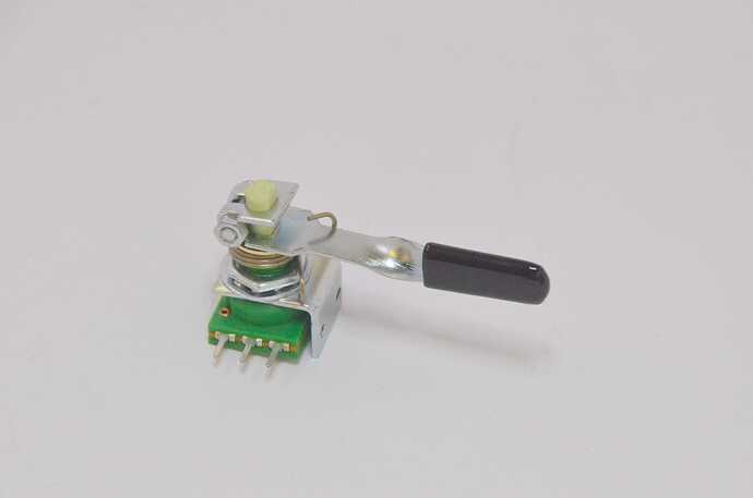

How are you going to measure the throttle position?
I am interested because I have made 2 prototypes of my own so far
I’m will be using the same internal components from the OpenPPG throttle. I’m just adapting them to this frame.

Very interesting and nicely designed – I look forward to seeing how it turns out with all the guts transferred over.

Robs’ old school throttle will give the community an option.

Good job on the traditional design, by the way! I think it’s great to have options. Specially for those who are used to the traditional. So yeah, keep the options.
