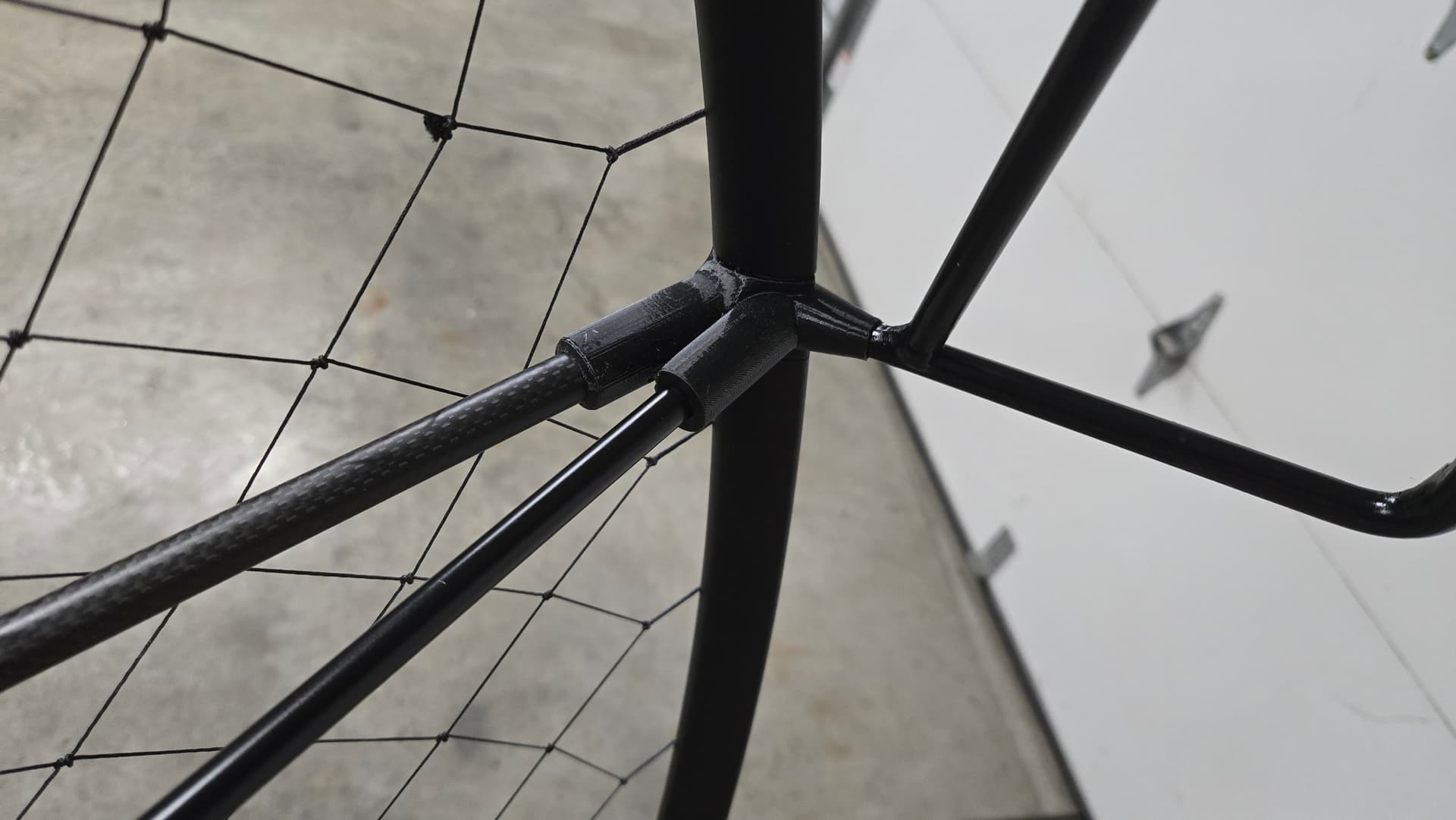

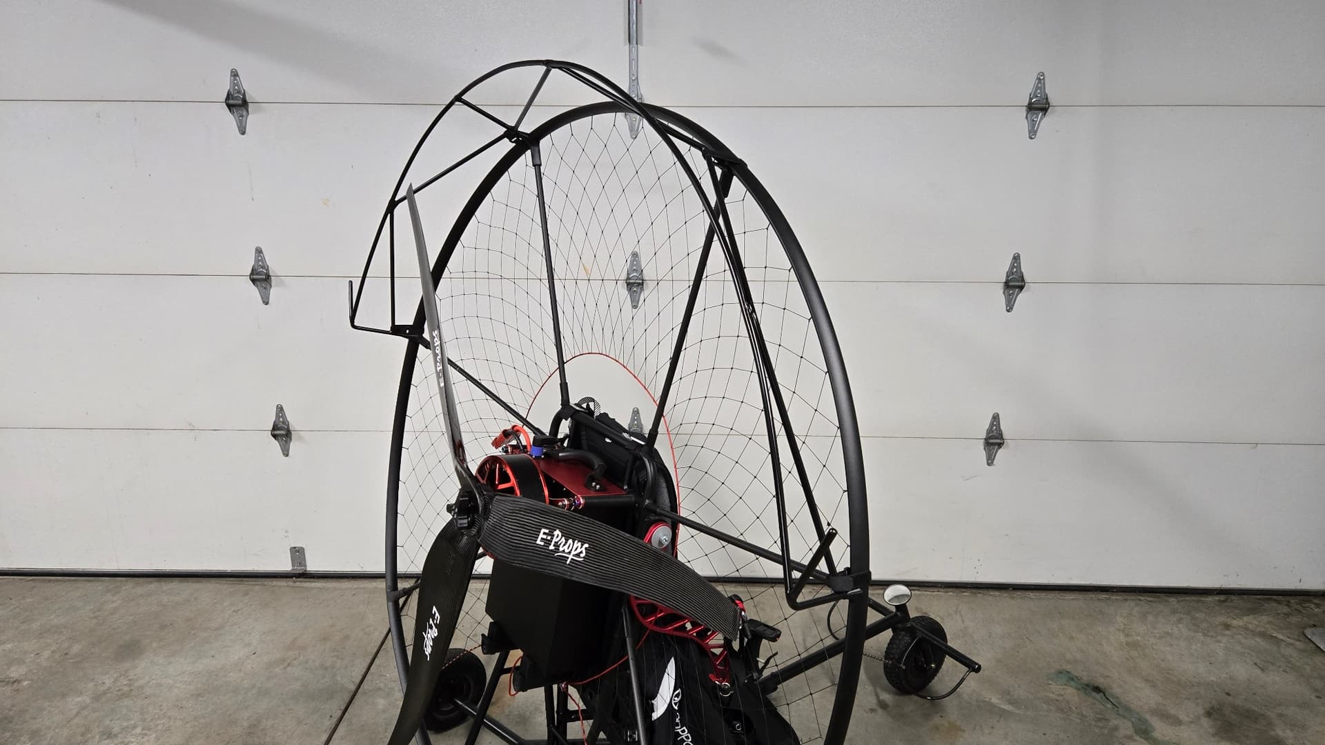

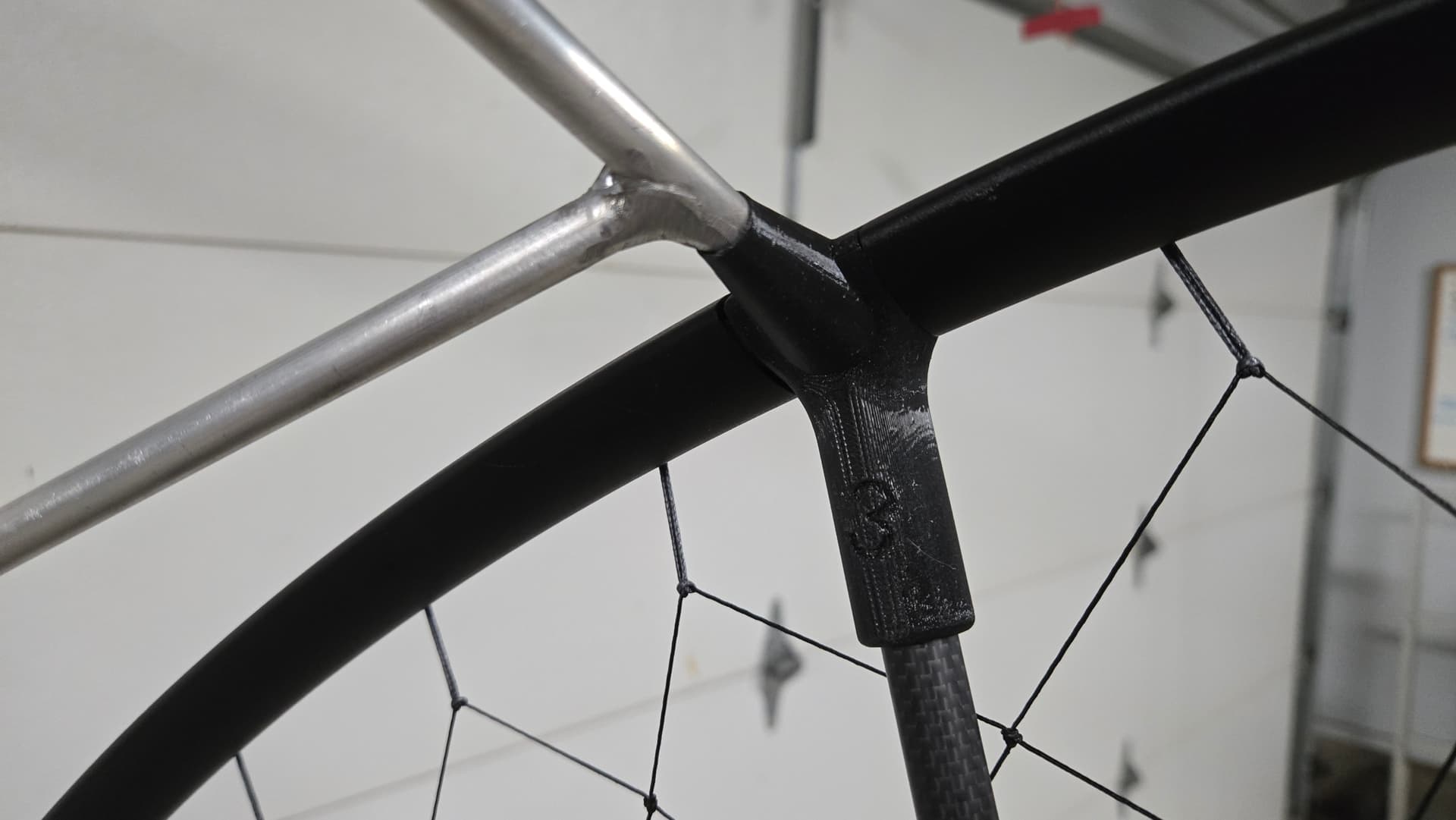

Just finished a cage extension for using with the trike, I reprinted cage connectors with sockets for attaching. I will test with the glider unpowered in a breeze to check for flexing before power flight. I’ve made similar extensions for other motors and this keeps lines out of the prop plus strengthens the cage a bit.
Added a bit more cross bracing and painted black.

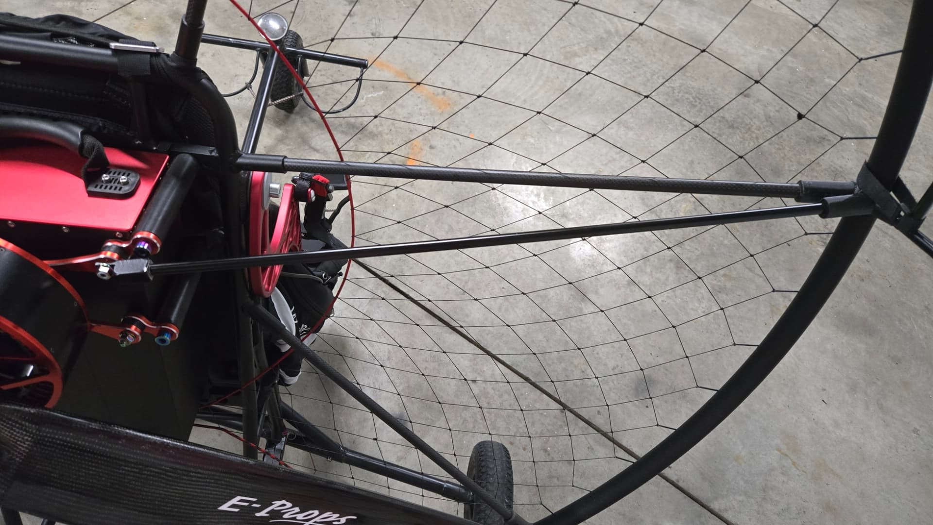

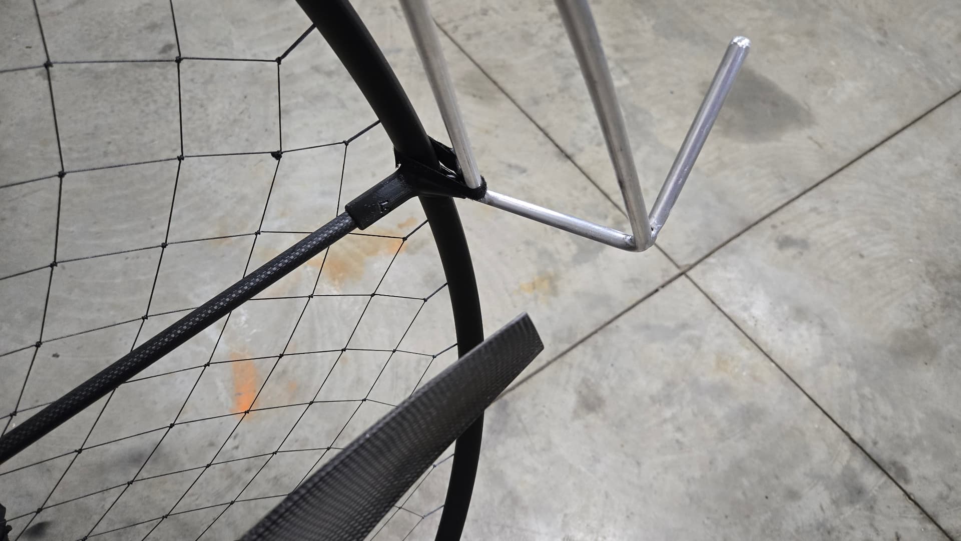

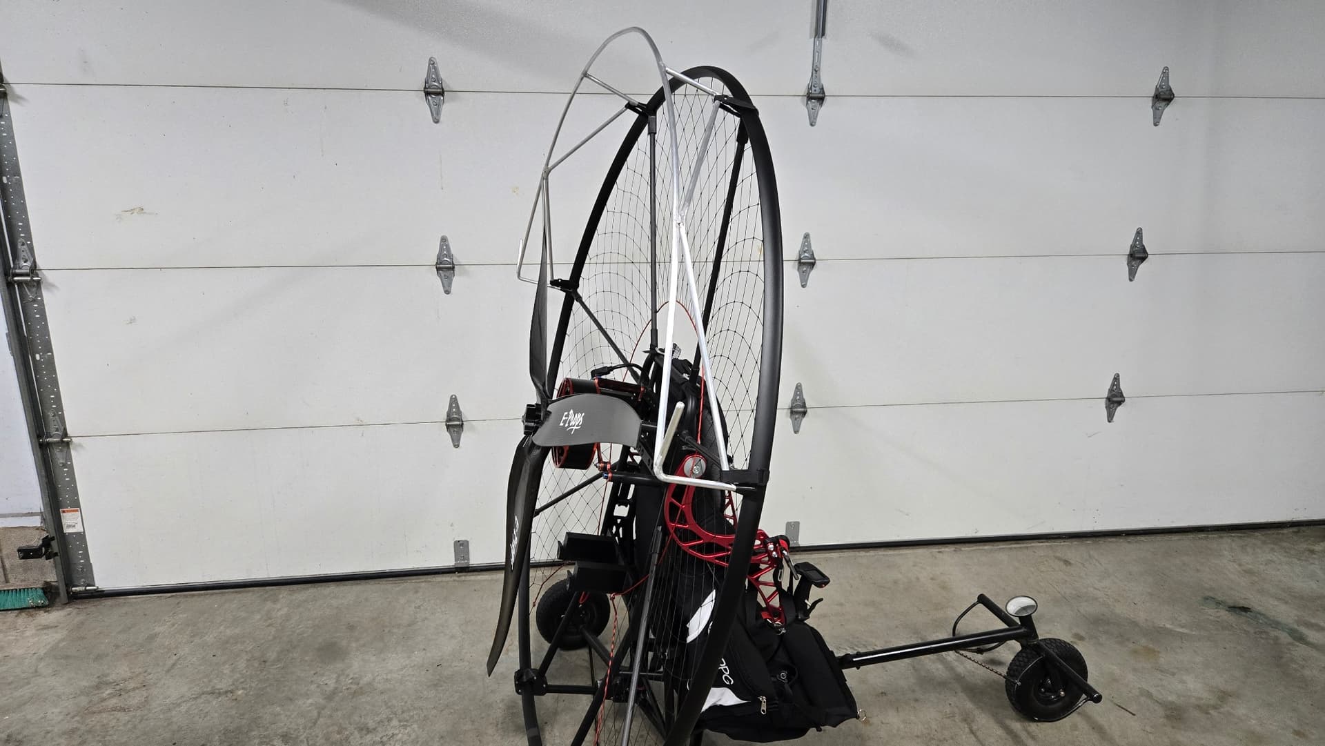

One more modification, I was still a bit concerned that an off center launch could cause the cage to be pulled into the prop, and I had been considering another cage brace. This is what I finally added, it makes a huge difference in the reducing cage flex and is pretty simple. Again, I modded the 3d cage connector model for the strut to fit into it. I bolted an aluminum socket to the motor mounts and solid 10mm aluminum rods for the struts. I may change these to carbon fiber tubing.
Nice update but it looks like the outer/rear is most likely to hit the blade under stress of cross load. Ive seen a freinds SkyTap/Angel cage bend under a good load and it looks way stronger than your rig.
It’s all down to technique on these light cages. Yes a severe off side wing inflation can pull the cage sideways into the prop, it is important not to continue the launch when this happens. My goal was to prevent line contact with the prop on a normal launch as the clearance is only about an inch
