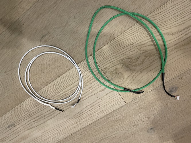

What type of wire did you use? I’m wondering if the current cable is picking up interference since I don’t think it is shielded.
24ga stranded silicone wire and metal cloth shielding tape. Both came from Amazon…the wire was made in China…not sure about the tape. Follow my link above to take you to the cable build photos. I always do an arm/run up moving my arm around before launch as an extra check. So far, it has been solid.:+1:
Thanks great details on the cable rebuild. I’m thinking of using aircraft grade wire, it’s stiff but very well shielded.

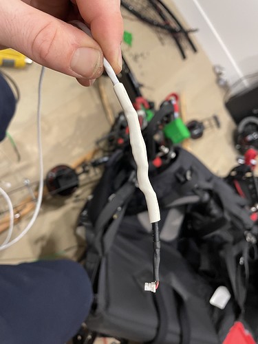

All done. Anyone know what the tiny connector is on the remote end? Would prefer not to splice wires just another weak point. Had some of the aircraft wire on hand. Will try it out and post results if system goes into disable mode still
Nice job! Yep, solder pads would have been a better design…more robust. I never had any problems with them on my quadcopter builds. Those connectors are ultra small, and I am not comfortable trying to crimp ends and build them. My crimping tool only goes down to .1" spacing or .025" square pins…like on the arduino…and those are pretty small. The throttle ends are tiny! For me it would just be something else to go wrong.
True they are super tiny, it’s a shame not same 2.5mm JST as the other end, we must have same crimper.
