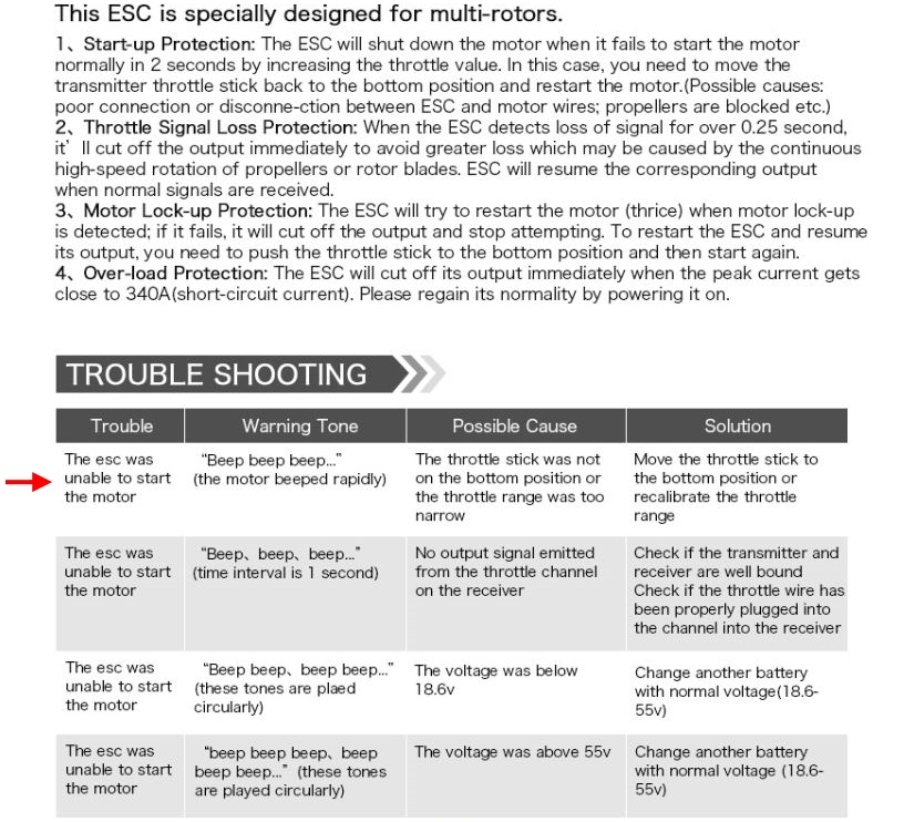

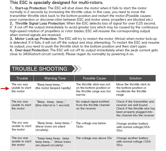

Listening to the beeps (see video above & turn up volume)… I would say they are 1 sec apart, not a rapid beep: so more like the 2nd trouble-shooting?? Also, I’m not sure of throttle calibration procedure: is it just a matter of holding full throttle while power-on? sounds scary! however, to confirm I do not have the props on yet. I could try with 1 motor, 1 battery initially?

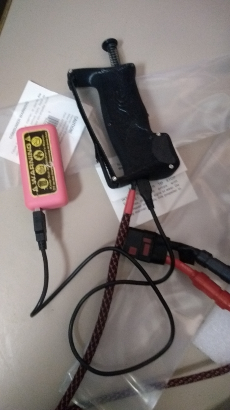

There is a USB connector on your throttle controller - you have to power the throttle controller externally with a power source and arm the throttle controller before powering your ESC’s with your batteries. In my case
the motors didn’t turned on, but for safety reason it is better without the propellers.
- You power the throttle controller externally and arm it.
- You hold full throttle and then turn the power on for your ESC’s/Motors.
- After you hear two beeps you let off the throttle.
- If everything went o.k. - your system should now work normaly.
P.S. Use all 4 motors and power it with 48 volt (if two or four batteries doesn’t matter)
Just tried that and unfortunately no luck. the throttle controller was successfully powered by usb and I armed it. 2 batteries in series: about 46 volts (they are in storage mode). all 4 motors attached. I fully depressed throttle then connected the batteries. then wait for 2 beeps. then un press. I tried this 3 x. Just get all 4 motors giving a beep every 1.5 secs. slow green flashing on the hub LED. Thanks anyway!
