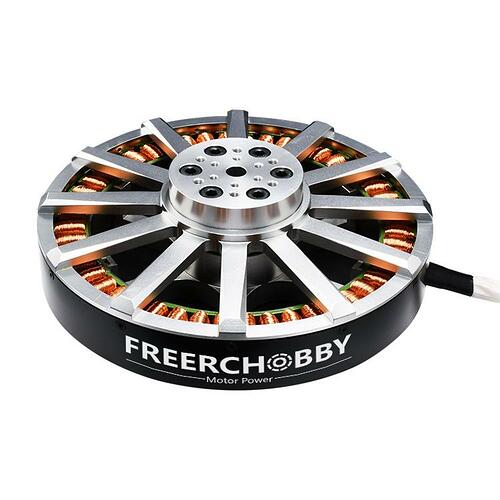

Anybody have any recent experience with this company?
Yes, I know, its cheap and from China, so one has to be careful, but I also own an ebike made in China. I’ve had it for 4 years and have put almost 6000 relatively trouble free miles on it. Still love it. Its actually had fewer problems that my $6500 Specialized Levo ebike. So not everything from China is junk. I’ve been quoted 47,000 Euros by MGM and 16,500 Euros by Geiger for complete plug and play PPG power systems. That’s just a bit more than I’m willing to spend.
your information on mgm 47000.- what does that mean. if you already give such information you should describe exactly what everything will be delivered. otherwise it’s just a number. why don’t you buy the sp 140?
I’m afraid the SP140 may not have enough power for my weight and field elevation so, per your suggestion, I started looking for something more suited for trike operation.
thanks for the list. I think the price is very correct. you asked mgm for a ferrarie custom single piece. custom-made it costs more money than a vw golf classic. since you described that you asked mgm and geiger for ppg, i thought you meant eppg like sp 140. an e-trike drive like the one offered by mgm is worth a multiple and provides a completely different performance. it’s like a 50 cc moped (eppg) compared to a 250 cc racing machine (e-trike). i would like to name people who fly professionally with freerchobby. Unfortunately I only know one pilot who only builds a light eppg with it for thermal flights. unfortunately i don’t know anyone with trike applications.

I have a ligth thermal assist project with Freerchobby MP15470 but this motor is far away from trike flying. With other motors from this brand I have no experience, so I can’t say anything about that. But one thing I can say and this is only my opinion: electric trike needs lot more power as a small thermal assist unit (what is used for short times than motor off and glide), so a trike drive system is on higher level. Itt is no question that good quality esc and battery for that. I would not thrust china build esc for such high level power. So if you are thinking the same, than you will see a good quality battery and esc will cost a lot anyway. Why would you use a cheap motor for that?
With this statement I will not say anything bad about FreeRC, for me I think it will be fit perfect for my application. It has some limitations, but it’s still in the green range. But if I would build a trike and pay a lot for another parts of the drive system, surely not searching motors just because they are cheap.

I have purchased 120100 BLDC motor and ESC as matched package
this motor was quoted 24S Lipo and ESC was also for uptown 24S 300A
I connected to 20S lipo and when plugged ESC together that caught fire which I managed to control quickly I didn’t even put in full 24S yet.
On complainein they told me I should have used 28S 500A ESC with that motor while they were selling that as package
While reminding them this is how they were selling Then I was offered 28S 500A ESC at reduced price and refunded price of burnt ESC
So I would say company is not bad in customer service department

I was thinking that the 28S 500A ESC and the MP238 would be a good setup for my trike.
To do a proper test I need proper battery pack and price batteries weight of pack is still stopping me to go out and built a pack which could be about 15Kg for 2KW pack costing £500 for good 40 minute flight Also need a good dedicated charger to charge 20-24S pack in reasonable time
