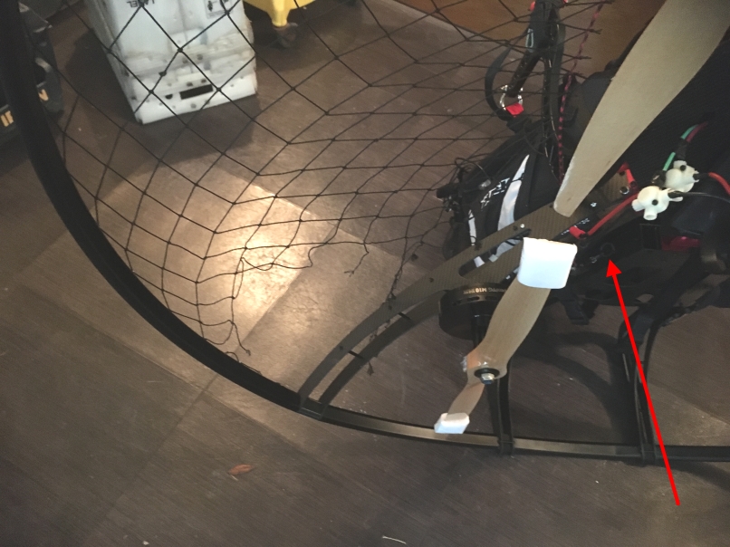

The repair is going to be fugly but it will work.
I suggest to move the position of your ring bolts to secure the net lower. Looks high and hard to secure the net correctlyâŚ
Most owners have it lowerâŚ
Much better angleâŚ

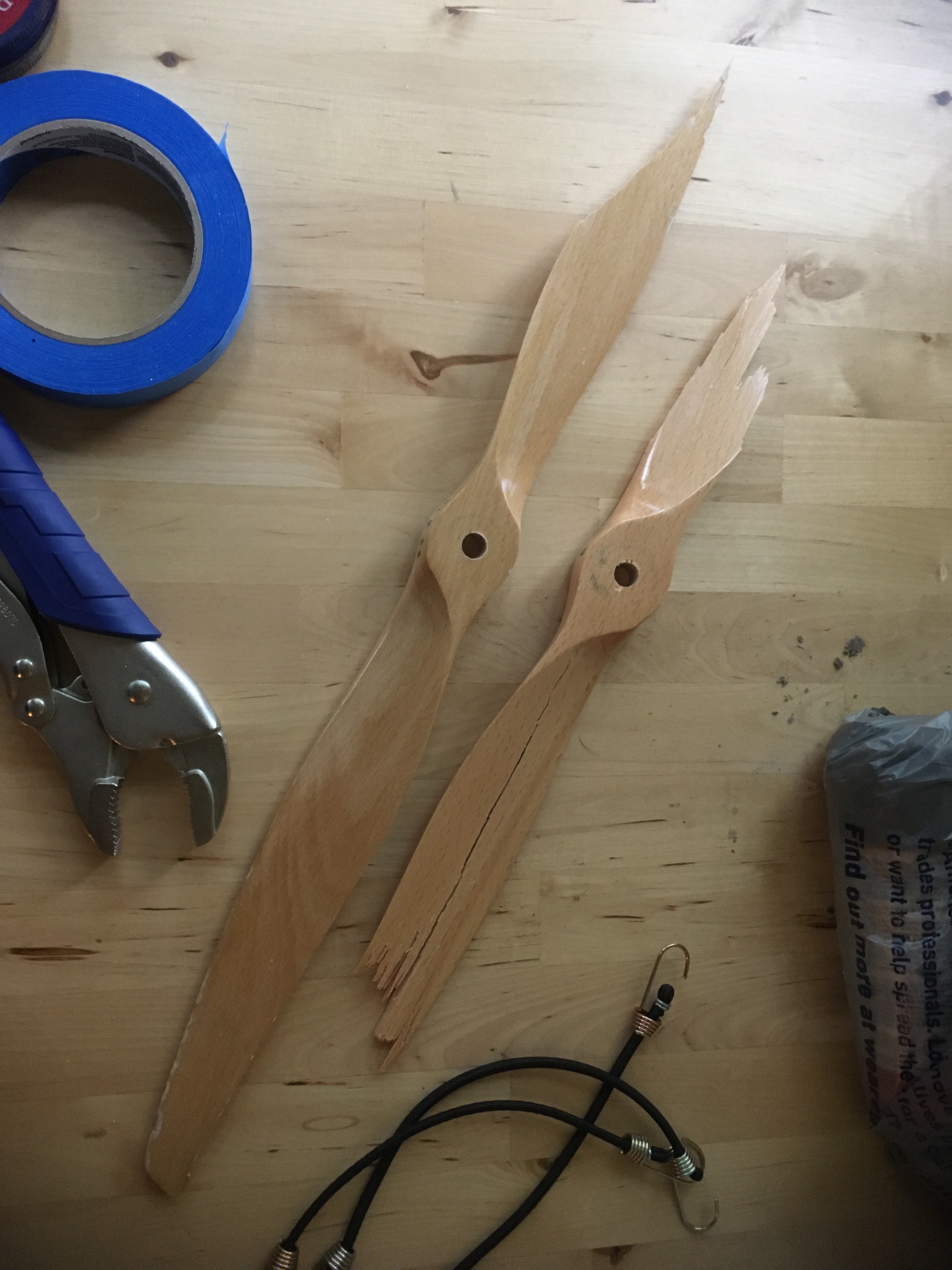

Repaired net is holding up to full throttle. Replacement props have been confirmed to provide plenty of thrust.
I used XOAR PJA 22x10 props as replacements because I could not find the exact type that came with the kit. They are a little thicker in the middle so the nuts do not go all the way down to the nylock, but threadlocker works to solve that. The Xoar props are in all aspects beefier. Not sure what difference it will make over long term efficiency but they provide what feels like equal push to the old ones.

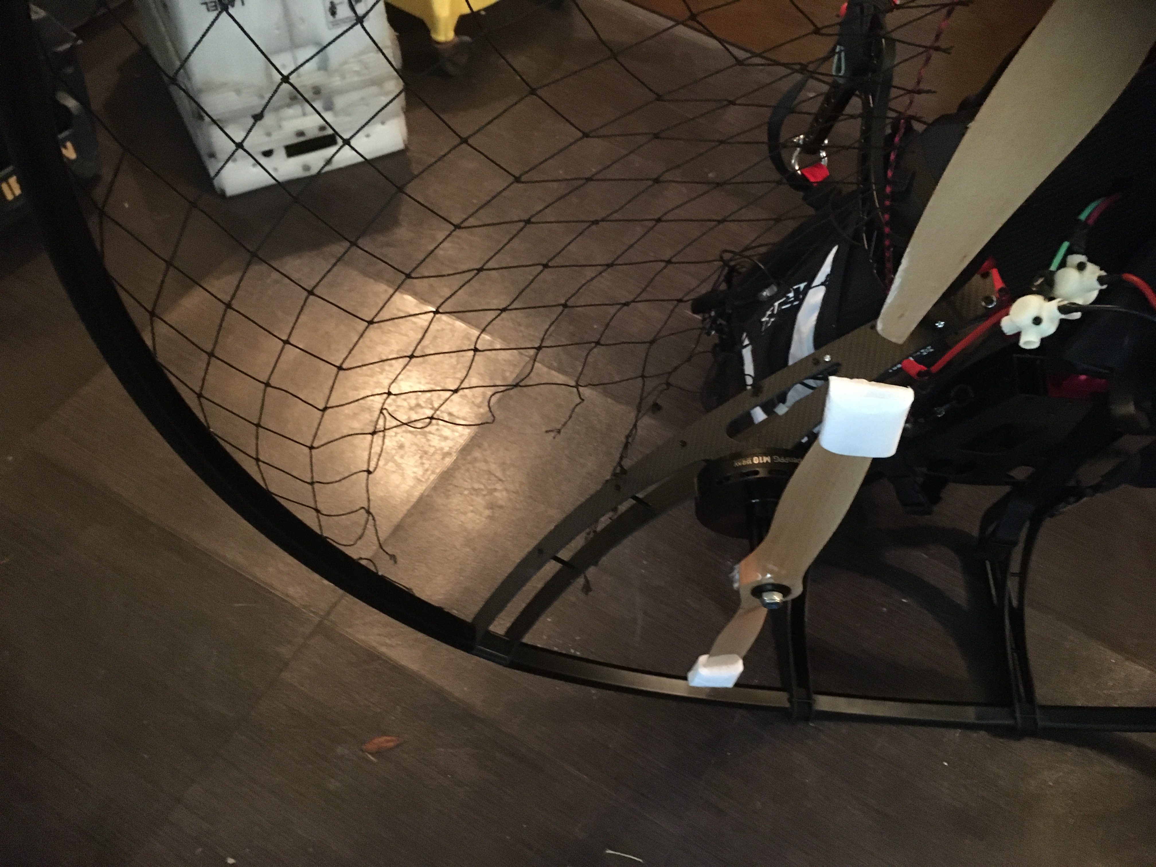

Huh. I actually just clip my net clips together. The bottom quarter is not netted at all. My net does not go below the lower motor arms. No clearance issues yet but I do pull it as tight as I can.

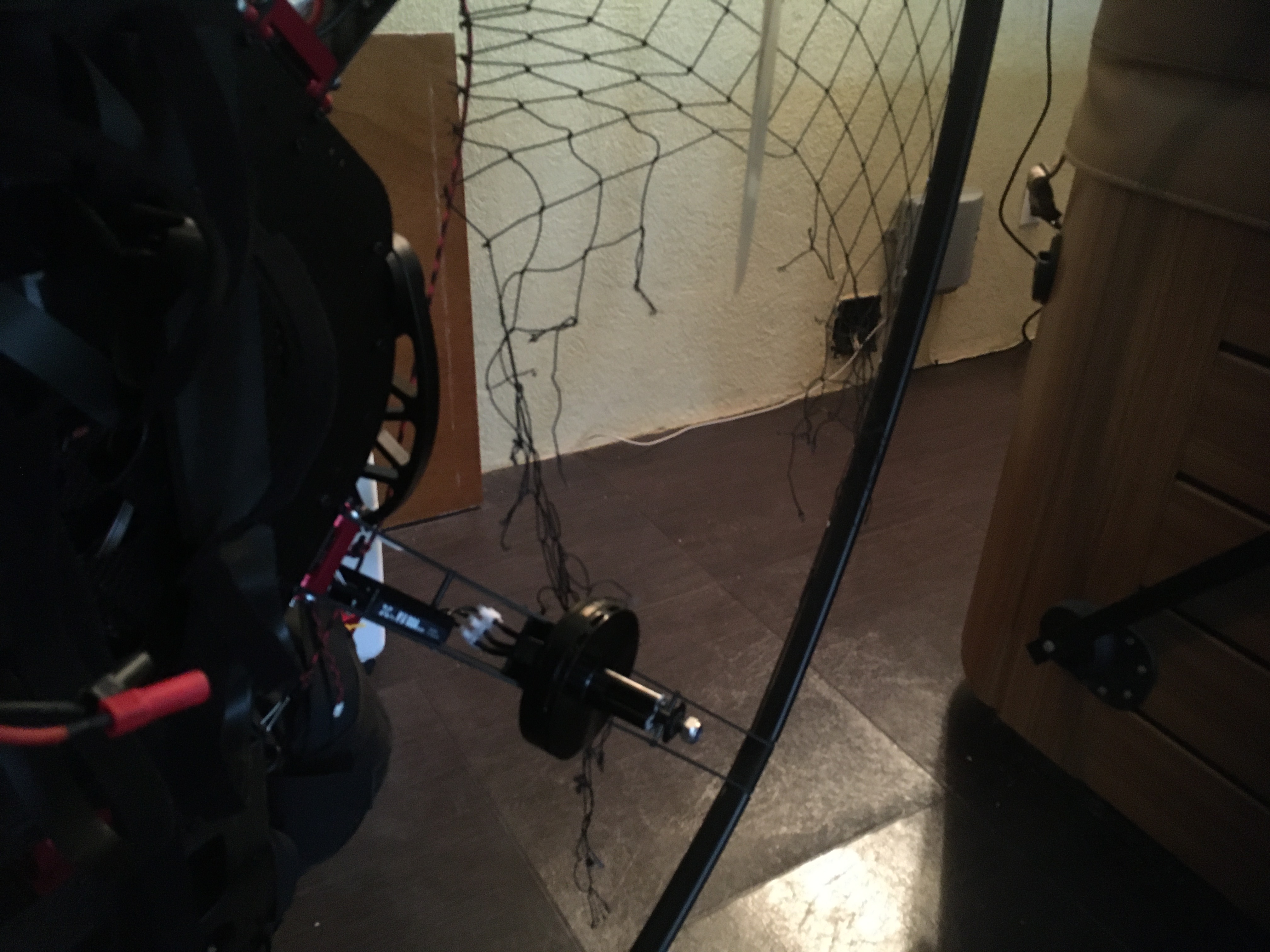

It is a security modification⌠You donât want this happened in flight:
https://youtu.be/E6rBi2JHXxA?t=126
GliderPilot had the correct solution, how to connect the netting secure. The prop tips are
very close to the netting.
Yes, the new prop shaft things came in.
Yup thatâs exactly what happened to me. Except i lost both bottom props and both sides of the net.

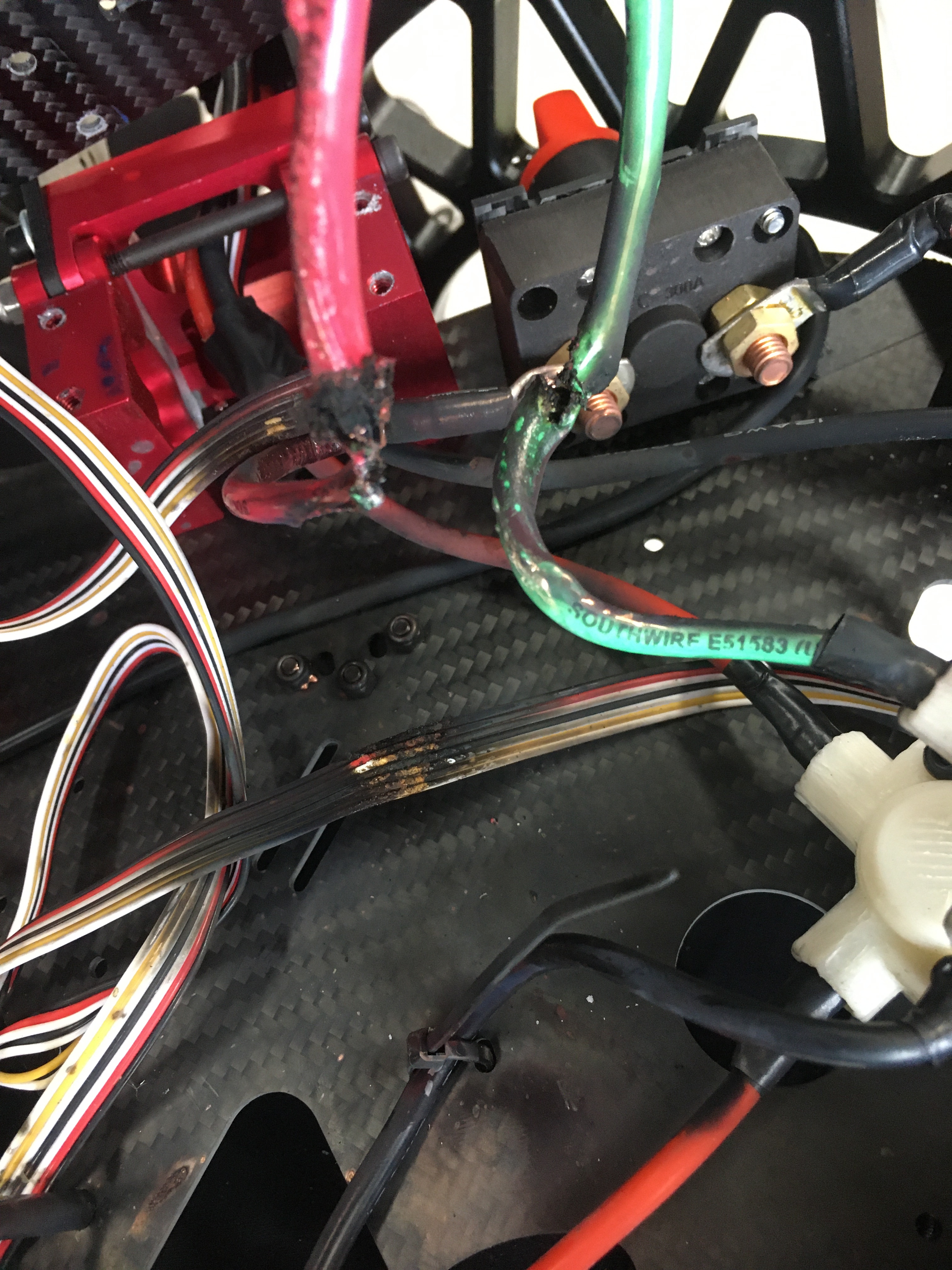

Fun times! This was WAS 10 gauge wire. Looks like it got hot where they were touching, melted through the insulation, and fireworks show. I have since gotten rid of it and only using the wire that came with the kit. Everything still miraculously works, though Now i feel like the ghostbusters first time turning on their backpacks.
You can not use 105 C 10 AWG wire. You have to use 200C 8 or 10 AWG Silicone wire.

If you use gas engine propâs with a thicker center hub, than you will have problems - there are topics for this as well.

Itâs all 100% the âgood wireâ in there now. Problem is, today after a 30 second flight, it totally died. For some reason both xt150 connectors separated from the wires. They were not hot enough to have melted the solder (the wires and connectors were just warm to the touch) unless there was some freak thing going on. Further inspection showed that the power switch is fused âonâ regardless of its on or off position.
