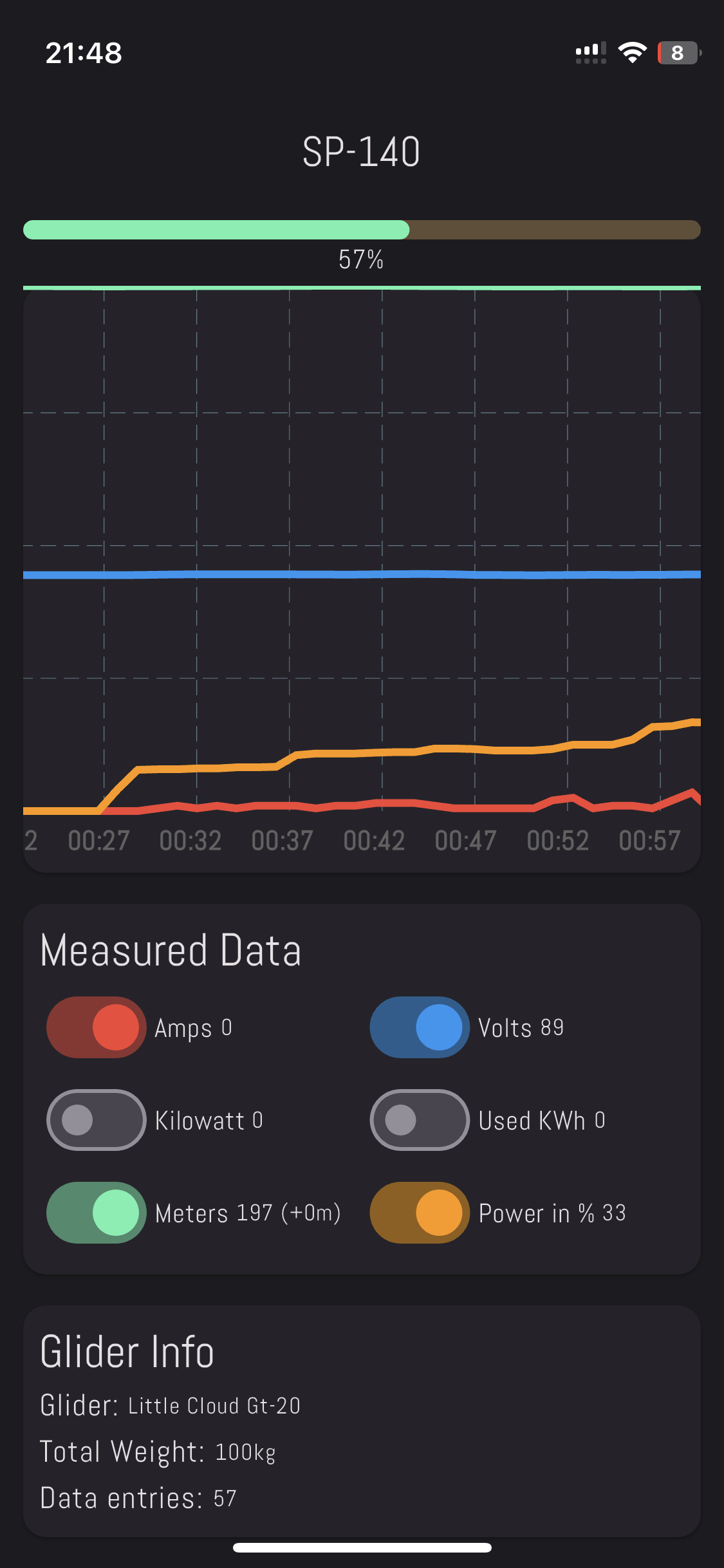

I recently bricked my throttle controller (here). Looking at the shipping and import cost and time to Estonia, I thought of making a minimalist throttle for the time being.
I used the Xiao ESP32-c3. I tried to keep it simple hardware-wise, so I log all the data to my phone via BLE. The altitude is also measured by the phone not the controller.
I only tested it without prop but it works well so far.
It also lacks some features such as cruise mode and Sport/Normal mode.
