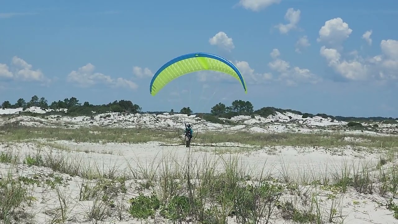

Fun but Hot Day at the LZ with my OpenPPG SP140 V2 Atom80 and Tensing 23! Once in the air, it was worth it! :grinning: I love this SP140 frame with the Atom and 140cm e-prop. :+1:

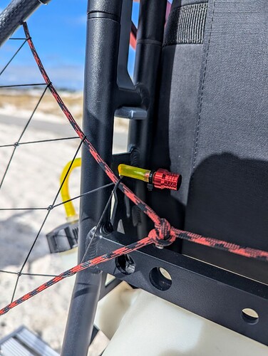

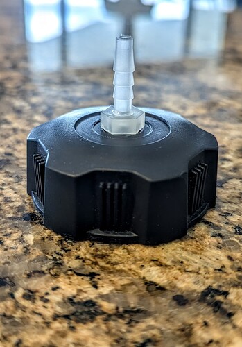

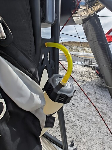

My gas tank breather tube disappeared during one flight :zany_face: , so, I decided to make a small modification to my gas cap.
I ordered a 2-way (without the steel ball) motorcycle tank vent and a 3/16” barb X 1/8” NPT fitting. I cut all but about 1/4” of the 1/8” threads off of the fitting and forced it down over gas cap vent. I was just lucky the tolerances were Very tight; otherwise, I would have used a bit of JB Weld to hold it in place.
Here are a couple of pictures of the finished product. It works great, and I don’t have to worry about any parts going through my prop. :+1:

Looks good Bill! I lost mine too and have just been flying without it. What is the main purpose of the breather valve?
Hey, Paul, I hope you are well and will have a Merry Christmas!
Where I fly in the Florida Panhandle, the sand is like very fine sugar….and it gets into everything. Since the breather is so low, I decided to continue to use one on the end of the tube to try to reduce the port of entry into the tank. I could have run the tube up higher but kinda like the shorter version and where I put it. Take care!
