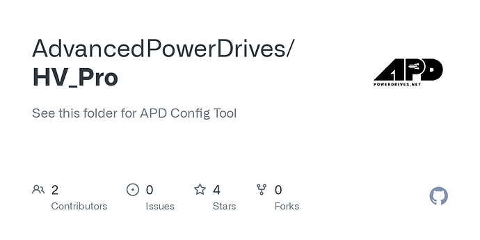

Looking at the ESC settings in the configurator, if the ESC reaches 120°C it will hard shutdown to preserve the ESC. Although I’ve never gotten my ESC above 70°C. I’d be interested to see your ESC logs. You can access them through the configurator from APD if you’d like.

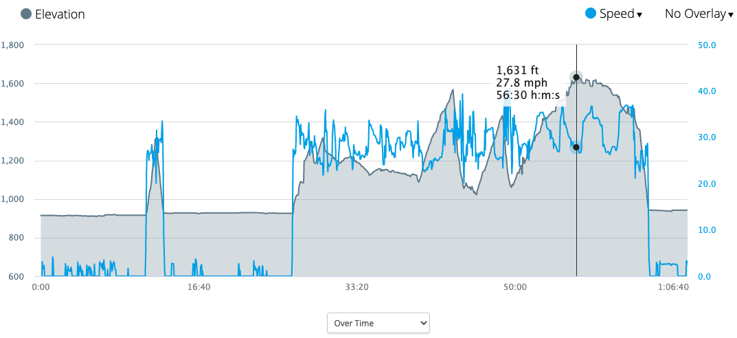

yes, this was my first flight from fully charged. The battery was at 93% when I started and settled at 87% after I landed and reconnected the battery. We had 80F-something temperatures, so definitely above 70.
I am pretty excited about the unit, and after 2 days of flying it, definitely looking forward to flying it more. I should probably stop worrying about the flight time and just go back to enjoying the flight. So far everything works as expected or, as I now know should work, from Paul and Zach’s explanations. Summing up the two flights from day 2 I get exactly 40 min. My second flight I tried to be as easy on the throttle as possible, only throwing down a couple of spirals. This is consistent with about 6 kWt that I saw at level flight. This is before using the trimmers and the speed bar. I am curious to see how those affect the number for the level flight, and will try at some point.

Wait. ESC settings? Where do you get a configurator?
correct. I expected as much on my wing, as it was also consuming around 50% more fuel on my old engine compared to a beginner wing.
APD ESC Configurator:

you can see my both flights from Wednesday here
