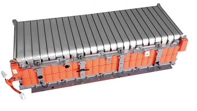

Not sure if this is of interest to anyone.
Summary: Compared to 6 Bonka 22,000 6S @ $220 ea
Pack Cost: $492 shipped vs $1,476 shipped (Exactly 1/3 the cost)
Flight Time: ~31 Minutes (same)
Capacity: ~3 kWh (same)
Weight: 30 lbs (same)

I’m seeing this as 20lb heavier for the the bonka equivalent.
8.37lb per module x 6 modules = 50.22lbs
Looks like you calculated the cost with the right amount of modules but did 4 modules for the weight?
This is the original listing I was looking at. It has 5 lbs listed. I do agree that the other has two weights. Would be interesting to see what the discrepancy is caused by. Possibly the cell vs module (cell + casing). The reason I linked the one I did was because it was a little less expensive.
https://rover.ebay.com/rover/0/0/0?mpre=https%3A%2F%2Fwww.ebay.com%2Fulk%2Fitm%2F123303287202
Looks like I found the source of the measurements. The 5 lb value must be a guess or a lie. Naturally that was the number I saw and used in my calculations. Thanks for catching it. Kind of a bummer that the energy density isn’t quite as high. If you can tolerate 50 lbs of batteries then this is still a great value.
