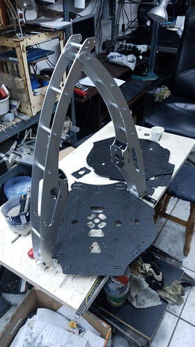

Today i made the backplate from aluminum, before to cut in the CF. It came out nice. It is only 1.5 mm thick, the only stock i got at home amid the virus curfew…

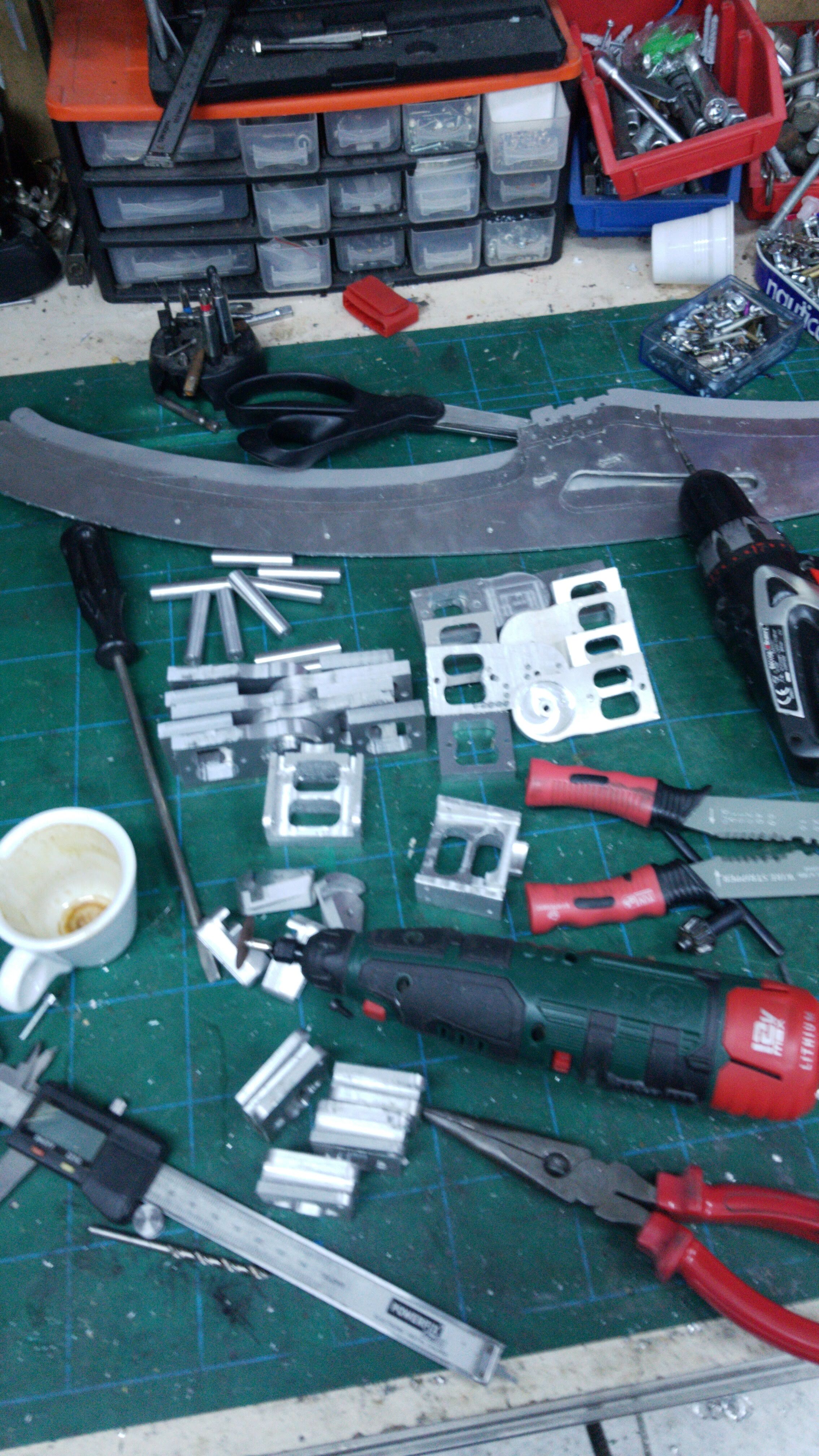

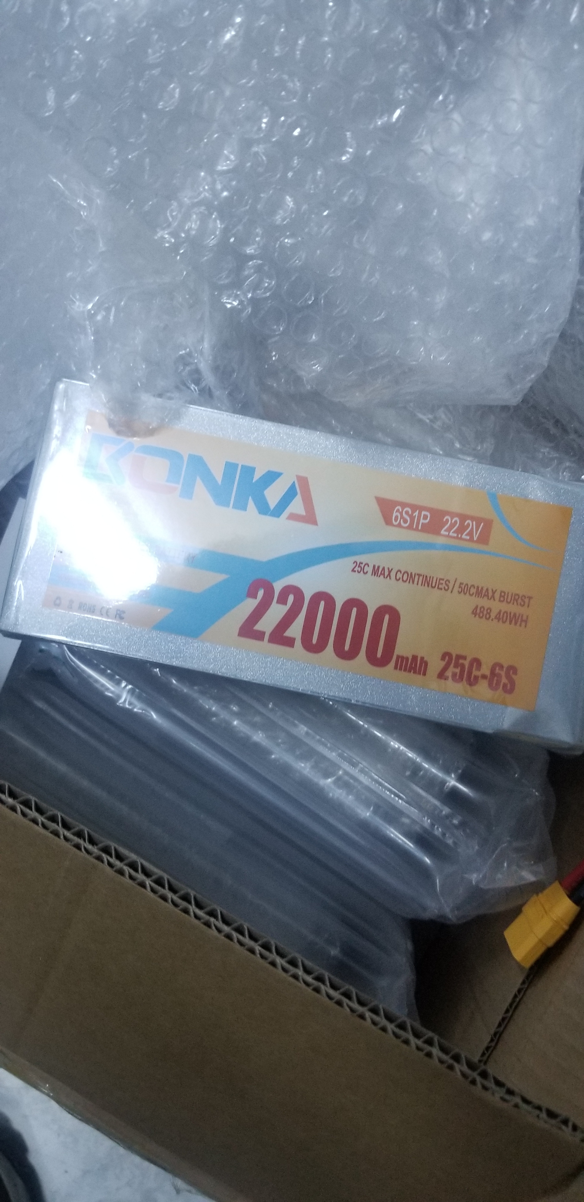

Today my Bonka’s arrived from HongKong, via UK. Directly, customs by them ! Great. I(in the midst of the crisis)

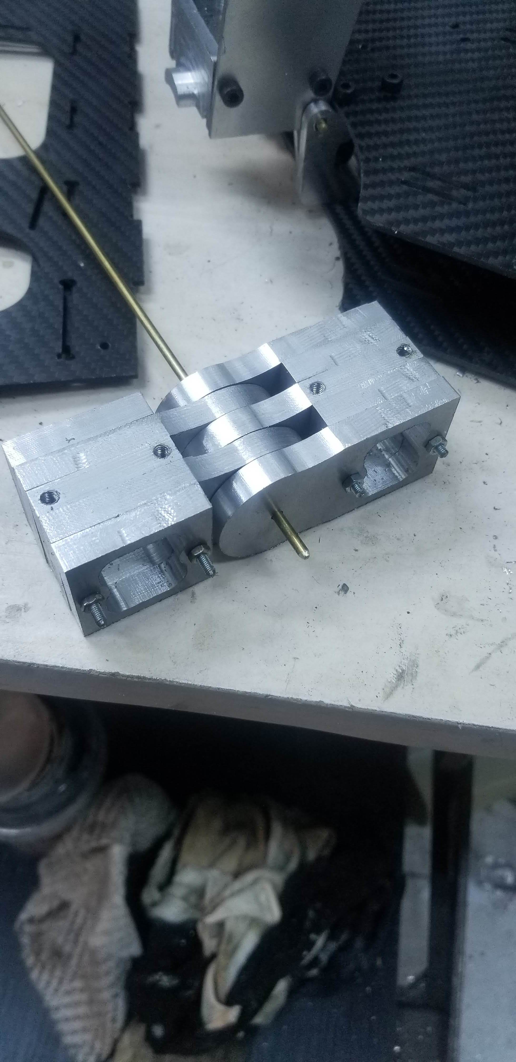

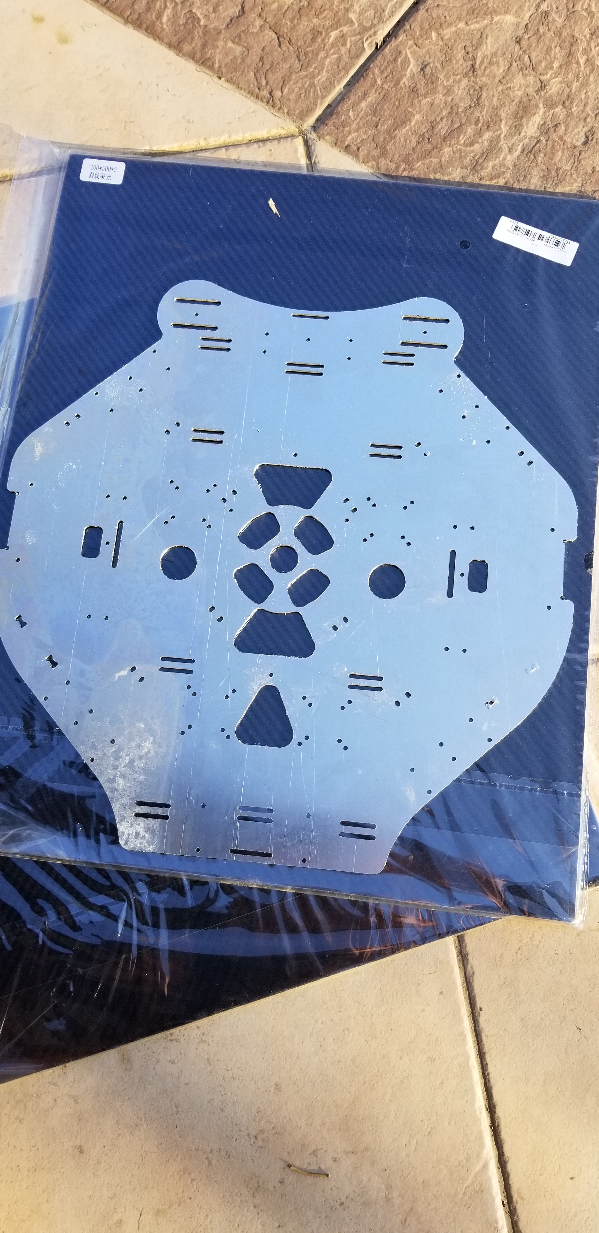

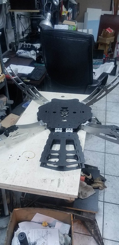

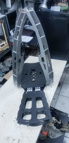

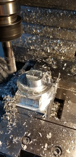

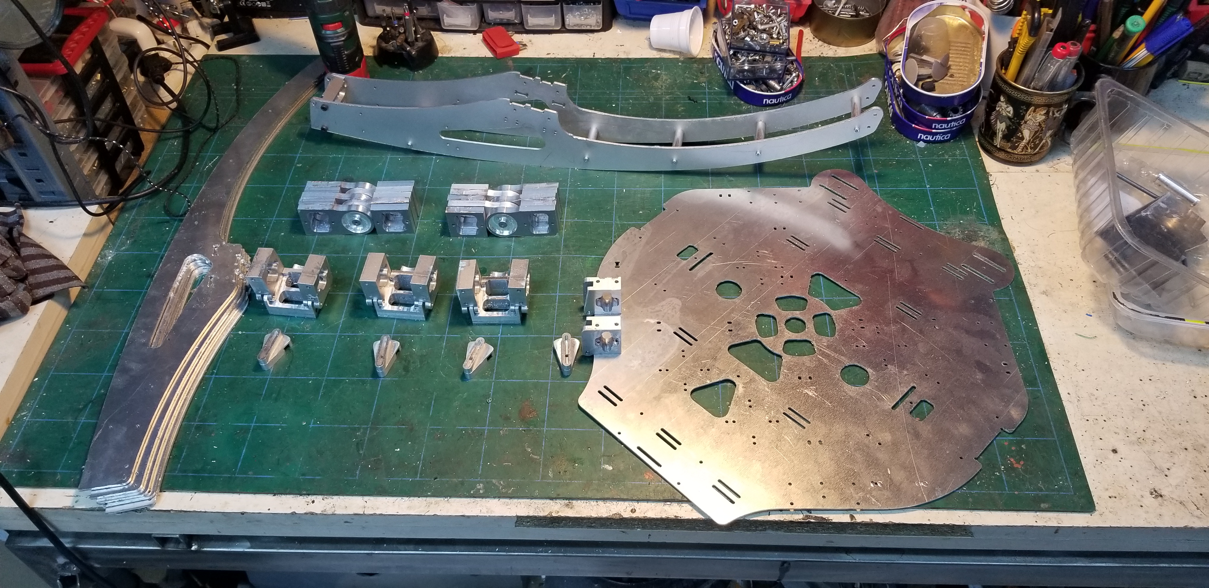

After i got the CF sheets from Banggood i started to cut them. 3mm and 2mm. I used a 3mm bit so i modified the design where necessary. That was cut with 2 mm. Regarding the CF sheets, it is even more cheap to buy from china compared to fabricate at home. Only the fabric necessary equalled the price.My problem was that the max size available is 500 mm. the arms are 600, so i decided to make from aluminium sheet.( If i would fabricate a new one i would use CF and combine the parts to get the 600mm.)! I made the leg hinge from multiple parts, it came out OK. I need some new stock for the legs and goosnecks and holder.

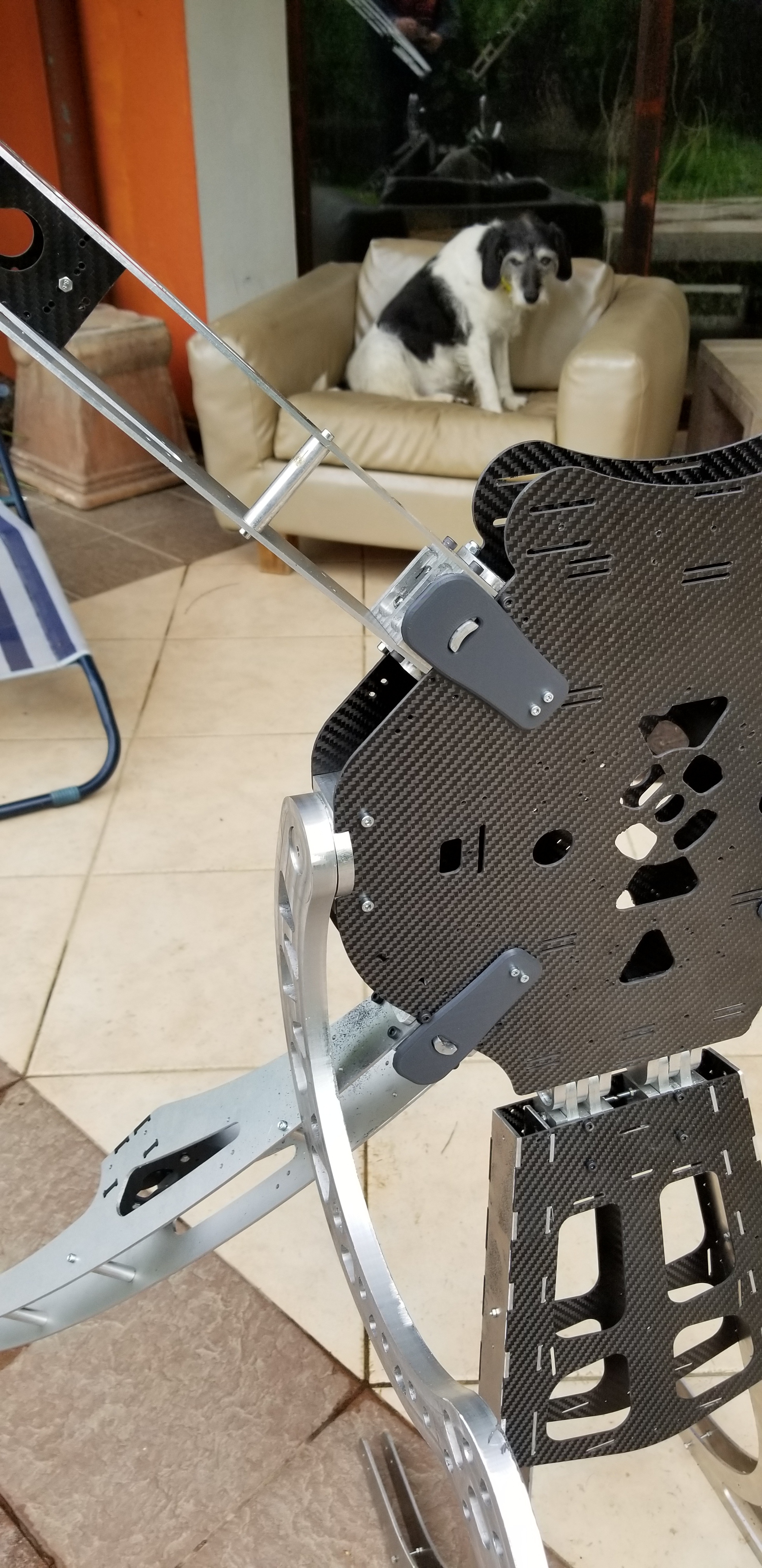

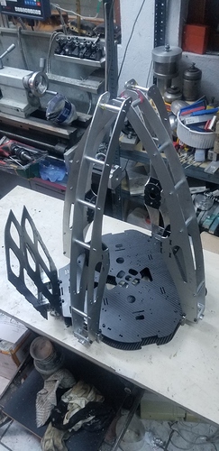

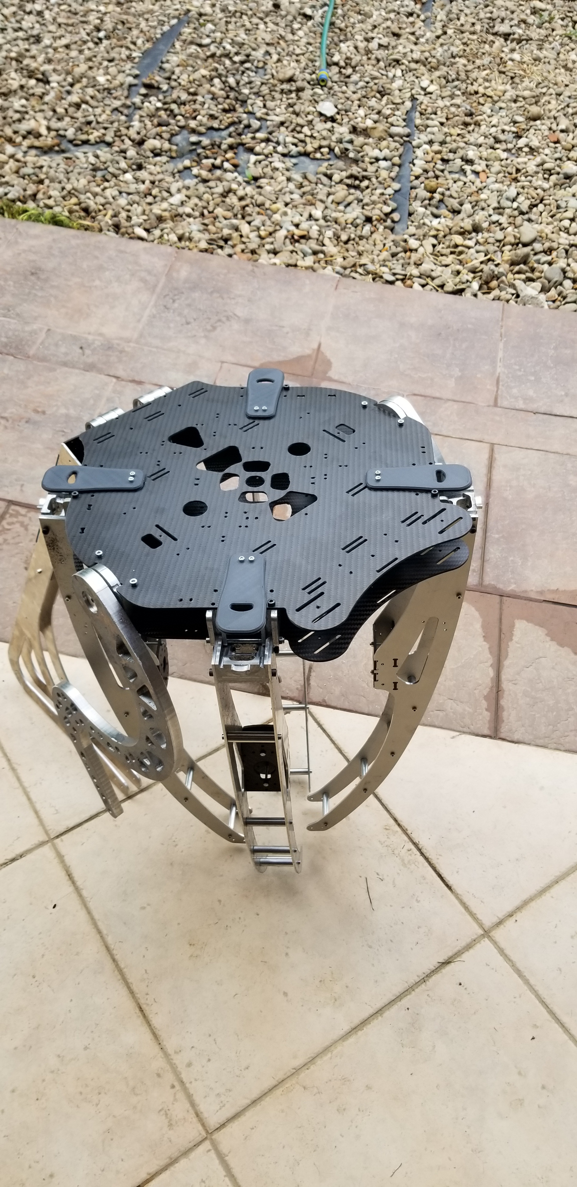

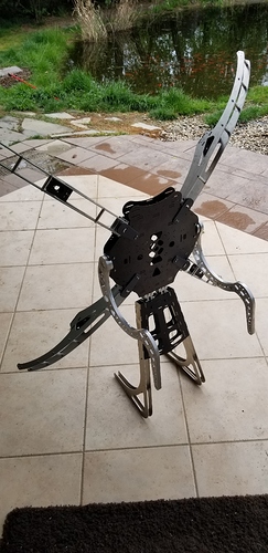

Hi, i achieved a new milestone, the fabrication almost ended, i need to make some small parts. Printing some. Waiting for the standoffs, should arrive anyday. As a conclusion, it was a lot of work, some parts needed to be remade, some mistakes. The kit has a very good price !. I am not sure i would do it again.( Altough the tax and customs add up to 36%). Ordered the Dudek harness, i have 4 Bonka’s. So i am waiting for the news from Paul that my parts are on their way. Thanks for the White brothers for this great project, and all who helped me, Gliderpilot, i printed your latches, they work great and looking into the other mods as well.Some pictures:
Gorgeous. For your efforts you are rewarded with perhaps the best looking X4.
