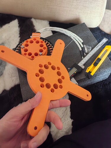

I did model motor mounting bracket with wire support and case for assembling test version so 100v will not kill me. Once frame is purchased need to order that bracket from aluminium
Nice looking prints
