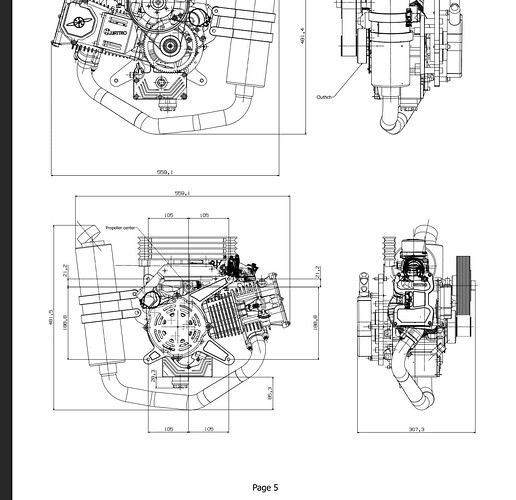

I’d feel slightly less bad about burning gas up there using a 4-stroke, so I’m looking at the EOS Quattro. Could that monster be mounted onto a SP140 frame?

From what I can see, this is the bolting pattern
So the motor would fit the frame and prop clearance would be plenty, but you would need a mounting plate as most all the Ice motor manufacturers use different mounting patterns so they’re not going to be a simple off-the-shelf mounting setup. Also, this is pretty raw motor, so almost all frame manufacturers would have to make something special. If you are really set on this motor and you cant get away with an Atom 80 thrust, then I can look at some mounting options.

Hi Holger
Go with the atom 80 140 cm prop from openppg. I have it and it works really nice and only burn 2.7 liter/h. then everything fits and the geometry is good for your hangpoint and balance. and you can change the engine to battery and e motor
