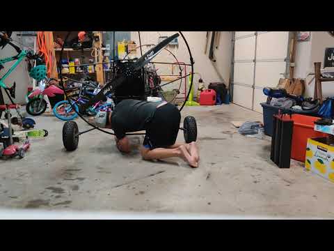

Here is how I mount the SP140 to my colibri trike.

Dchastain - after trying several different solutions I think your hole drilling for a Colibri is the best way forward. What technique did you use to center the drilling on the tubes? Thanks.
Are you able to do full power inflations alright without the hoop bending into the prop?
I can imagine you’ve gotta get a perfectly straight inflation to avoid lines in the prop. I’ve been thinking about designing a clamp-on double hoop that clamps on the existing hoop for trike use.
