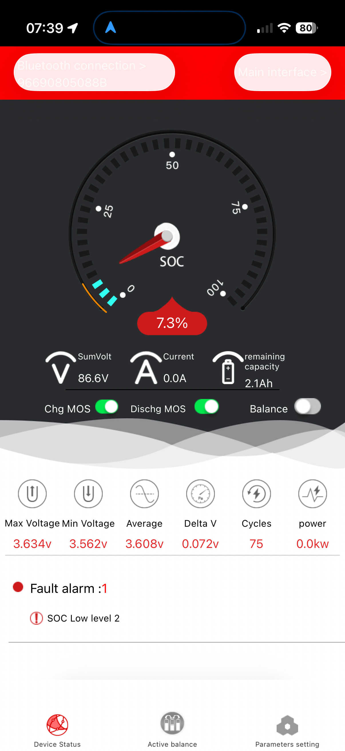

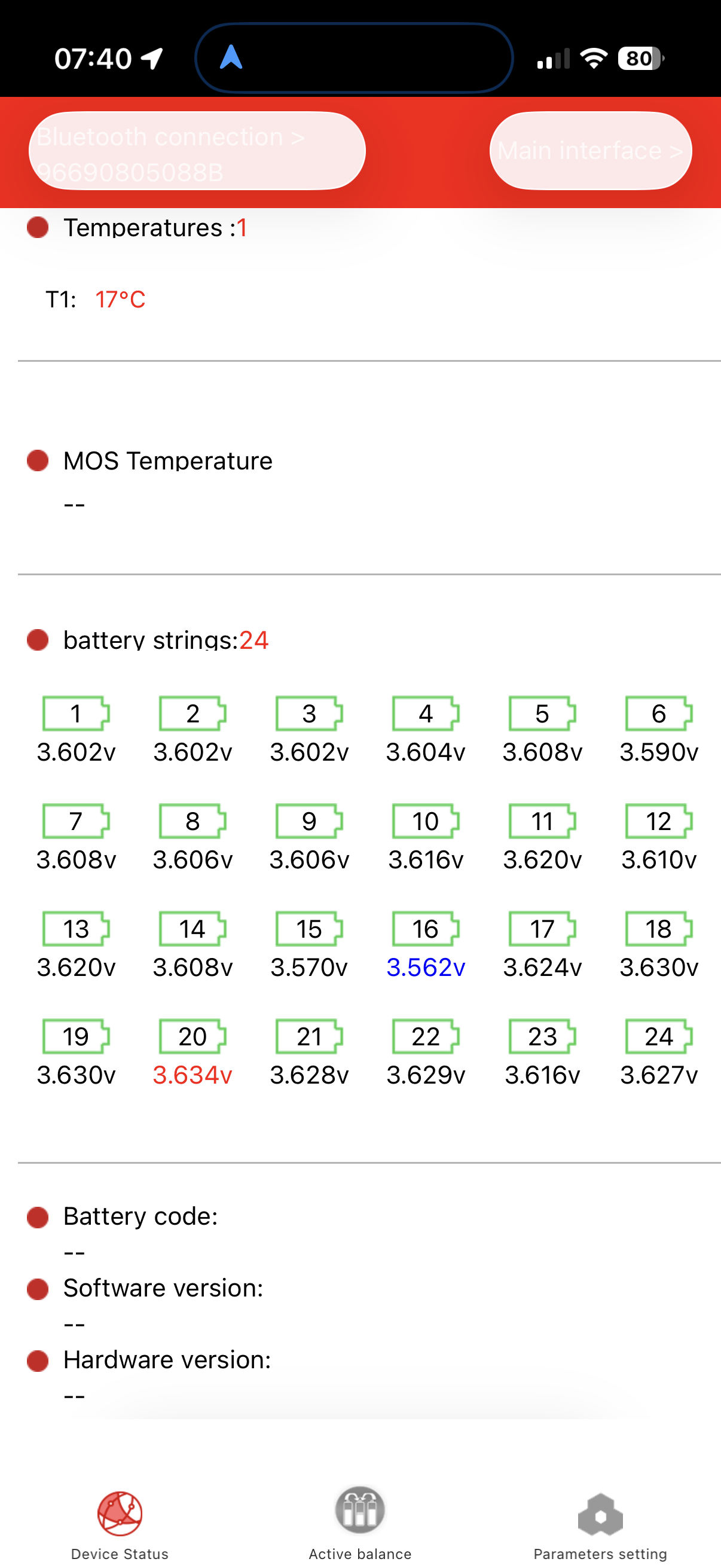

Here are the BMS Screenshots. The charger just says 100v 0amps. I see zero voltage change from when I turn the charger on and off. I tried enable and disabling charging and it’s still not working.
Is this a screen shot taken while the charger is also pluggin in to the battery pack at the same time? I just want to see if any warning info poping up while the charger is plugged in to the BMS
That screenshot was taken while plugged into the charger. I finally got another charger and was having the same issue. No charging. The battery can discharge but it will not charge. The charger immediately goes to 100v and 0amps going into the battery. The BMS indicates no faults. I tried logging into the Bluetooth and toggling the charging switch still no effect.
A friend had a new Open PPG BMS we tried swapping it still same issue. Any idea what could be going on? We are out of ideas. I feel it’s unlikely we have two failed BMS that failed the same way.
