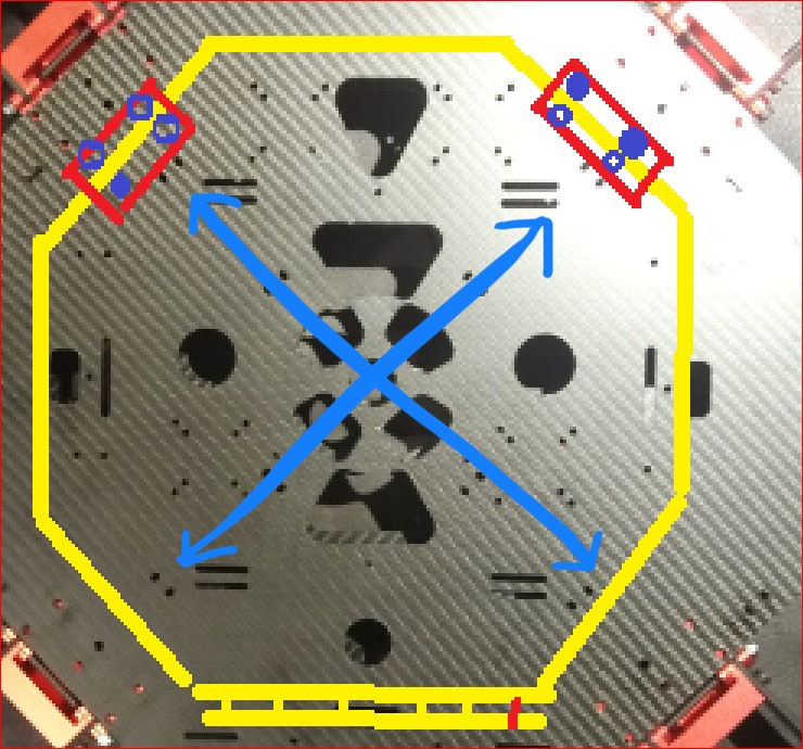

How compromised would the structure be if i cut a wiring access hatch in the rear mid body panel? Hinge at the bottom - some aluminum strips (red) under side added to re-secure some how. Any thoughts?
Should be fine to cut holes there, very little compromise.
I get what your saying - very hard to keep that with the holes there and then that only gets me 4 smaller sections to work in
I think one bigger hole is better with minimal compromise per PW, but thx for chiming in, always appreciated.
I gotta agree with @GliderPilot. I wouldn’t cut the opening as proposed. That back plate X pattern as drawn is a pretty critical tension support. All your thrust from the arms goes thru those Blue lines. Trust me, I get the desire to have an access panel, but be sure to find a way to keep support across that X
I was basically saying not to cut it at all because you need the webbing where the blue lines are.
I could add other means of support
Possibly leaving the cutout out, and adding a piece of plexi over it screwing into corners
Or I was planning on these boxes for my batteries and use their structure to shore up the lost integrity?
