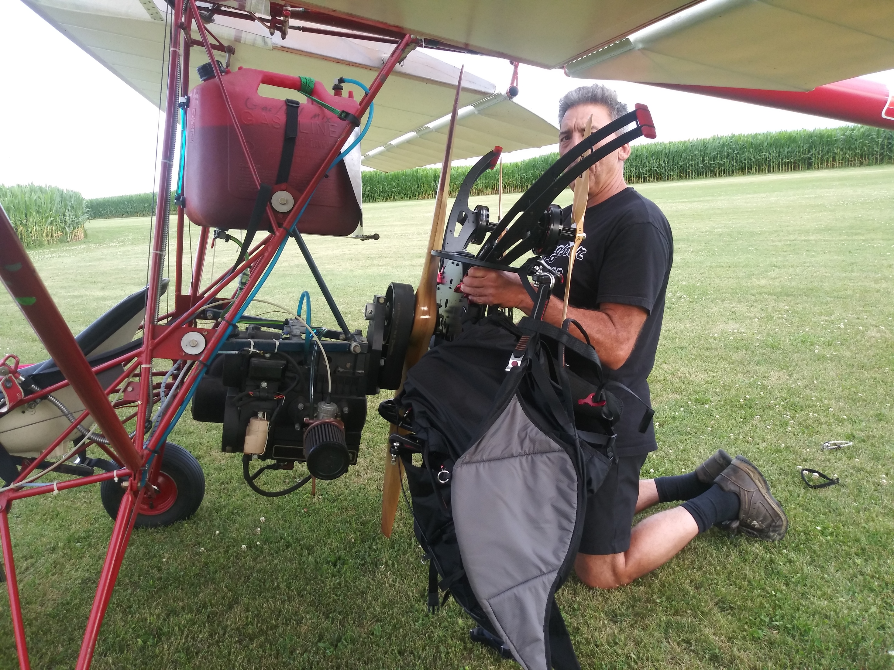

I thought I would share a few more pics.
When I put the middle of the cf back plate on my unit up against the center line of the prop, there was 4 plus inches from upper prop tips to lower surface of the wing. The lower prop tips were 6-8 inches above ground.
Next, if you look closely at the engine mount in black steel. You will notice that after the engine is removed this mount will stay and become a battery tray.
This will also allow me to move my electric mount forward and attach it directly to the existing steel engine mount.
The dry weight of the engine without reduction pulleys and wooden prop is 65 lbs. I will remove gas tank with all of its steel mounts and the BRS which weighs 22 lbs for more weight reduction.
I believe I will take 95 lbs off.
The electric unit probly weighs 19 lbs.
8 batts at 6.5 lbs = 52 lbs
The center of thrust and the weight will be in the same exact location as it is now.!
I do not believe that I will have to do any mods on my throttle.
Maybe lengthen it and put wire in a plastic conduit.
I need to put a little time on plane before I start the conversion. I have several hundred hours in a Firestar.
But this is an Ultrastar.
Soon to be an
“Electra Star”
More to follow in Sept and Oct!
