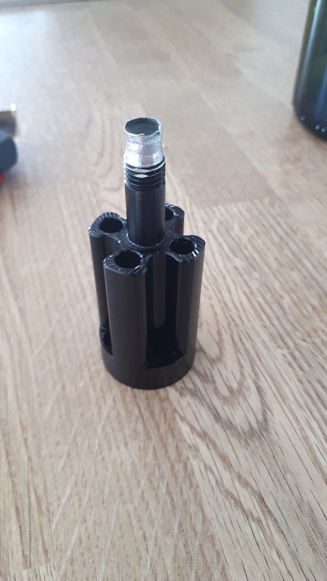

What was your reason for replacing a prop standoff?

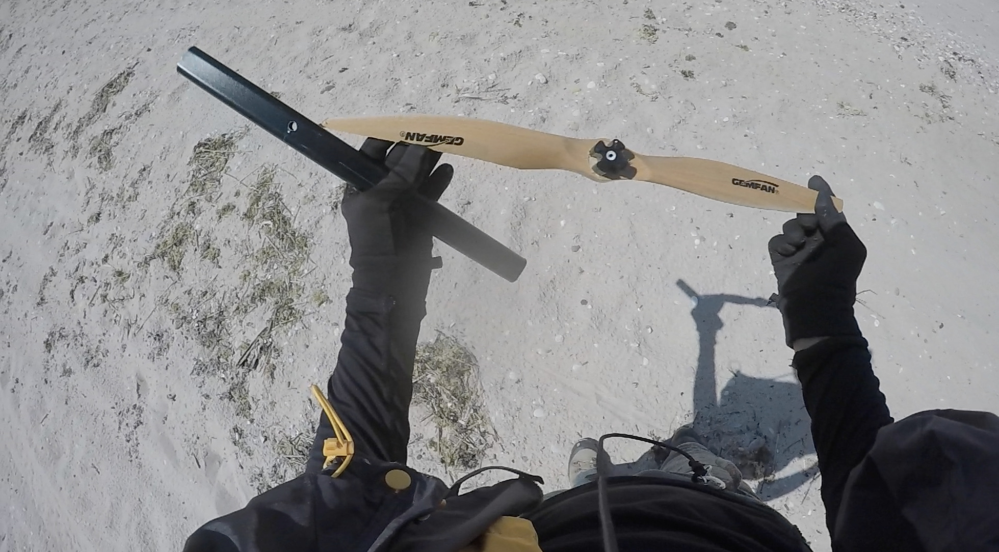

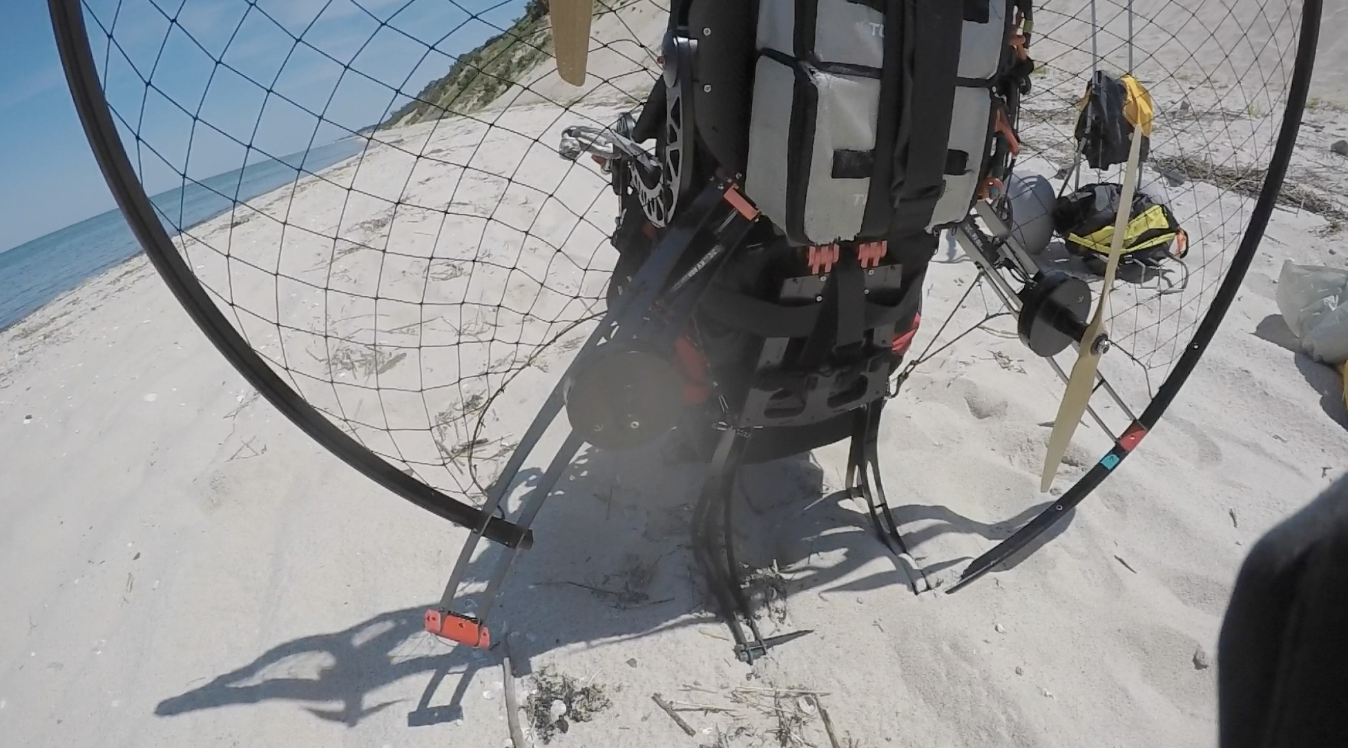

It was a weird one,… I had forgotten to bring the hoops stiffeners I had made with me that day ( they work great and I think your brackets would make things even better). So, I took off with an angled cage because overtime, the connections at the ends of the tubes had loosened quite a bit. I inflated the wing, an accelerated. I remember hearing a weird noise and almost aborted the takeoff but went for it anyway. The noise did not last more than a few seconds while I was running. 40mn later with a bit of help from the ridge lift, I landed, and when placed the PPG on the beach, I walked behind it and my lower jaw just dropped… I realized I had flown 40 minutes with only 3 propellers :grimacing::rofl: In retrospect, I remember my right turns being sluggish​:crazy_face: The bottom prop was gone and the shaft, just like your busted clean. The bottom left section of the hoop came loose during the run and must have hit the prop, creating enough force to snap the shaft. Interestingly enough, after retracing my steps on the beach, I first found the piece of tubing and it was completely intact ( I can’t figure this one out). I kept zigzagging slowly on the beach and sure enough, found my prop, with the rest of the shaft and the bolt. That was the flight THE ELECTRIC BUZZARD 6 - YouTube
If you look carefully, you will notice that there is no orange/beige colors at the bottom left (the blur made by the props😏
Dang, that’s crazy! So it happened on takeoff and you didn’t notice the thrust difference during climb? Do you think the hoop came off first and hit the prop? Or did the prop come off and hit the tube? On mine the prop came off during flight and could have hit the batteries! That’s why I’m replacing all four with the new one piece design.

Take a look at those pix :grin:
Notice the left tube section disconnected from the arm…

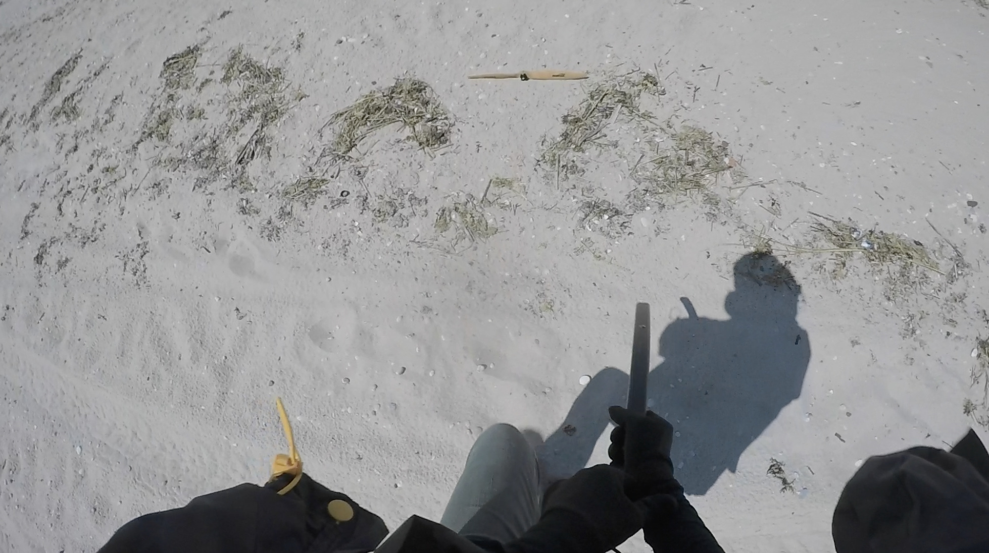

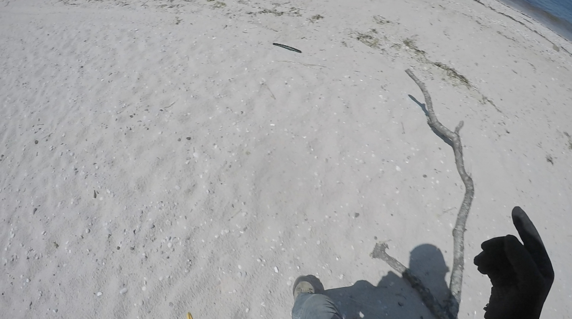

Locating the lower left tube
Locating the prop which landed further down the beach
Notice one of the blade is missing the tip and the entire leading edge
The batteries were fine and so was the tubing. I don’t really understand all of it. No one will resolve this one😆
All I am sure of is that the bottom left connection came loose during the run; the rest is a mystery.
That makes perfect sense. Based on where you found the parts, the tube came off first and then the prop hit and broke off.
About a month ago I forgot to tighten my net. The prop struck it after I hit full throttle. I bet that damaged my standoff because 3 weeks later the standoff on that same motor broke during flight. The other standoffs are probably fine but since I couldn’t tell the damaged one was about to break I’m happy to be getting the one piece versions for all 4.
I may get 3 more standoffs. Lesson learned. All is back on track now.

The stud on that standoff is aluminum. If you force it off it will probably sheer the stud. That might be the only way to remove it though and then replace the whole standoff.
Thanks Paul. I’ve done that & it did shear the stud. So I’ve ordered another 2 standoffs. Fingers crossed they will not take too long to get here to the UK. The nut was completely “welded on” so I think you’re right that was the only option. Funny because the other 3 are perfectly fine. I think I’ve been unlucky with this machine but I love the design and I am determined to get it back in the air.
