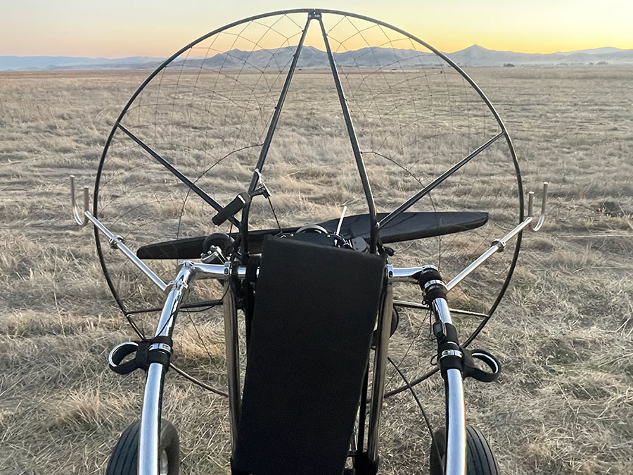

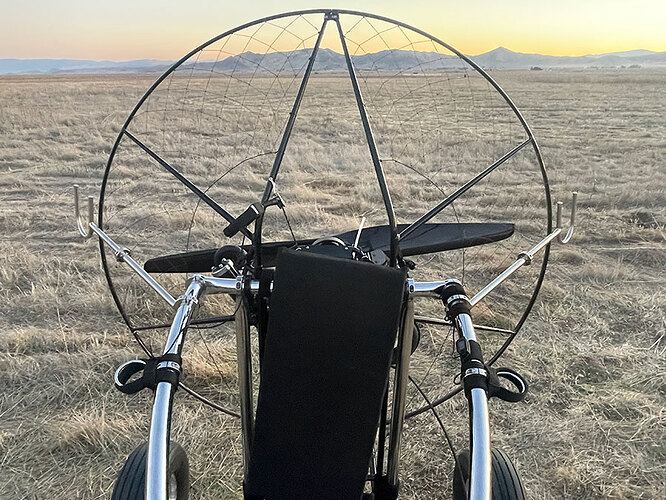

Finally, had a chance to test out the SP140 on my 15lb trike with a cage protector and bracing. I’ve been waiting for a day with low winds along the length of my LZ for long distance kiting. It performed flawlessly. I intentionally used an old 130cm prop just in case the cage flexed, but it was rigid and launched fine.

If you note on my trike photo above, I have the prop blast pointing upward about 10 degrees, it makes a big difference on how the wing rises plus you actually get moving forward before the wing starts to inflate then it quickly passes through the prop wash. I flew again tonight on the modified SP140 with a cage mounted prop protector and diagonal struts to the outer cage and it preforms very well with no launch issues whatsoever. It is important to start with all the As taut when launching to prevent line snapping and insure an even wing launch.

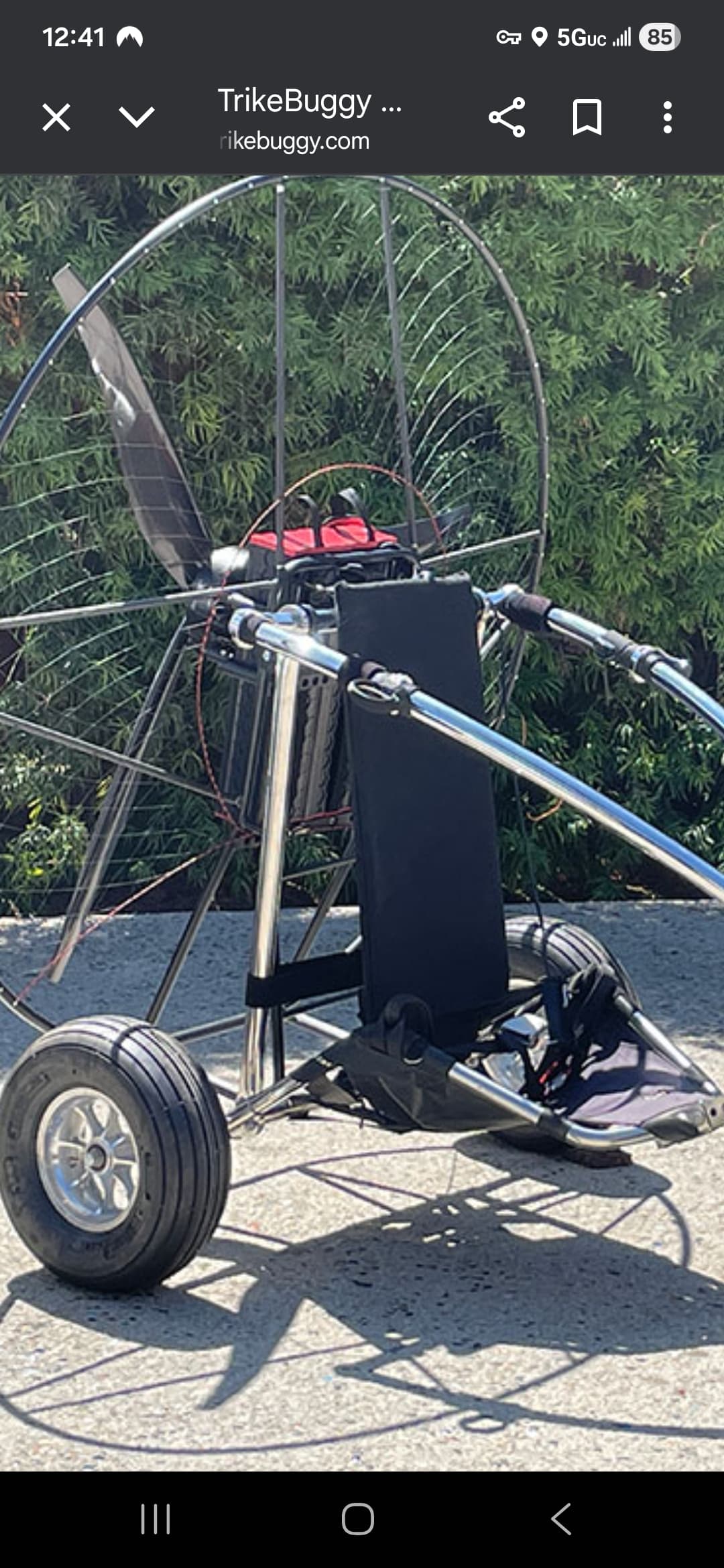

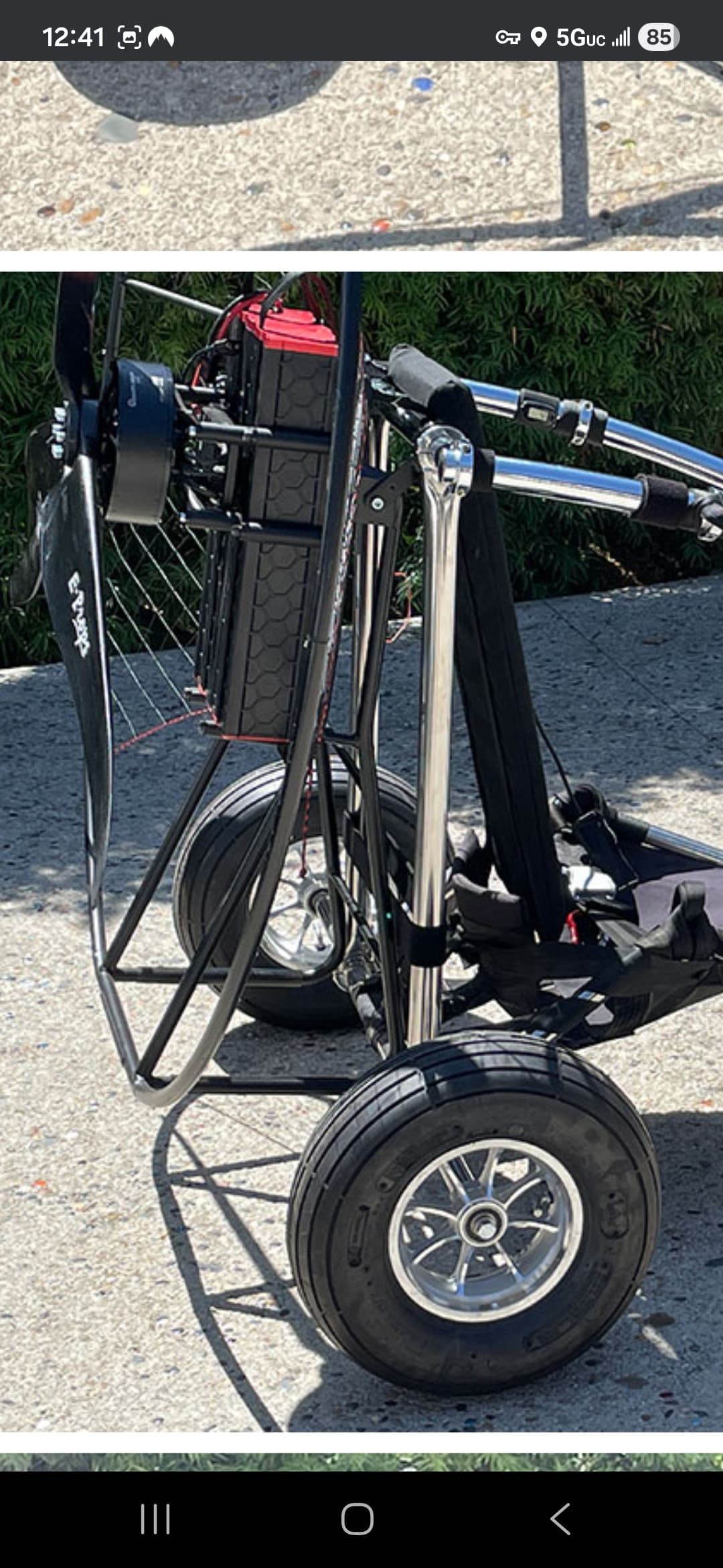

Looking at various trikes I think the best I could find that works with the electric SP140 v2.5 is the Buggy Bullet 3.2. from California but it weights 68 lbs. I wonder if it needs a stiffening bar or a tensioned wire to prevent the cage bending. Looking for trikes I like the Fly Products but except the Foxy that has no protection, the trikes are very heavy and they don’t know if the Open PPG can fit they say the following: ”We have not personally mounted the Open PPG to any of the Fly Products line of trikes so unsure of if this would work. The biggest concern is the flexibility of the hoop and inflation of the glider being too rough on the hoop and flexing back into the props. The better option would be to find a fabricator or contact Neil Wight https://www.wightaero.com to see if he can make a custom bracket to mount your motor to the mini frame on the Vertigo Trike and use its complete trike build. They also worry as I wrote above about the cage bending. Anyone any idea?

I was not willing to wait for one to the invented here so I ended up with the trike buggy 3.2. I guess I can upgrade later if one comes along especially for the SP140. Just got it a few days ago but it does have an optional pair of bars that fill keep the clients away from the cage on inflation. Also has an optional foot steering. I really don’t like that I have to take off the harness and
the j bars to mount it but that shouldn’t take that long. Lots of pluses, low center of gravity, cage for protection, ball bearing wheels about the right size.
Yes the trike Buggy 3.2 is my option too if Paul is not coming out with a trike for the SP 140. I think the buggy is sturdy but a little heavy. Please write your experience with it and tell us if you make any changes or upgrade to the trike. Thanks
