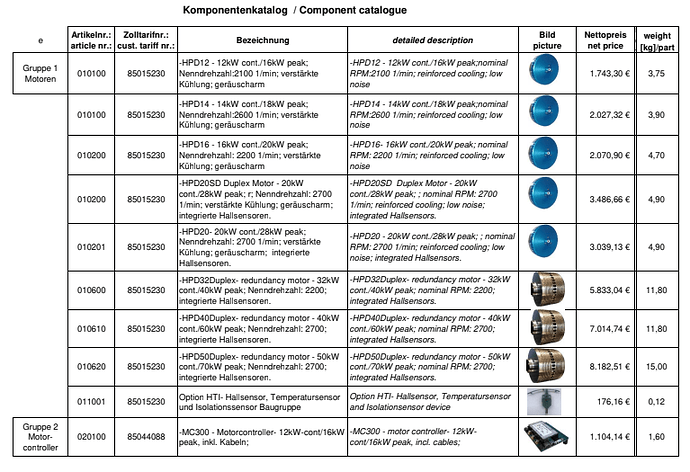

Aerolite 103 now has an E option:
3 bat option (45min) $11,850
So Open PPG system very competitive.

Again - OpenPPG looking much better priced but the optioning for Geiger is very flexible
They have a really nice dual motor option - someday when we are using electric to go over mountains or bodies of water it will be nice to have redundant system.

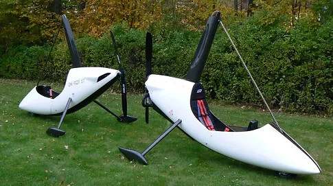

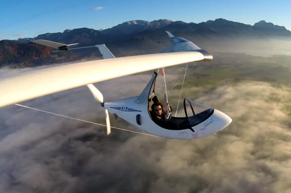

There are some pretty fascinating (hang glider) soaring trikes out there now. A lot of the most interesting ones are mounted to, or developed by, AIR ATOS.
