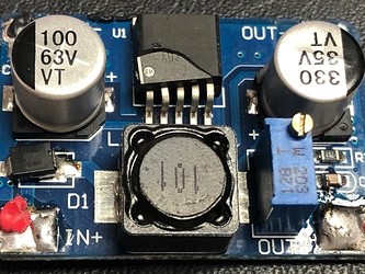

Sometimes I noticed that not all the motors/ESC would initialise properly on start up, and only a full power cycle would clear this. I was investigating why this should be, when the DC-DC converter BEC that you supplied exploded! A piece of burning shrapnel only just missed me!
The DC-DC converter BEC that came with my batch5 is one of the cheap units from china. It uses the NatSemi LM2576HVS buck converter controller. The HVS version is rated to 60V (63V abs max).
This regulator should be bullet proof. There is not much you can do to make it explode like this. (There is nothing wrong with my wiring!)
I am strongly suspecting that this regulator module may have been built using a ‘fake’ regulator device! The standard LM2576 regulator is half the price of the HVS version. There are companies in the far east that re-brand (re-print) the LM2576 as LM2576HVS and can then sell them at twice the price.
The lower voltage devices are rated at up to 45V. So, along comes my freshly charged battery pack at 58V, and it blows up!
In the thread “Carbon Props Experiment” grejen711 talks about the ESCs needing a re-boot. This was the sort of issue that I was investigating when the BEC exploded. From the experiences of others on YouTube who have encountered fake regulators, the LM2576 can go into all sorts of weird modes before failing.
So, I must recommend a recall of these BEC regulators. Or at the very least, anyone with one of these BEC regulators should run it at close to 60V for an hour or so (with nothing connected to the output) and see if it goes bang.
I have replaced the LM2576 with a genuine LM2576HVS and the BEC now works and the main controller lights up. But it seems to have taken out my throttle controller!
