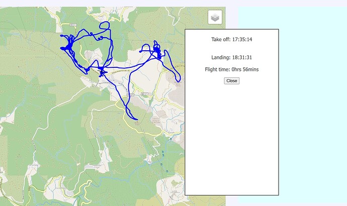

My homemade Eppg
Woww! Niiicee! Glad for you! Now you can just enjoy because you have a great airtime. :clap::partying_face::ok_hand:
Can you tell me what was the voltage at the end of the flight without load?
Are these batteries available to purchase in the US? I can’t find anything online about them.
Hi, following the recommendations of maniaX, 84V
