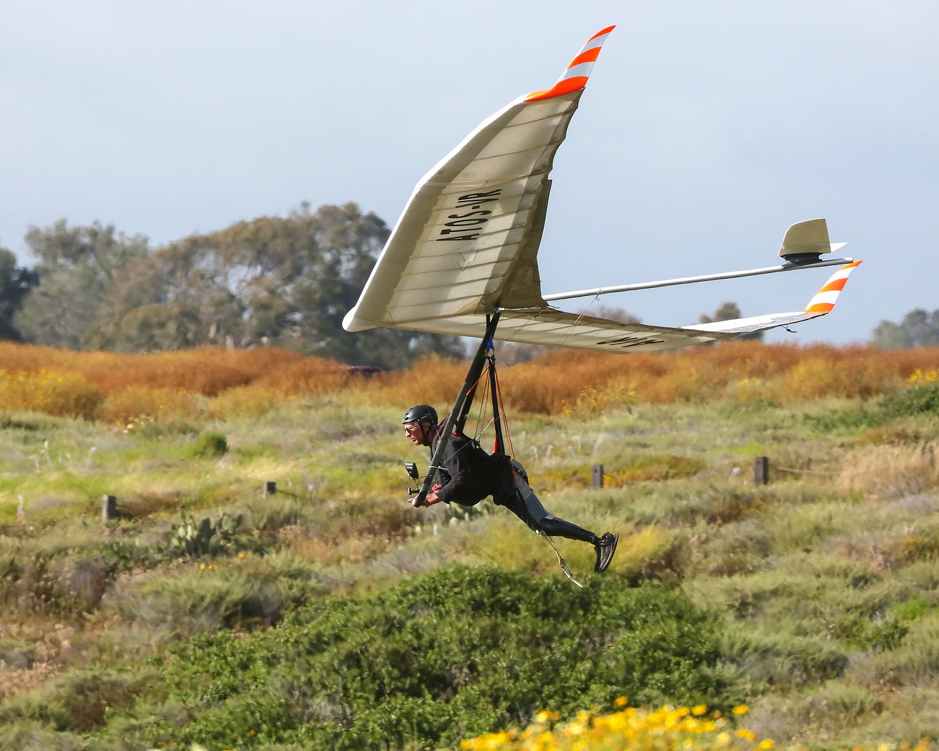

The glider I want to power is a 15m , (49.2-ft ) span Atos VRX that gets a (19 : 1 ) L/D
and I believe the newest E-Paramotor SP140 V2.5 , will be perfect for my project !!!

This is Great information as my Atos can fly at 22mph with reduced control ; but gets its best L/D at 32. If your propeller pitch speed is 50mph , then I only need another 13mph of pitch to, stay within the legal 55kt for ultralights.
