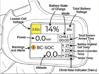

How to update your V2.5 hand controller and display overview
Here is an overview of the V2.5 hand controller display and how to update. We also updated the user manual to show this info in more detail.
