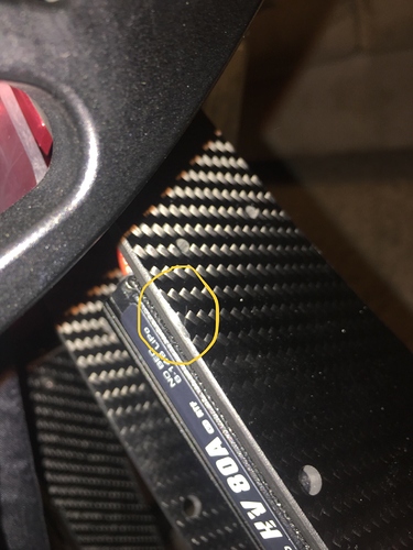

The carbon has really sharp edges which I rounded over with sandpaper. I did this mainly to protect the netting from damage but a rounded edge won’t get damaged as easy by the gooseneck bar.
After well over 100 flights here is a picture of the very, very, very small amount of damage on the arm from the gooseneck bar.
The only way to even see that tiny mark is to lift the bar up out of the way which is what I did for the picture. If this is concerning to you then you could sand it smooth every 100 flights but it’s never been a concern to me since it’s so small.
