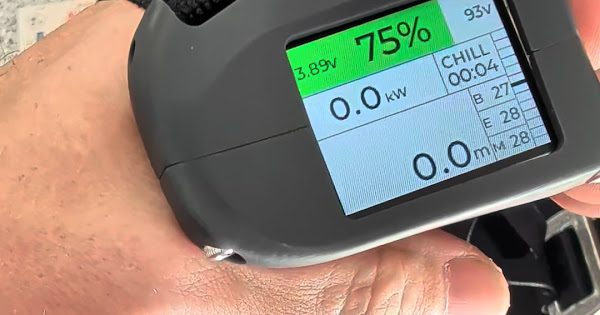

I just received my brand new SP140 power system.
When I power on my system, the Altitude readout reads “0.0m”.
After arming my system via the tap-hold combo, the ‘altitude’ readout switches to “Err”.
When I then disarm the system, it goes back to '“0.0m”

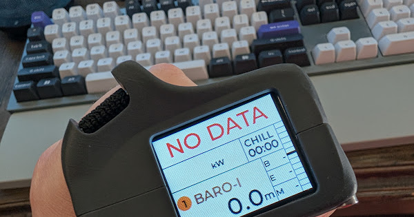

Found the 7.3 RC1 firmware, and noticed that @Pdwhite mentioned Baro init/warnings/errors.
Installed.
Upon booting, the controller now shows a yellow “1” in a circle, followed by BARO-I.
The changelog/source code seems to indicate this refers to a failure of the BARO sensor to Initialize.
Here is the relevant portions of the log:

[15:09:05][3902] [WARN_HIGH] Baro_Init_Failure = OFF
[15:09:06][Alert] Sending UI update: crit=0 warn=1 critActive=0
Picture:
Google Photos
Looks like the barometer IC not working correctly. It’s not needed to fly or for anything critical like that but it’s covered under warranty if you want to get it swapped out.
Please send an email in and we can get you sorted.
