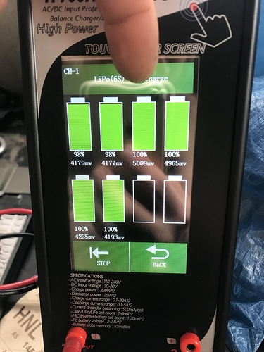

Ok here’s what happened. One of my solder joints was bad and caused me to be running off of one of the pairs of batteries so I was only using 2 batteries. I checked the batteries and the charger says, “battery disconnect” the charger also shows one of the cells going to 0V then back up to 5000mv and nearby cells are at 5000mv
In my wiring. One of the brass bolts on the pass through connectors came unsoldered. This cause the system to run on 2 batteries. And after I fixed that I ran it on 4 I went to a higher power this time before failure.
I don’t know what’s going on. My smart charger reads 5s and reads “error battery disconnect” same as when I don’t plug in the main terminals. Then if I quickly start charging and switch to the view of each cell one cell becomes 0v and then jumps up to 5v as well as a cell or 2 next to it that read 5v the entire time. What could this be?
