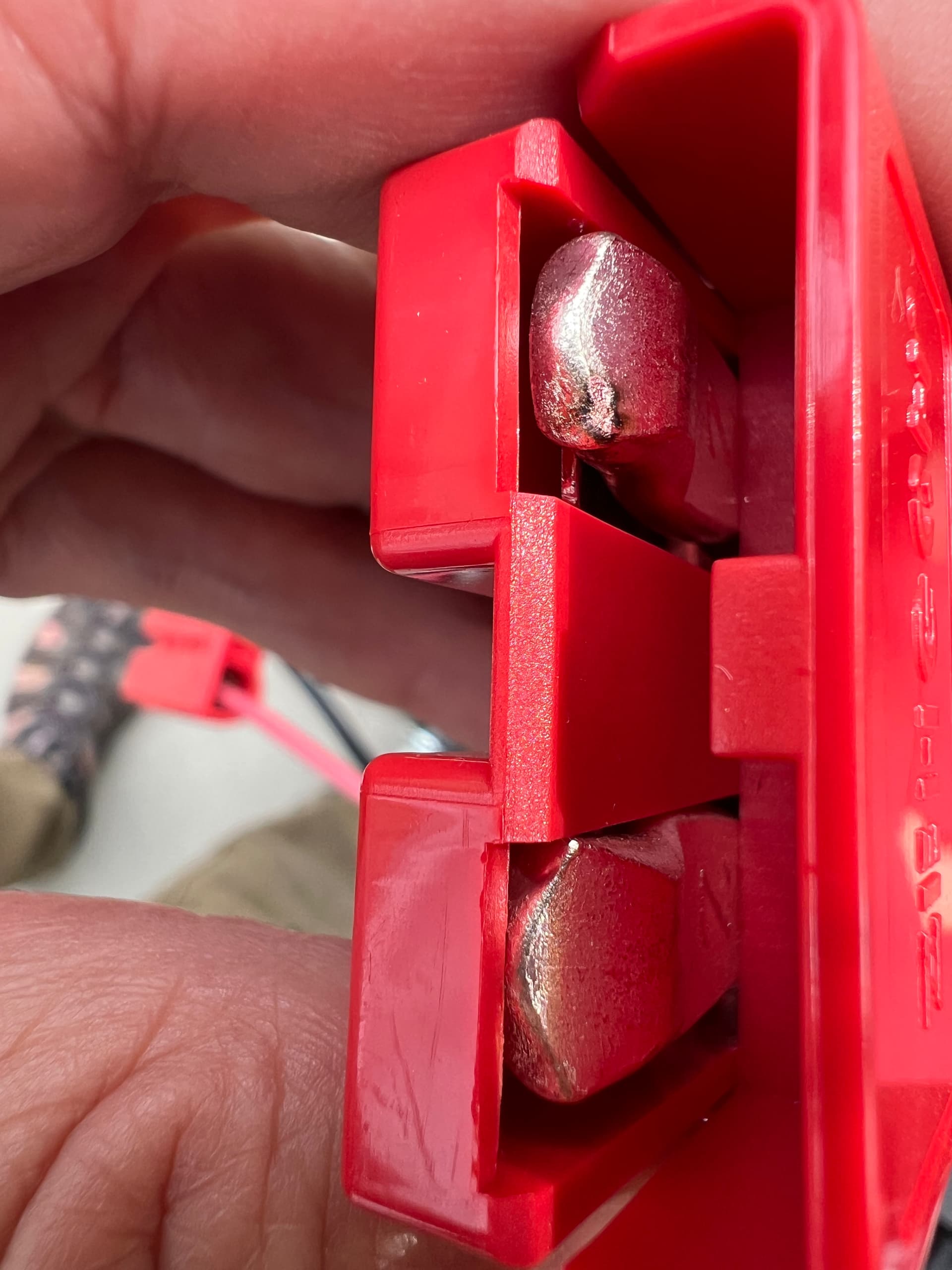

I am getting an arc (sound and visual indication) on the positive connector when connecting the battery to the motor.
This is an early version of the SP140 and initially I don’t recall it doing this. The last time I flew it, I could not disconnect the battery. Turns out, the positive connector was ‘welded’ together. I have replaced all connectors with those similar to the new v2.5 units, but it’s still arcing.

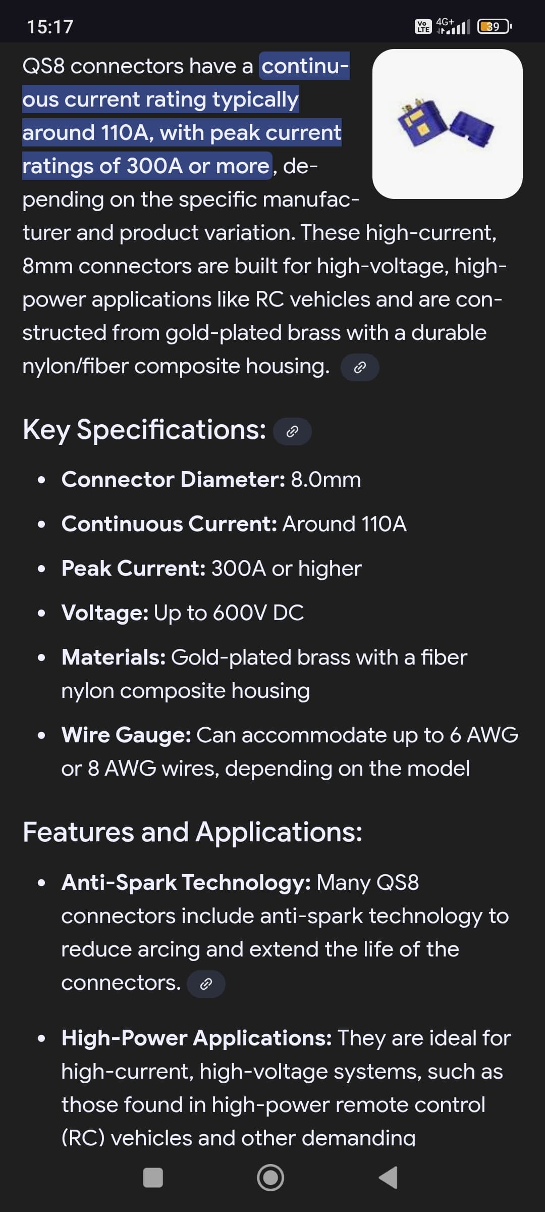

If you don’t have a big power need for level flight like 6+kw than I would go back to the OS8 connectors which I like a lot and they are rated at 110A continous and 300A peak. Although 6-7kw is like 70-80A which it could easely handle by the ratings. The built in 5.3ohm resistor does a good job too.
You can check the resistor with a multimeter, in any antispark connector.
