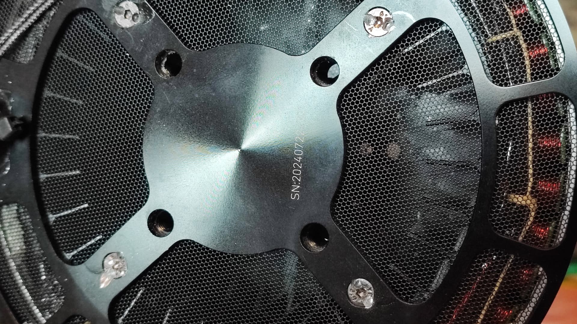

Thanks! I’ve opened it :partying_face: took out both metal meshes and the magnets are fine just had a small metal piece inside. Now on the way to reassemble it but I need to order and replace some small bolts. :+1: Not sure how efective is the centrifugal cooling on a 35kv low rpm motor and why they don’t just use large gaps for cooling as the M50.
Will you remove mesh on top? Maybe without it it is easier to clean magnets with compressed air, or is it a bad idea
I’ve removed both meshes, the front one by riping it off because I didn’t want to heat up those white bolts so close to the magnets, but it came out good. Photo is with the back mesh.
I’ve vacum cleaned the magnets but still some powder like metal there, don’t know if it can harm but will try to find an compressed air at a near by car service.
