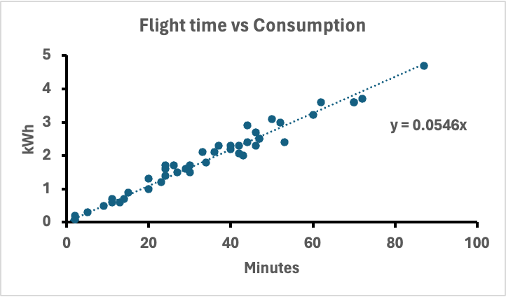

I haven’t been able to try out other wings yet but my average hourly consumption was 3.28kWh across my first 53 flights. On a given flight, it’s anywhere from 2.72kWh to 4.25 kWh.
I fly a V1 Sp140 with the V2.5 4.8kWh battery under a 22.6m Mojo6 with the 2-blade 140cm e-prop, and an all up weight of 105kg which is 5kg over the wing’s rating.
I fly really slowly which i think plays a huge factor in how efficient I am.
Here’s a fun graph from my flight logs:
