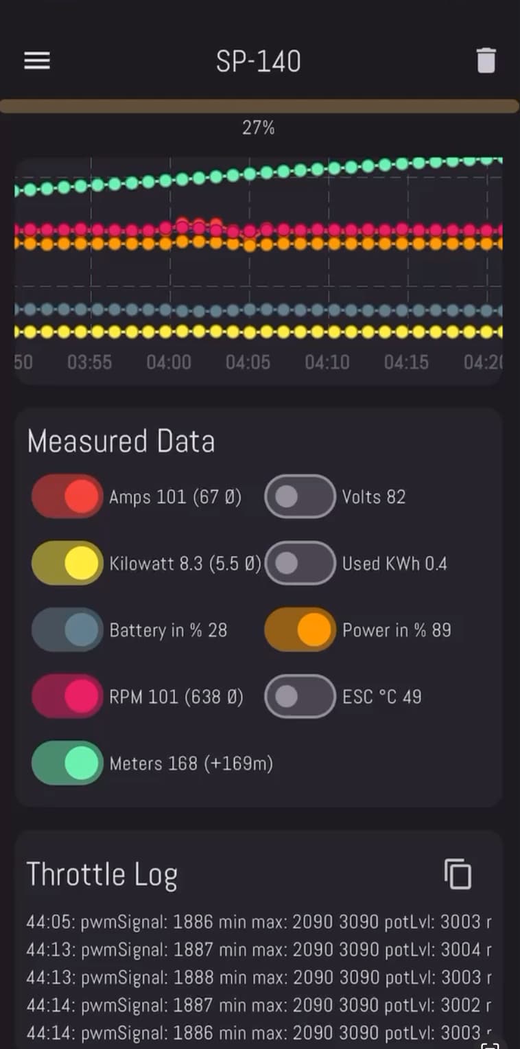

I made this throttle as an alternative. It uses a few cheap components. The screen data is outsourced to a smartphone app via ble.
