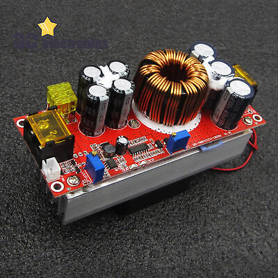

Therefore, I was wondering if it is possible to connect the battery pack directly to a DC-DC step-up converter like this:

Now that the math is cleared up, my simpler question is: is it safe to plug the SP140 battery pack into this DC-DC convertor? Will the BMS be able to intelligently manage the current draw from this DC-DC system?
It seems to be rated for that power continuously, with a huge heatsink to boot.
So basically, if I feed that DC 96V to the battery pack (with the booster’s 15A limitation being applied), the BMS will know that it is safe to get charging, right? (there is no need for some digital handshake signal being passed through).
I have been using one of these for two years now to charge my SP140 pack off solar.
I run the 36V solar input directly to the boost converter, and I have the setpoint for 100.8V.
I charge at about 3-4amps which is the most the Boost converter can handle even though its “rated” at 40A.
The module says 90V, and I’ve noticed the newer ones in fact only go to about 90-65V. But I have a box full of older ones which had no restriction and max out right at 100-102v. The end range of the pot is very sensitive.
