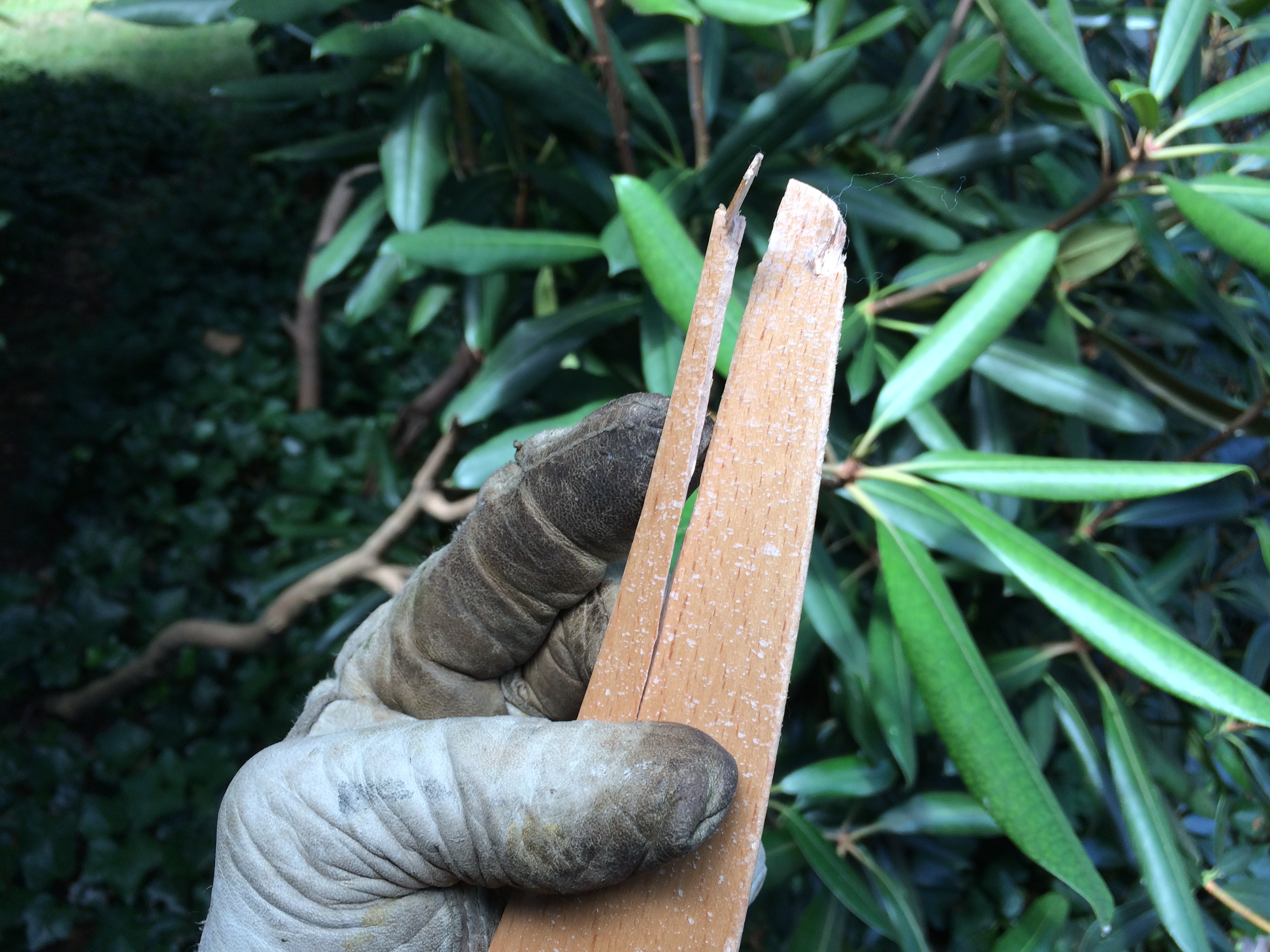

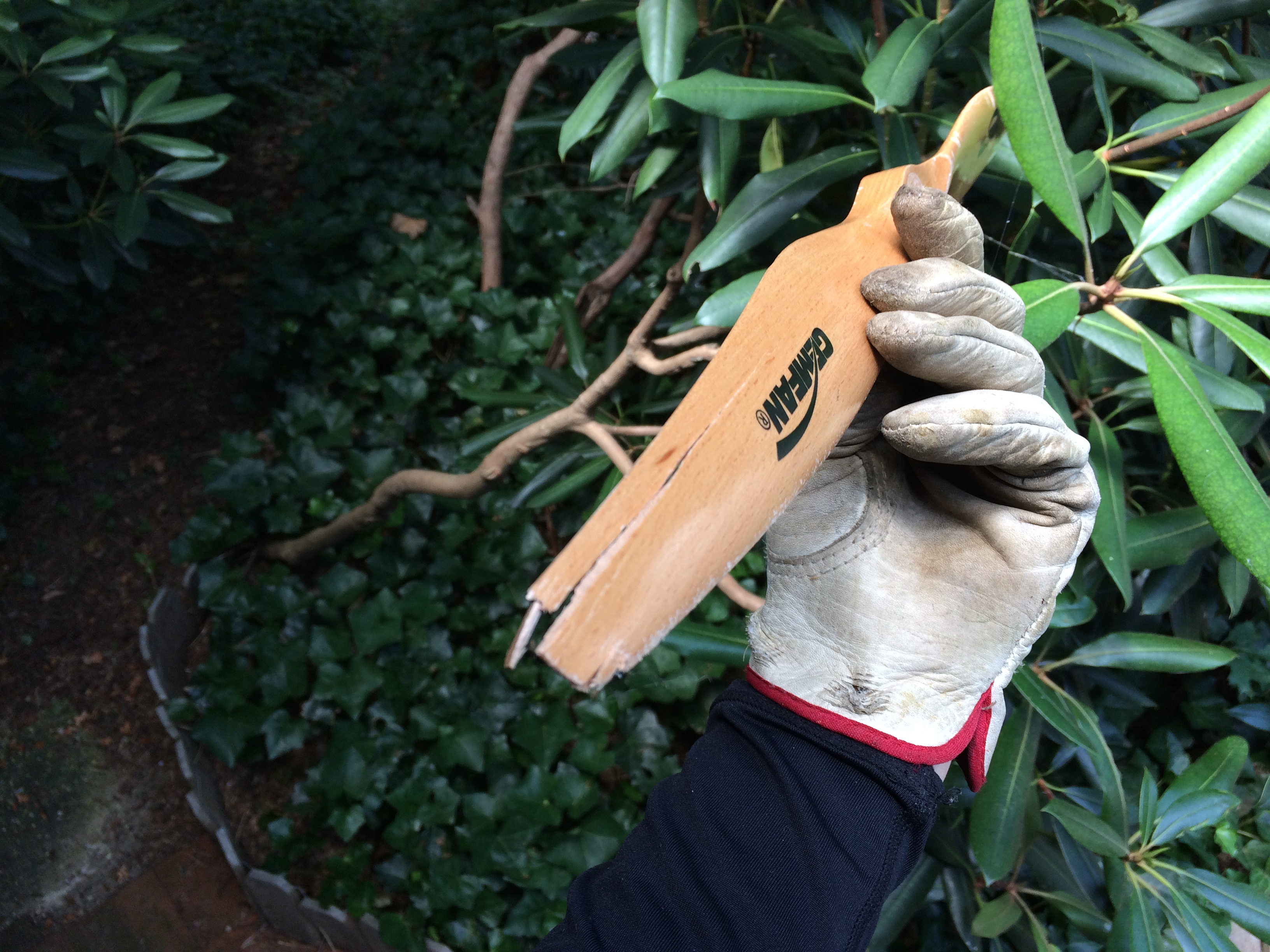

Took a spin yesterday with my machine and while cruising I started hearing a slight noise/note, but there was no performance degradation or red flags. So I kept going. Was flying a small full reflex size wing (20m2) and all went well in spit slightly turbulent air. Only after packing my gear away did I notice one of my blade was badly split and my guess is that the smaller section still attached to the main body began vibrating at full RPM and created the sound I heard. I have to say that I fly at sea level in a sandy environment, and the two bottom props are taking a beating - pitted/sand blasted. I concluded that the lower props must be vacuuming the sand grains and probably a few pebbles hitting the leading edged hard. I do not really care about the way they look as long as they do the job and are still in one piece. I can not change or fix my props after each flight
The dozens of tiny lighter colored marks are made by the
sand hitting the varnish and removing it. I wonder if carbon blades would better take the abuse?
