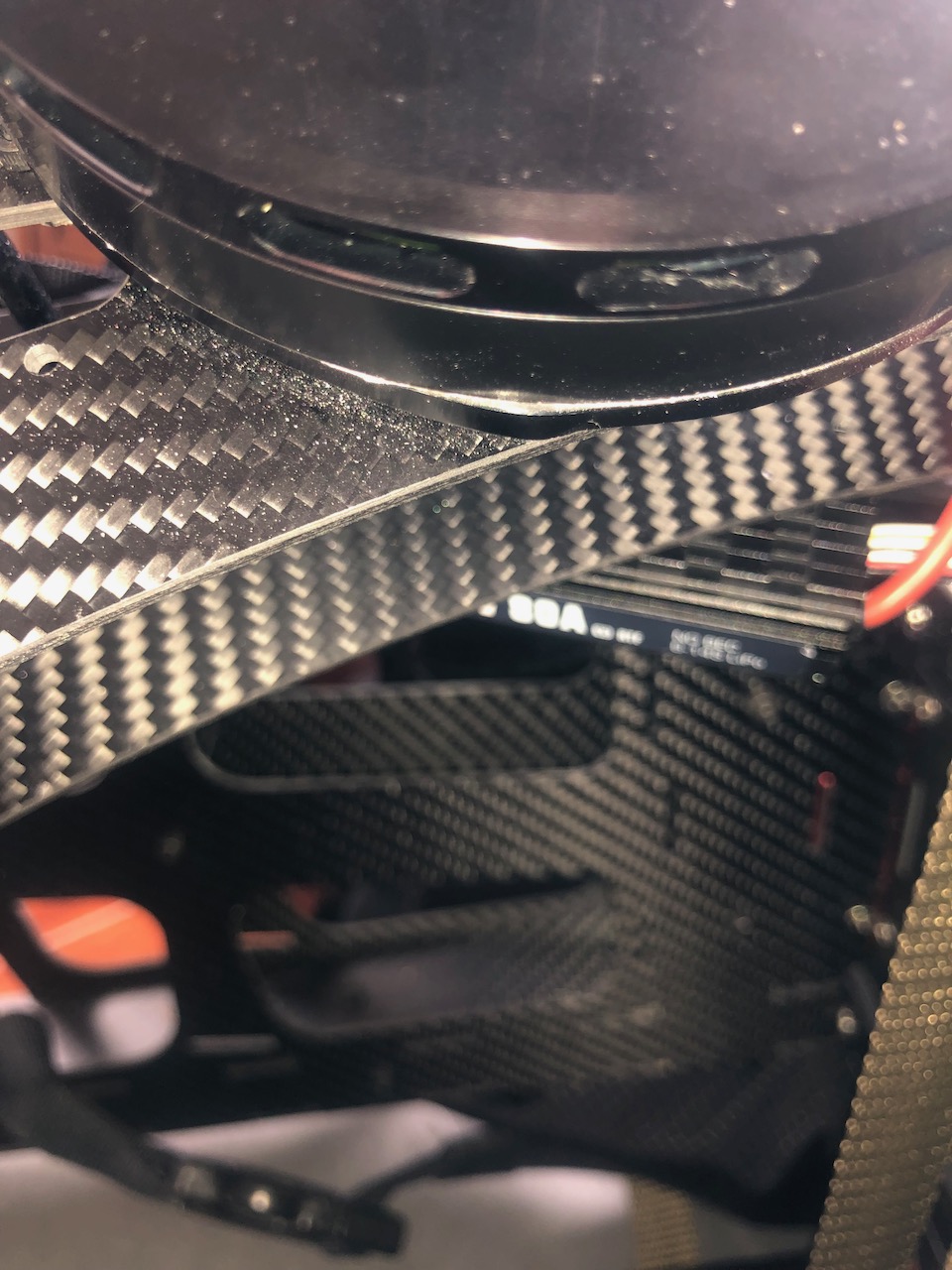

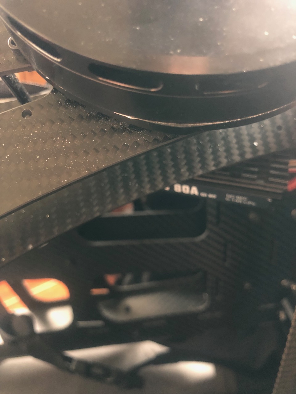

The dent on the motor is only on the part that doesn’t spin so it might be ok but where is it rubbing and what is making the sound. In the video it looks like it is rubbing against the gooseneck bar. If it’s only stiff because of debris you may be able to blow it out with compressed air. Is the outer spinning shell rubbing against the part that is dented? Does it feel balanced when it spins? When you turn it by hand does it “cogg” in even increments? If two of the phases are shorted the increments will not feel right.

not rubbing on gooseneck… optical illusion!

I’ve uploaded 2 photos showing the dent… I am thinking if the outer casing is bulging out in one area then it is probably dented inwards somewhere else and this is where its rubbing… With use, it might become free-er? but I wonder if the tiny iron fillings would be a hazard? otherwise how easy is it to open up the motor? Apart from the grunching sound, it does seem to be “balanced” when spinning and doesn’t seem to be wobbling. It doesn’t “cogg” like the other 3 motors because of the stiffness. Like its constantly rubbing somewhere.
Whatever the sound and stiffness is caused by it will at the very least be also generating heat as well as noise when spinning. Might be flyable but that motor will be drawing more power than the other three. Hope much more?? Is the esc at risk under full load?
It might just be rubbing on the outer shell and if that’s the case you could take it apart and file it. The dust on the arm looks like aluminum dust which supports my theory. I would be more concerned if the magnets were rubbing against the stators though. You can remove the screws and pull the motor apart but the magnetic force is really strong so it’s quite difficult to pull apart. I’ve done that so I know how hard it is. Make sure to pull it straight off because the clearance between the magnets and stators are really tight.

Just tapped the motor with a hammer and its ok now!! it was just catching on the rim. I also prised it off the rim slightly with a blade. It spins freely now when turning by hand……
