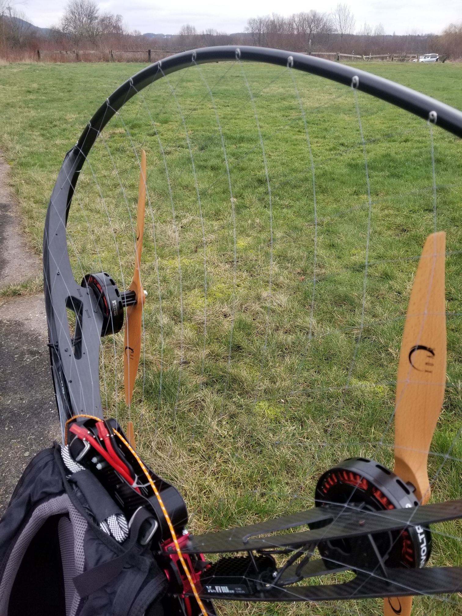

Here’s how I recently rebuild the hoop and the netting. One of the carbon fiber arms broke at the tip on a hard landing, so @GliderPilot was so nice to send me his upgraded 3D printed replacement parts.
The steps involved shortening the arms a bit, which resulted in having to cut the aluminum hoop as well (smaller radius = smaller diameter). When doing that, I did not plan well and cut off a piece on the wrong side, of the aluminum part, which resulted in the rivets holding the net being in the way (I could not slide the aluminum hoop on top of the plastic end anymore).
Since the netting was also worn, I decided to remove the old netting and add a fresh, custom made net as well.
What I can say is that the drag is greatly reduced with this much thinner, yet strong net!

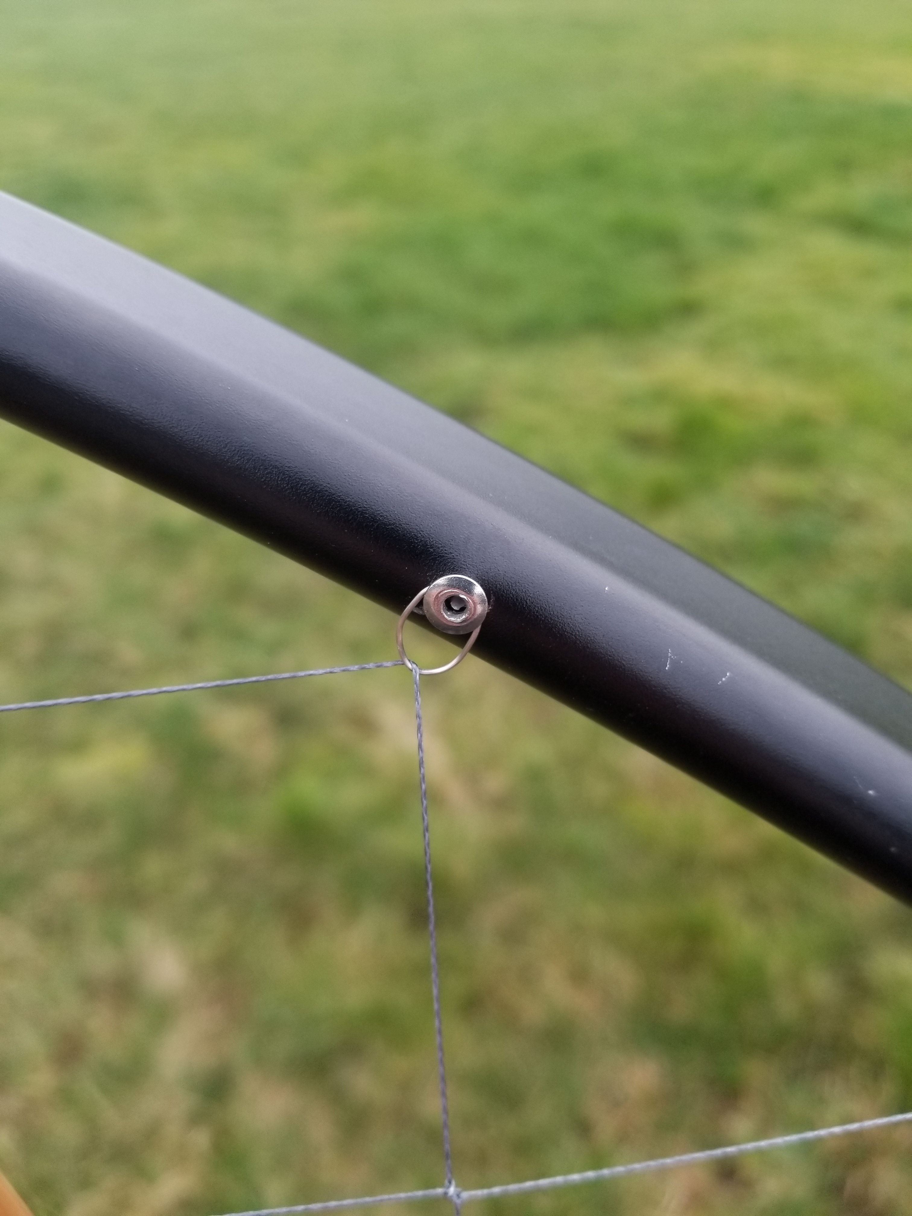

thanks to @bratwurst who gave me some tips on how to best attach the netting I finally decided to first make the net in the exact size that was needed, so that I would not have to cut the net to make it fit. I also used some steel wire to not having to squeeze the net’s line with the rivets, but to use steel wire loops:

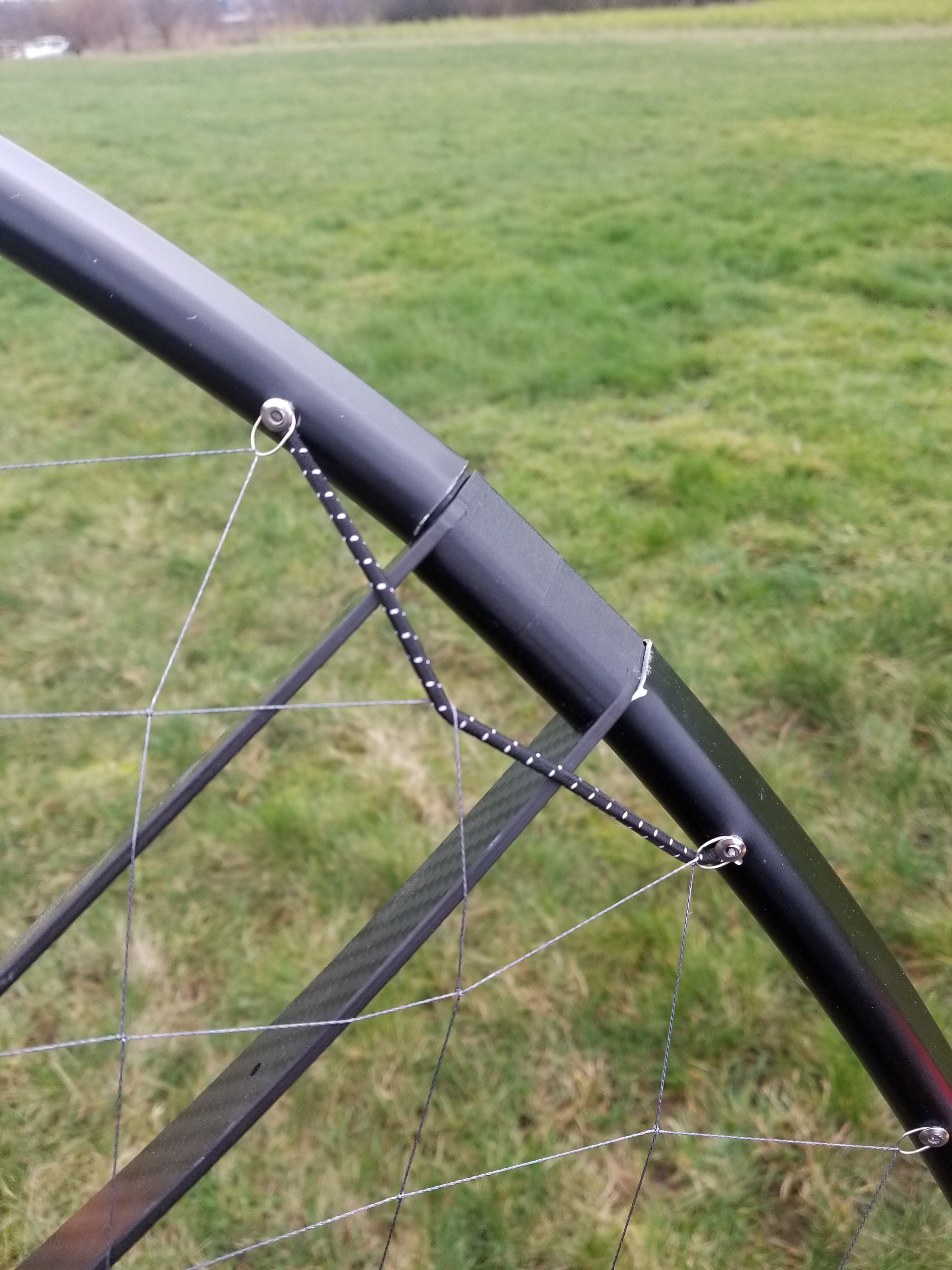

I also improved how the net keeps the individual aluminum hoop pieces together, when they are not attached to the frame. These elastic strings also help to keep the net in shape when the frame is put together:
I am pretty happy with the result.
