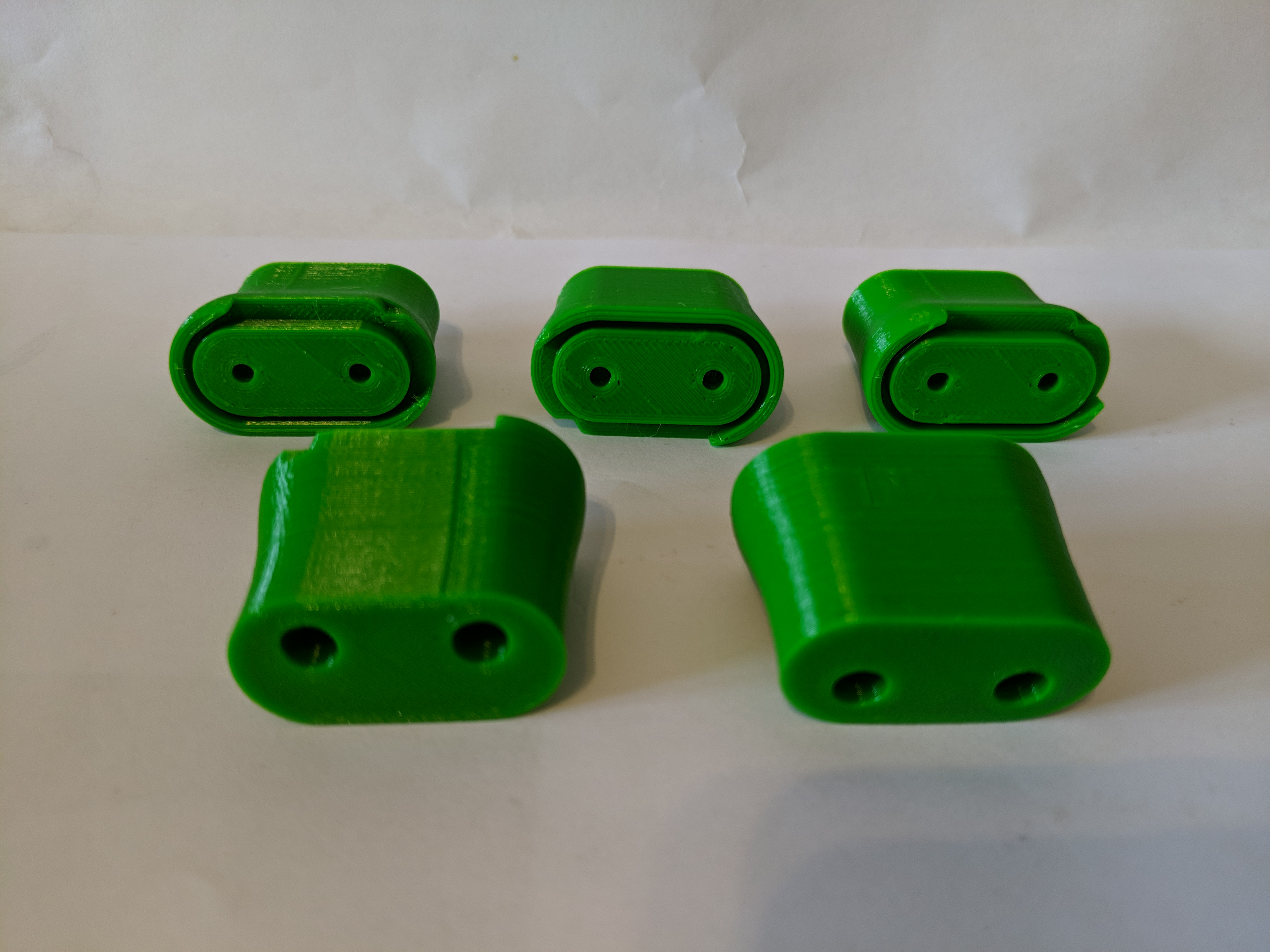

Got them printed in green from 3dhub!
nice
