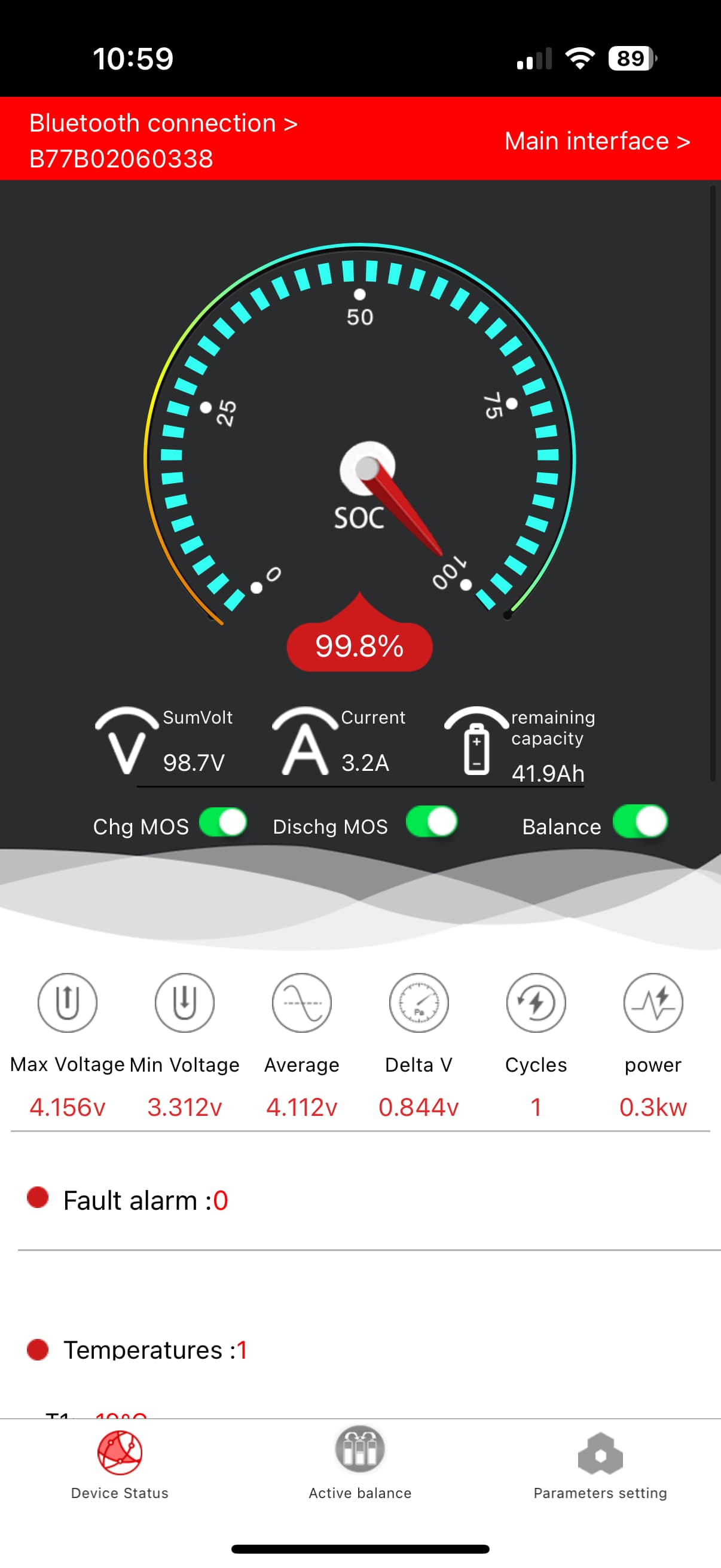

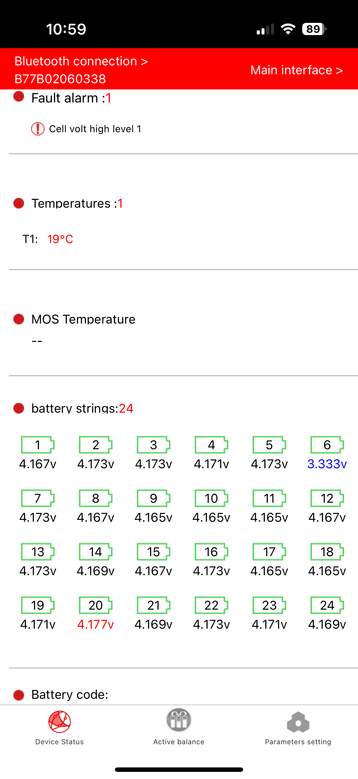

Hey Dennis, I have a similar problem as the video described with one bad series that is significantly lower than the rest. Would you be open to fixing this for me? I’d pay

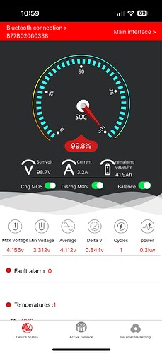

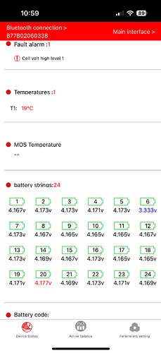

The battery is from Febuary 2023 but has never been flown and only has 1 charge cycle on it according to the BMS. I have attached two screenshots showing all the charges on the strings and the Delta v

You better charge up group 6 quite fast, otherwise it can soon go below 3V and after that it will self discharge even faster! If you are somewhat handy, you can do it yourself quite easy. You just need a rc charger or adjustable power supply that can do 4,2V.

So what you will need is a multimeter to find the group. For this you need to open up the top case, remove the first ribbon cable, one with the black wire and measure each two wires starting from the black one. Black to first red should read 4,1V and fifth and sixth red wire should give you 3,3V.
This is where you connect your power supply or R/C charger. And you will need to charge to same voltage as the rest of the cells so around 4,17V but its ok to charge it fully to 4,2V. Use no more than 3-5A to do so as BMS connector dont really like to handle more than that.
