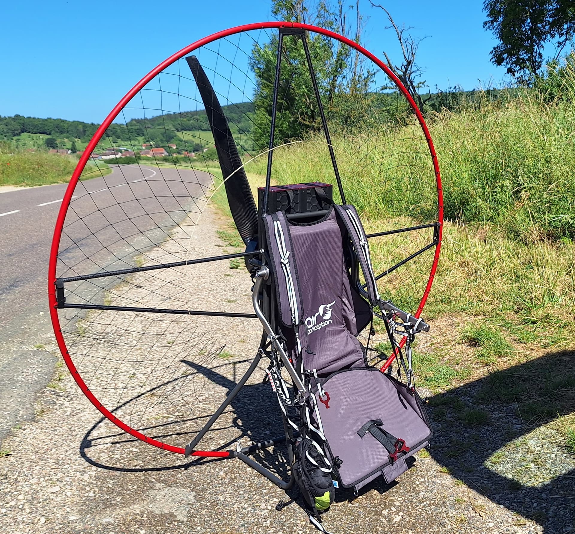

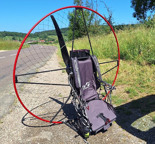

In the past year and half I’ve been flying with different propeller sizes, and here are my findings. For reference I’m 70 kg, and the number below are given for a 40 kg paramotor (4.8 kWh battery) and a Ozone Kona 3 26m2 fully trimmed.
  • 4 blades 125 cm prop from E-props works great. Power is enough for me in chill mode, though a bit low at the end of flight with voltage decreasing. Plus it has the benefit of low vibration. Power consumption varies between 3.5 and 4 kW in cruise. This propeller is my every-day option

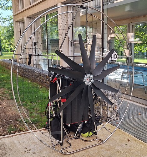

  • 84 cm propeller kinda works (3390 drone prop), but to be able to fly with it I had to use 12 blades and a U15L from T-motor (43 kV, vs 34 kV from the Mad M50). Even with all of that thrust was sluggish (only had enough to stay up, barely climbing) and consumption enormous (7.5 kW ish in cruise). Noise was a lot worse too on the ground (for me it appeared more subtle). On the bright side the vibrations were non existant

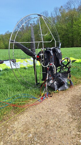

  • 3 to 4 blades 160 cm propeller (based on 6324 drone props). Not that I need that much thrust, but less vibration is enjoyable. I’m a bit worried of the torque in flight though, plus the overheating of the motor (an extra chill mode seems a good start)
